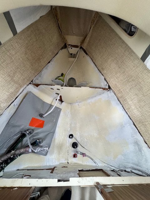

My poop tank was replaced a few years ago, installed the same as before, a bladder, the old one leaked, cleaned everything really well, painted over the wood. And the smell is back, the bladder is under the V berth, the whole boat stinks.
Help, we are it of ideas. Thinking about removing the wood and replacing it!
We still need to really deep clean the wood at the bulkhead leading to the head.
And the wood around the water tank and bladder.

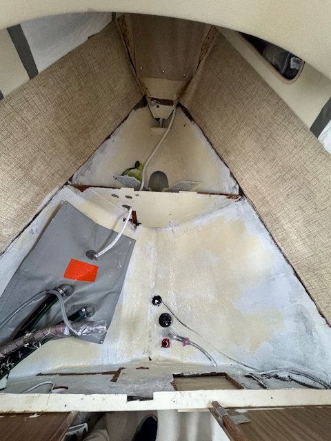

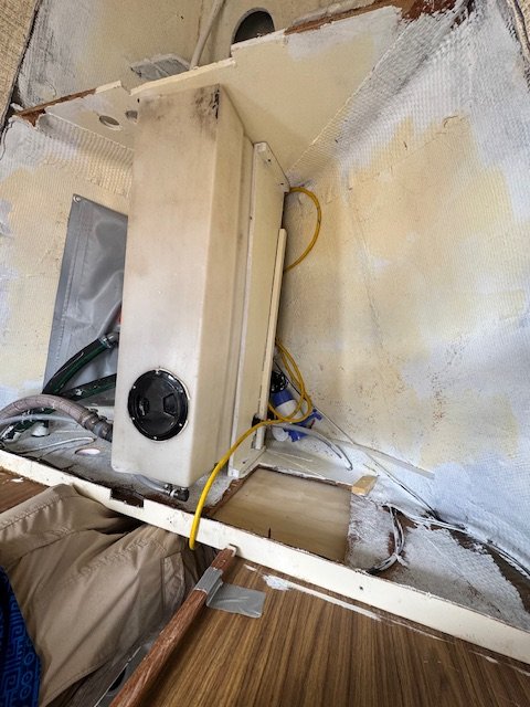

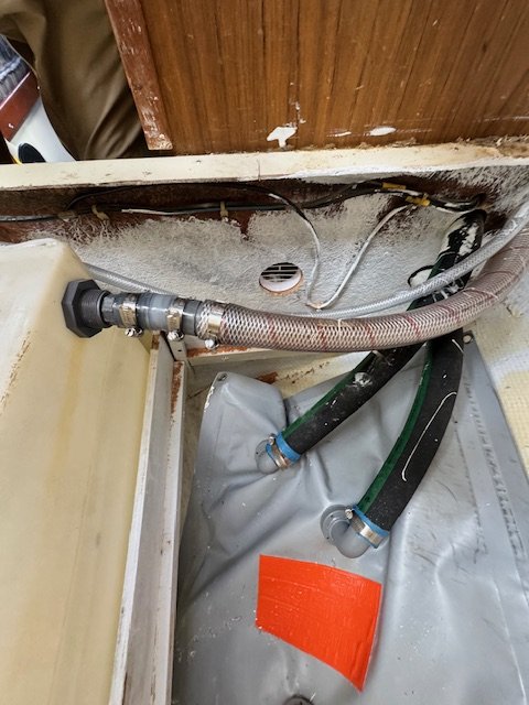

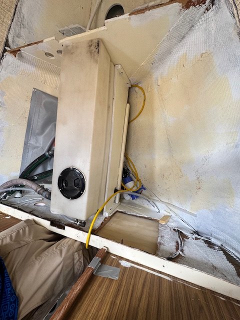

So we did a lot today to try and eliminate the smell
We removed all the wood platform for the V berth mattress. We removed the water tank to have access to the platform holding it, same for the bladder (vetus 14.5 gallons)
Did the sniff test on the sanitation hoses, all good.
Cleaned everything. It is drying at the moment, we took out all the old wood, foam and everything we could.
what should we do next?

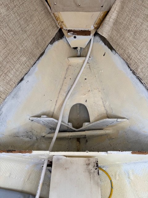

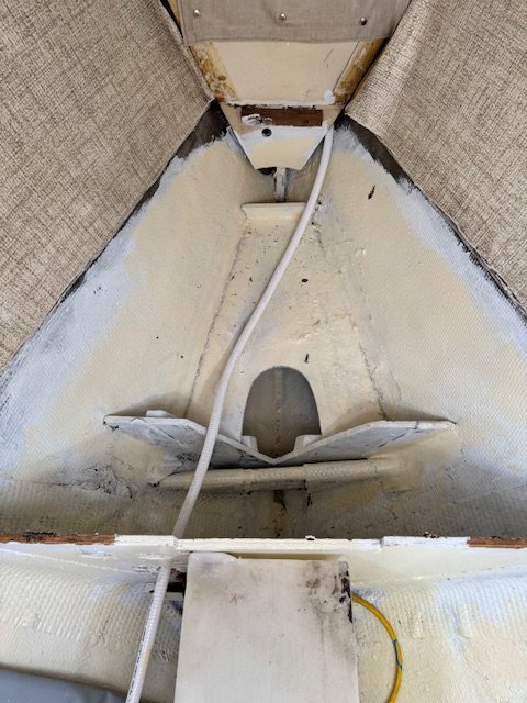

Quick update.
did a thorough cleaning of the stinky area, sprayed with pure ayre, let it dry all afternoon yesterday, this morning we still have the same stink in the pictures above, there is a separator piece of wood, we are wondering if that could be saturated with the smell? And also does it seem to be structural? We are looking for a bigger solid tank, and wonder if we can move this piece or remove it completely? On some pictures you clearly see that there is a smaller thicker piece in front of it that is obliviously structural and is only a few inches ahead of it.
Maybe that would help with removing the smell?
Let me know if you have any other ideas.
At the moment we put a few cartons of baking soda to try and absorb the smell

I havent tried this myself but this might work for you. I've read of others leaving a damp rag on suspect hoses overnight and then smelling the rag in the morning. This could help you find the source of the smell if left on various components. If you try it, let us know if it works
Aug 17, 2013
1,339
Pearson P30 202 Ottawa
We did apply a wet rag on the hoses and no smell after rubbing , we are starting to think it is the bladder (less than 2 years old) that is letting smells through, at the price and the info given, I was expecting something a lot better
