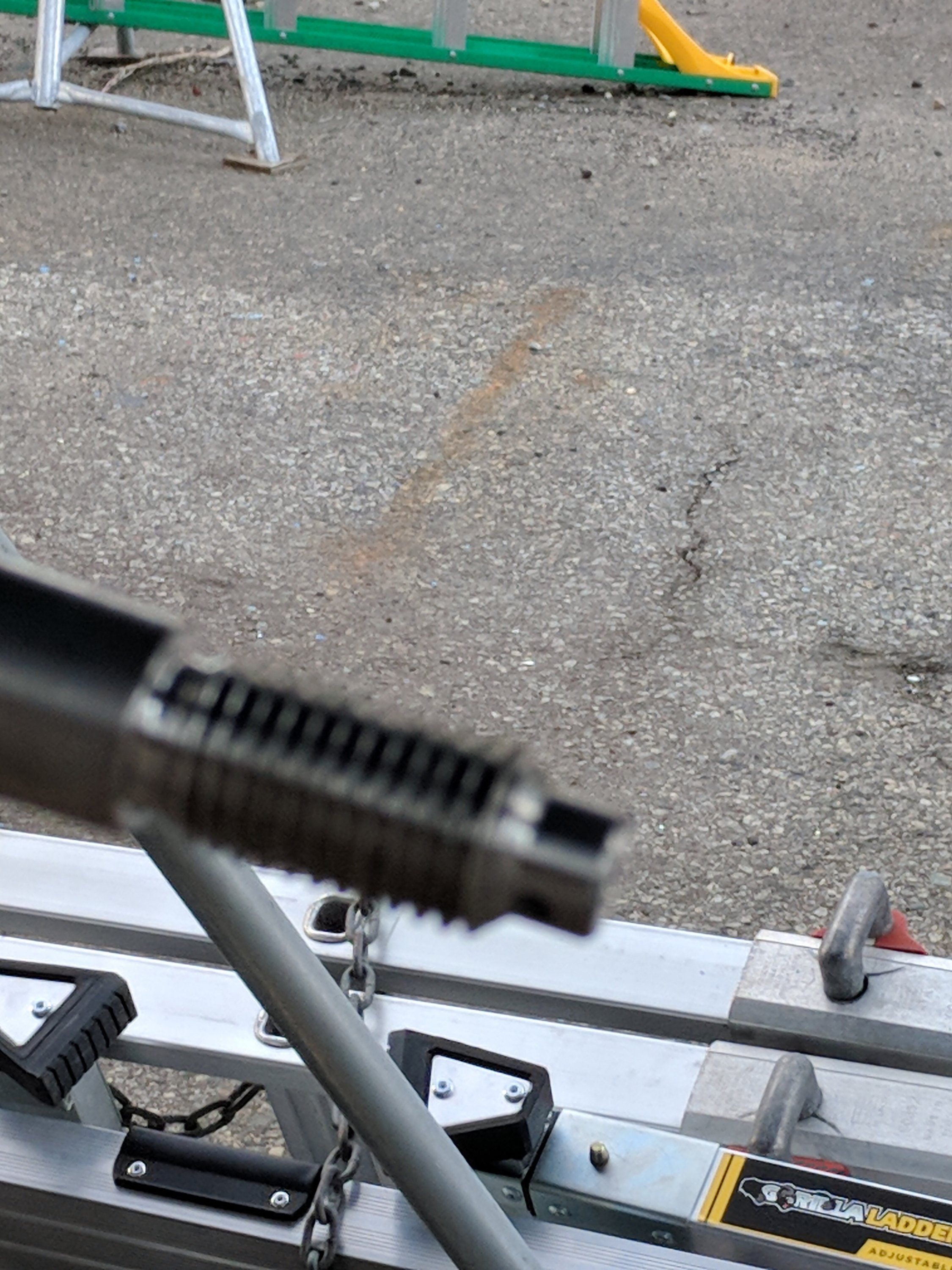

kinda need some quick help....went to install my new Gori today and found the end of the shaft needs to be cut. It’s a 1” Aquamet and the cut does not effect the threads. It’s basically the nub aft of the threads.
I need to this with the shaft installed and in need of some quick advice as I’m supposed to be launched early next week...thanks in advance!

Thanks all! A Porta Band did the trick in about 4 minutes....cuts very slow with no chattering. First experience with Lapping the new prop which didn’t come out like MS tutorial as I did close to 50 turns with more high/low spots than I expected but decided to stop.
