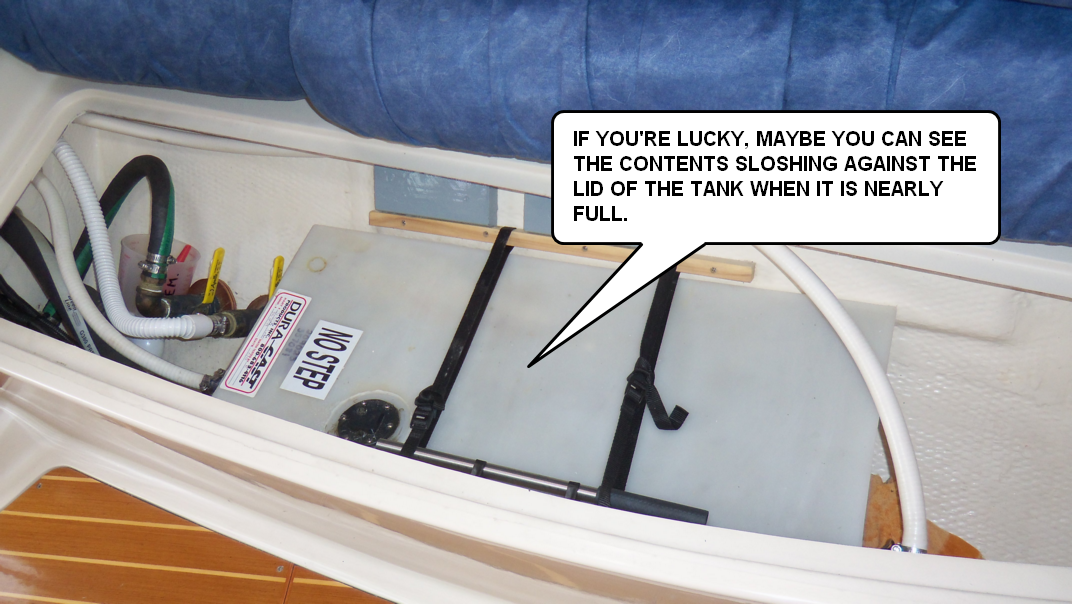

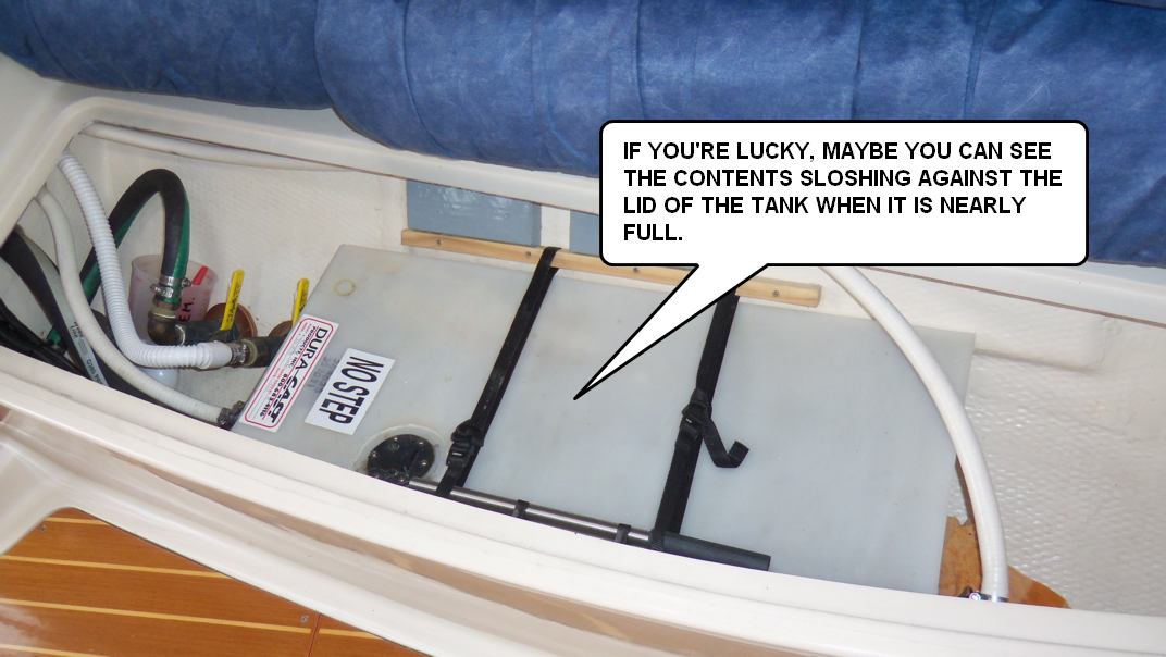

One last MAYBE and I do mean maybe.
With the holding tank known to contain some liquid (maybe 1/4 full), and perhaps in somewhat calmer water, have someone turn on the thu-hull macerator while you're holding your hand over the holding tank vent. See if you can feel a slight vacuum forming after a minute or so.
Be careful and don't implode the tank. If you've got enough bodies, maybe someone can watch the tank top for deformation and sound the alarm if you get a vacuum as well as what you feel.

Poly tank but cant see levels, it is tightly packed in. I could open a cap (Maybe) but risk damaging it, so, I hesitate.
I know what you mean. Mine is openly exposed and it's still a bugger to determine even from brand new. A focused flashlight through the tank top, in the dark, and maybe you can imagine you can see the level sloshing around, if you've had a few drinks. Other than that, hopeless.
Out of curiosity, what is the "cap you could open" to check the level ?
Anyways, I think it's time to invest in an externally mounted level sensor which will eliminate future problems with sensing the tank level.
At this point, I think it worth the wait until you can do some underwater observations for air discharge from the thru-hull and make a little more sense in calmer waters.
Please keep us updated and who knows, some new idea may drop down out of the sky

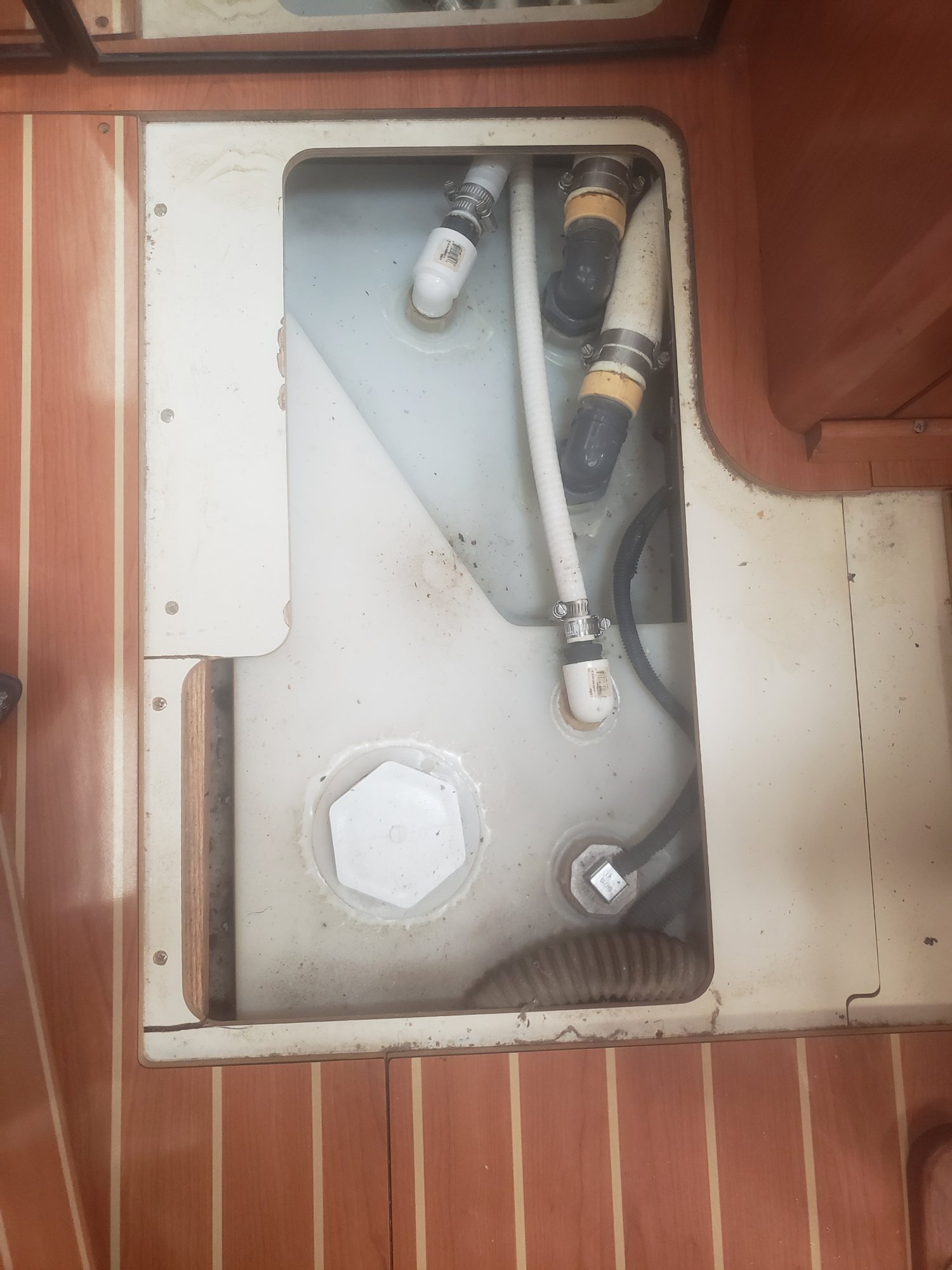

That is beautiful, you can see the sides.
I do have an externally mounted gauge, need to install it, never makes
The cap is a screw open, I assume an inspection cap. It is glued in with something, very tough to open.
no judgement on the picture, I know it needs to be cleaned, its been a year or more.. I usually do it annually, this year we were having too much fun...
Most likely pipe dope for sealing the threads. If it's the same junk Hunter used on my holding tank back in 1998, it eventually turns into a hardened powder which is very difficult to remove on small threaded fittings. A stick of dynamite may be required on larger diameter fittings.
No problems I can see with the cleanliness of the exterior of the holding tank. I've seen pictures of holding tanks on this site which I would venture to say are dirtier on the outside than the inside.
