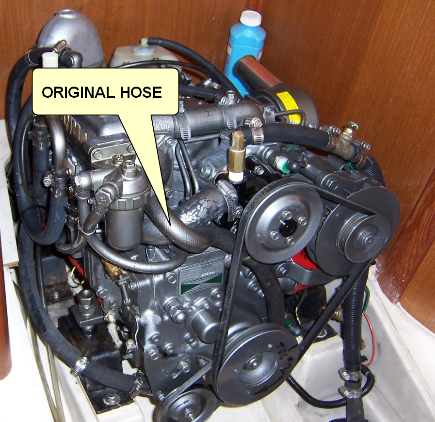

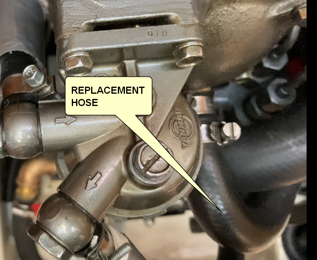

The original hoses on the engine are covered with grey engine paint:
All replacent hoses are all bare black rubber.

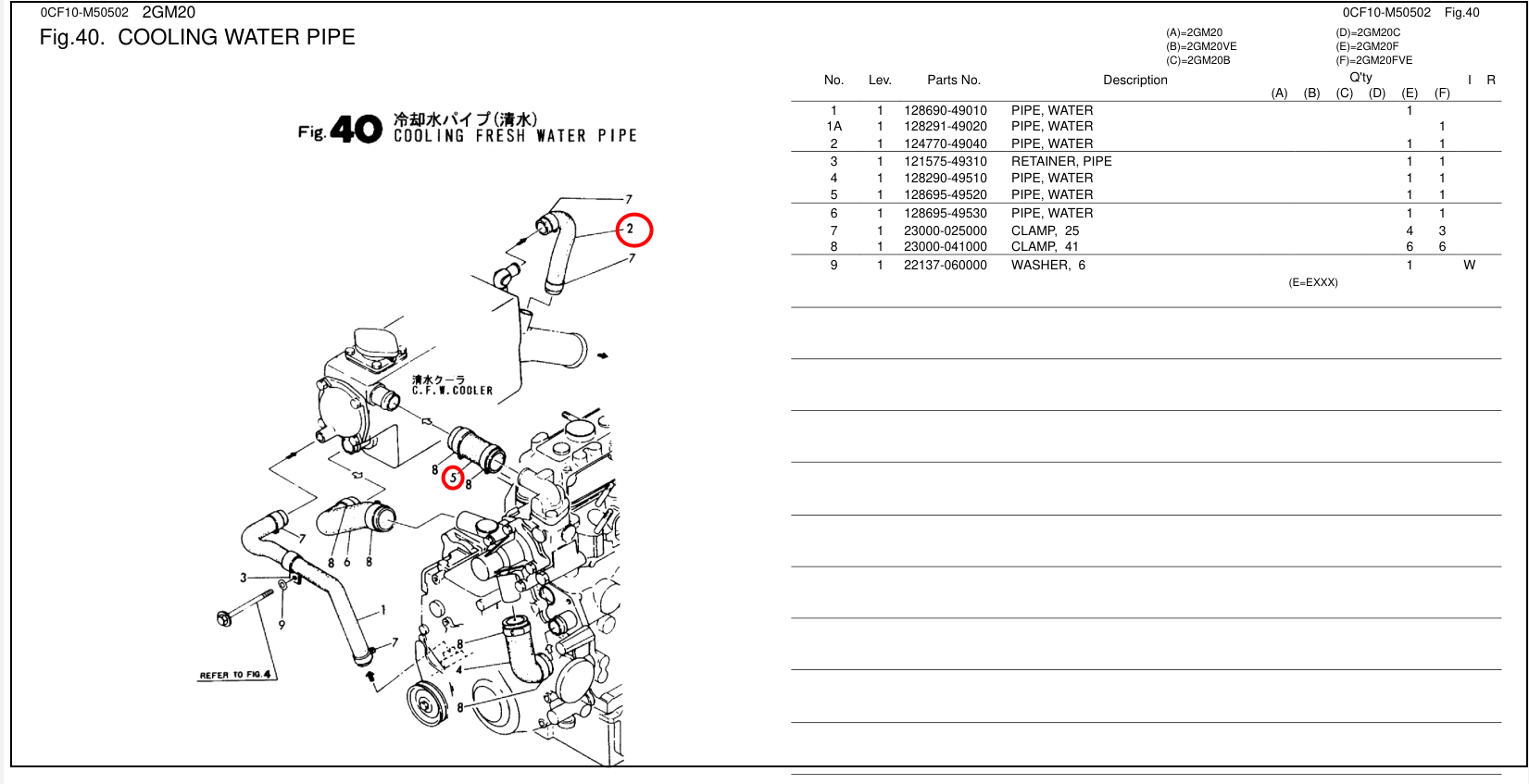

Note that parts #2 and #5 are just straight auto rad hose, #2 is 1/2" ID and #5 I have no idea. Other hoses are custom Yanmar hoses. Everybody still has their own little part number and a price that will knock your socks off.
If the custom preformed hoses are black, they have been replaced and are not original. If the custom preformed hoses are gray, they are original. Either way, the preformed hoses are only available from a Yanmar dealer.

I would like to replace the custom bent hoses with Yanmar hoses. @Ralph Johnstone I finally found a parts diagram of the cooling water hoses so I'll either order all the hoses from Yanmar or the just special ones.

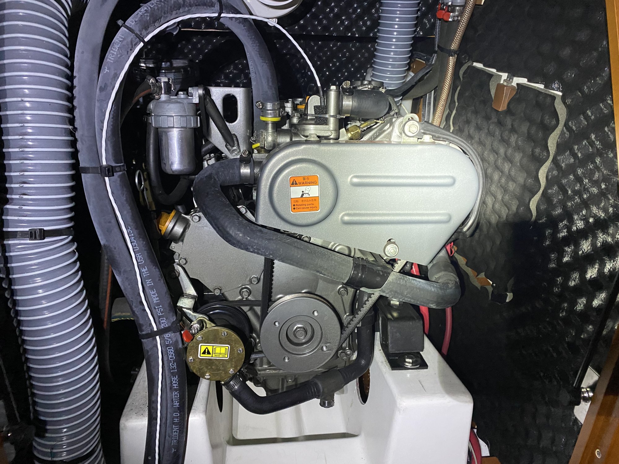

For what it’s worth, this is how our 3YM30 came from the factory. All hoses, including the preformed ones, are just unpainted black rubber.
