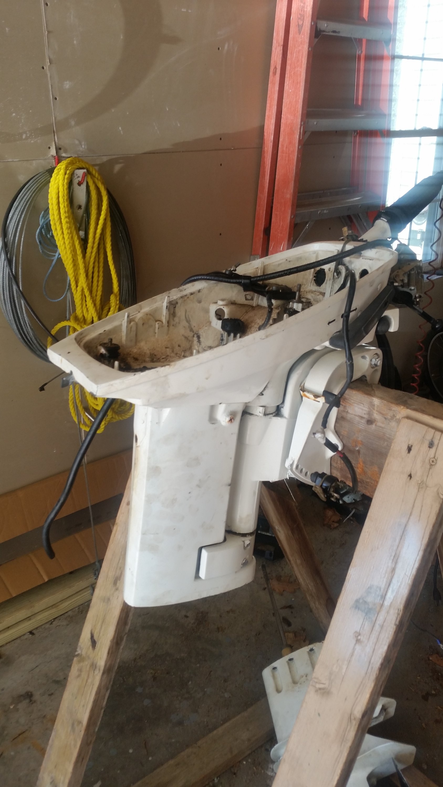

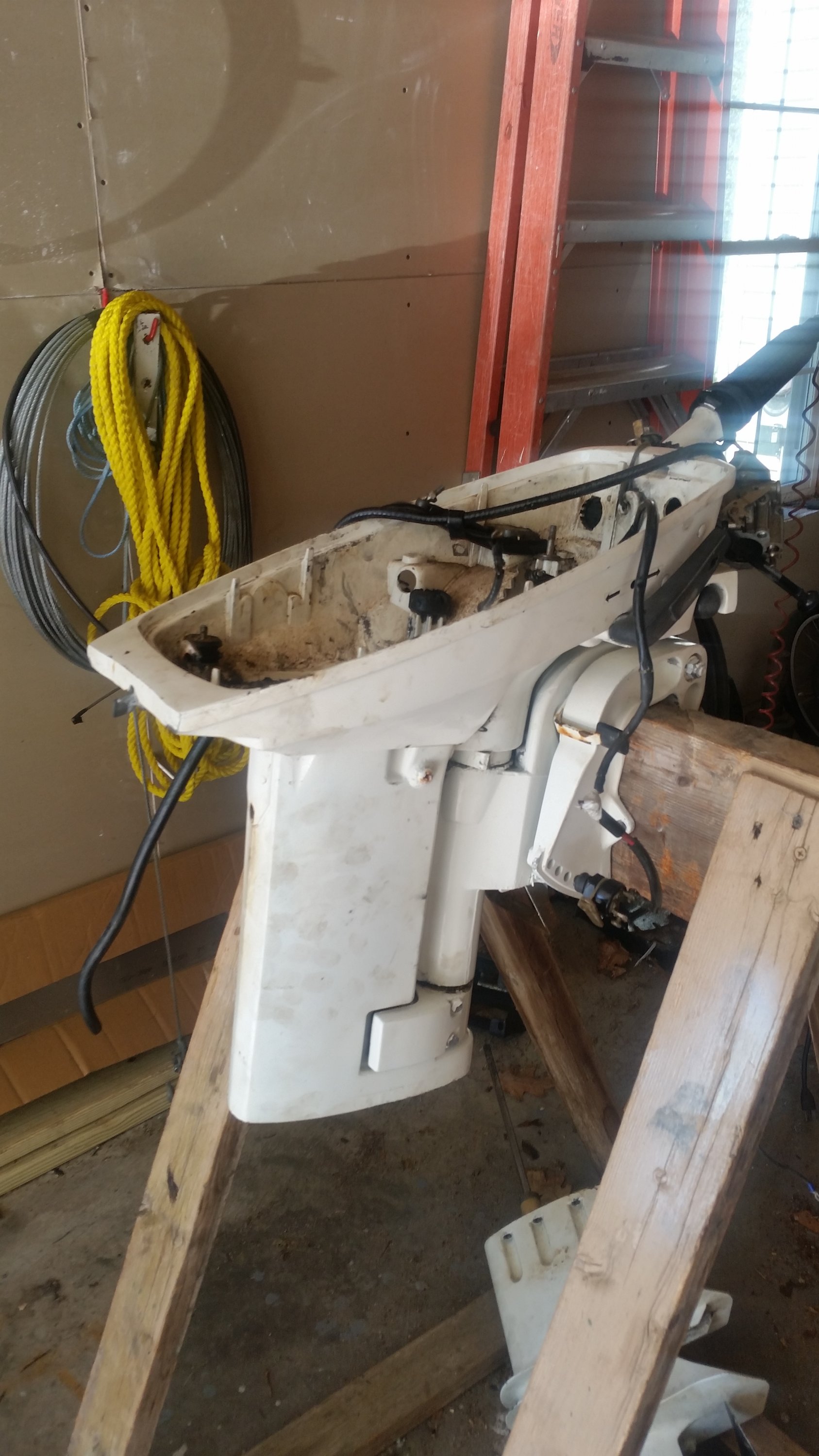

Tried PB Blaster for a week and then a propane torch to heat it I was getting nowhere. I got the rear two studs out after cutting part of the housing but the front two would not budge. I finally decided to amputate by cutting the bolts and the lower unit came off right away. I managed to get the cut off studs out by removing some of the case to expose enough of the studs to allow me to grab them with vice-grips. Now I have to decide if there is enough thread left in the bolt holes to hold new studs or bolts. There is about a half inch of threaded bolt hole left in the aluminum case. I can easily change the impeller now and I think I can get things back together.
short of welding it up and redrilling and tapping, you can install the studs using red loctite... it will help hold the studs more secure, and yet still allow it to come apart with a bit of heat... the next step beyond that is using jb weld or marine tex to glue them in, but that should be reserved as a last ditch effort to get one more life out of the motor....
