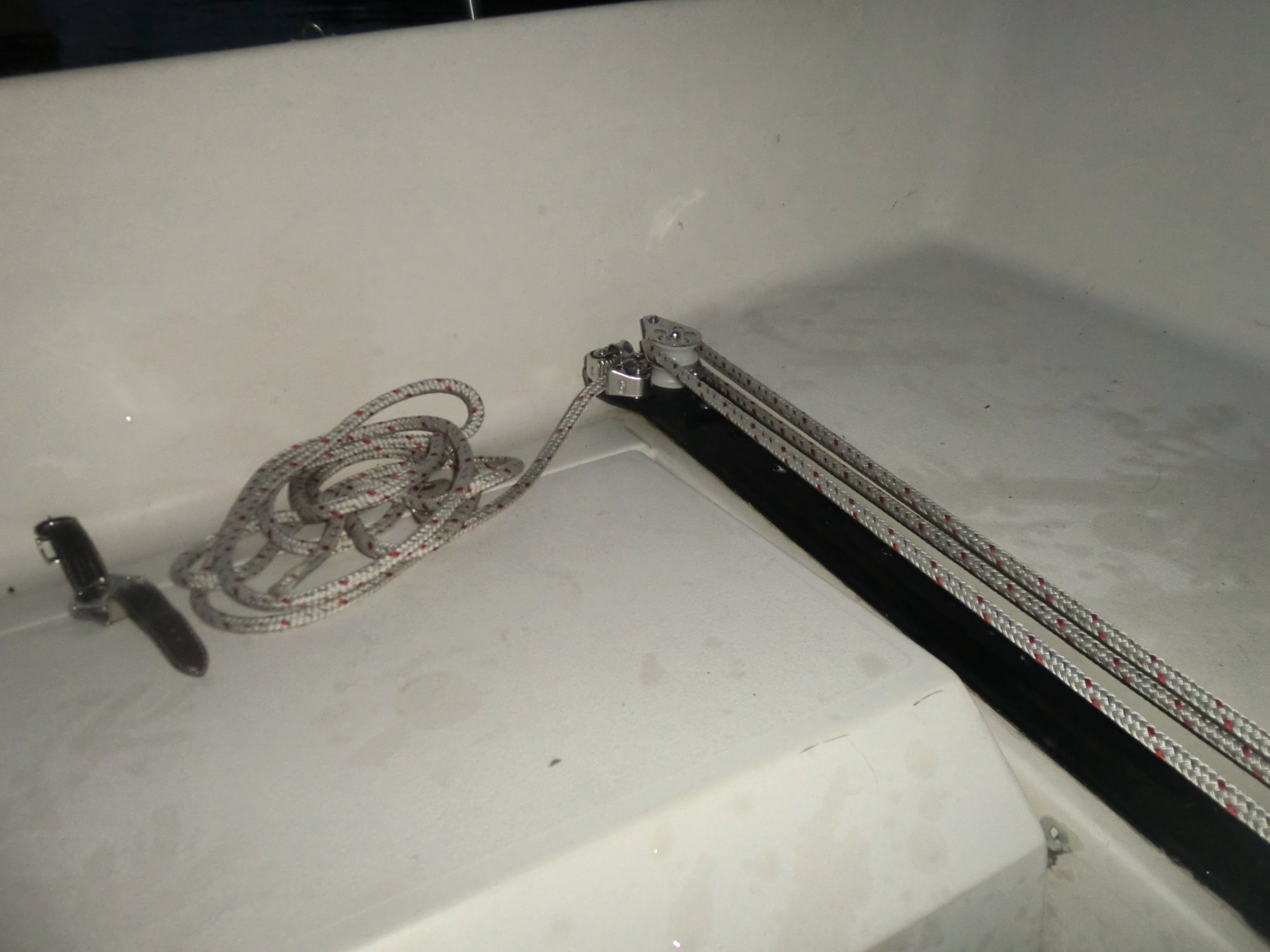

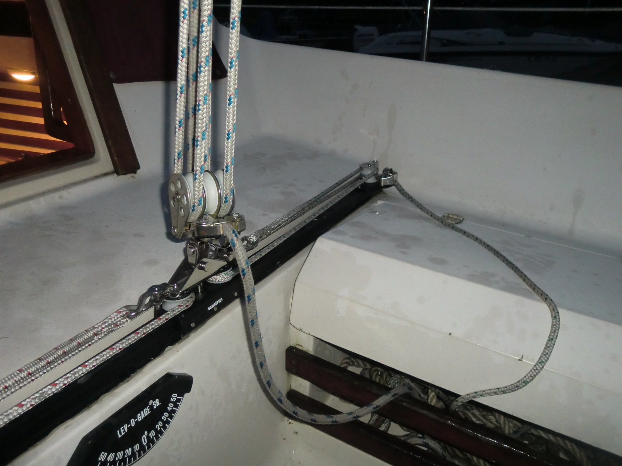

It sounds like you just need to decide if you are going to buy a windward sheeting model or a standard system at 3:1 or 4:1 with end track cleats or remote cleats. I think the standard 3:1 with end track cleats is the simplest, most reasonable solution for that boat. Our 27' boat has a 3:1 system with end track cleats and it seems to be reasonable, but Sue has trouble when the wind is strong. If I was going to replace, I would probably try 4:1. Here is my standard 3:1 Schaefer system on 1-1/8" track that I had to custom fit for the end block/cleats.
One thing I might not like about windward sheeting is that the tail ends of the lines travel with the car. That might be convenient for the guy trimming the traveler, but the lines would always be in the middle of the cockpit and probably always be stepped on. There are trade-offs with every system! I like the cleat at the track ends because the lines run along the backrest, mostly out of the way. It's a nuisance when somebody is sitting on the lines and I want to adjust, but surprisingly, with the cleat at the track, I can easily adjust both lines when perched behind the wheel very easily when I solo sail. It's like holding buggy ropes, one in each hand. I can flick the lines off and cleat them very easily without being near the cleats at all. In fact, it seems to be easier than when you are sitting right behind the cleats. I have thought about using remote cleats, but the set-up alludes me until I can see how it would work best on our boat.

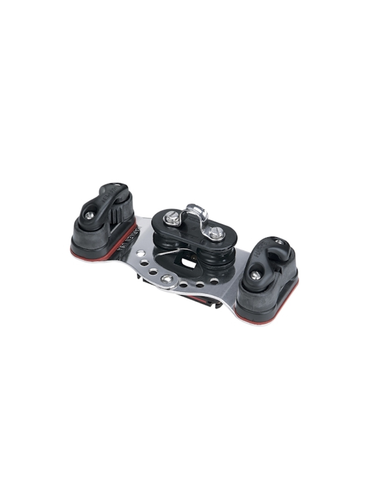

From Windward Sheeting Simplifies Tacking
In light to moderate air, most boats sail upwind best with the traveler car above the centerline. This allows them to position the boom on the centerline without exerting too much mainsheet tension which would close the leech.
With a conventional traveler car, you need to release the leeward control line to bring the car above the centerline. Before tacking, the control line must be recleated and, during or after the tack, the new leeward control has to be released.
A Harken windward sheeting traveler car solves this problem. Windward sheeting cars have the control cleats built into a special mechanism that opens and closes the leeward cleat automatically during a tack.
As you're going upwind, the leeward cleat is open so you can draw the car above the centerline. When you tack, ignore the car — the old leeward cleat closes, the car stays where you left it, and the new leeward cleat opens so you can draw the car above the centerline on the new tack.
In heavy air, when you want the car below the centerline, the windward sheeting car works like any other—just ease the control lines to position the car, and it will move to a reciprocal position on the other tack.
I find it helpful in both light and high winds, especially When I’m tacking in a crowded narrow channel with little time between tacks. During a tack, the traveler stays where it was before the tack, without my having to cleat the old leeward control before the tack. After the tack, i don’t need to to release the new leeward control line to pull the traveler up.
I certainly don’t need a windward sheeting car, but I really like it.
The traveler never slams to the new leeward side during a tack. And therefore I don’t have to pull it very far to get it back to centerline or higher.

Windward sheeting cars were made for racers and to be honest, when you are not sailing and perhaps motoring and the mainsheet is swinging back and forth with the thrusting of the boom in the waves, for example, the action of the windward sheeting car will uncleat and the car will travel back and forth until cleated again. Sort of a pain. So your other Harken choice is a good one in my opinion.
Jun 25, 2004
1,109
Yes it would be a pain but... many folks with windward sheeting cars install cam cleats to stop the car from moving when there isn’t enough wind pressure to lock it in place automatically, such as when motor sailing in very very light wind. With one cam cleat on each end of the traveler, I can operate the traveler in either “auto tacking” mode or manual mode.

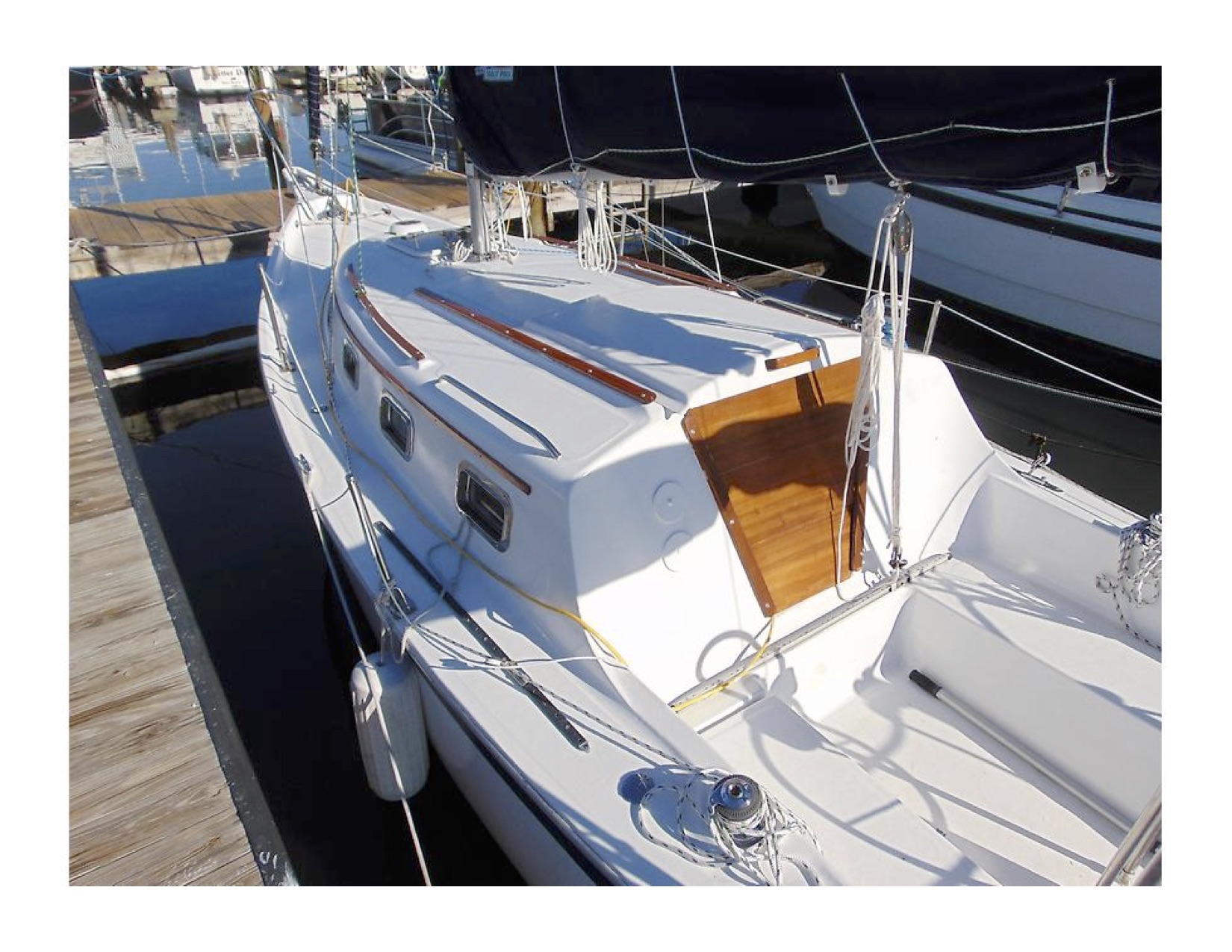

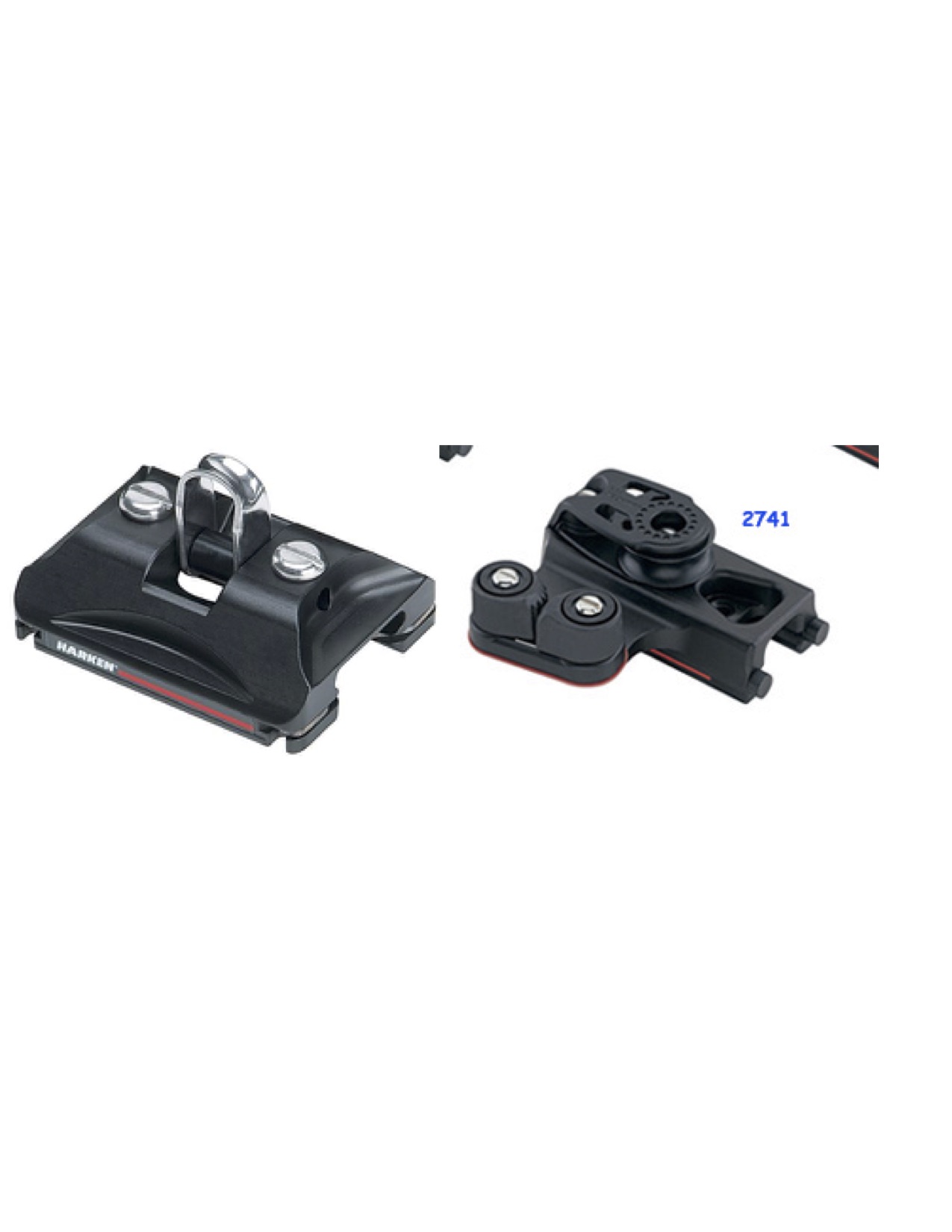

His track appears to be on the bridge deck.... so he would be sitting between the track and the wheel. If it were me I would extend control line away from the track a bit with a couple of cam cleats with fairleads fixed high on the coaming side.. either vertical above the track end or angled aft at 45 deg, depending on where you sit. On a boat that size with the boom attachment about 3/4 back, I can't imagine needing more than 3:1 purchase... so... a double at the track end, a single with becket on the car... tie the line to the car becket, up to coaming, back to car, back to coaming and up to winch. Instead of the double on the coaming side... two separate singles straddling the track will allow you go pull the car right to the end.... instead of losing 4-5 inches to blocks attached to the track.
Finally, remember that Harken's track is proprietary... so you're committed to Harken cars. Standard I inch track will accommodate many different brands.... lewmar, garhauer, schaeffer, etc. Garhauer sells track cheap.
what I had in mine was a combination of these two systems.... On my Cat 27 I use something similar to the right one with the line being continuous..
