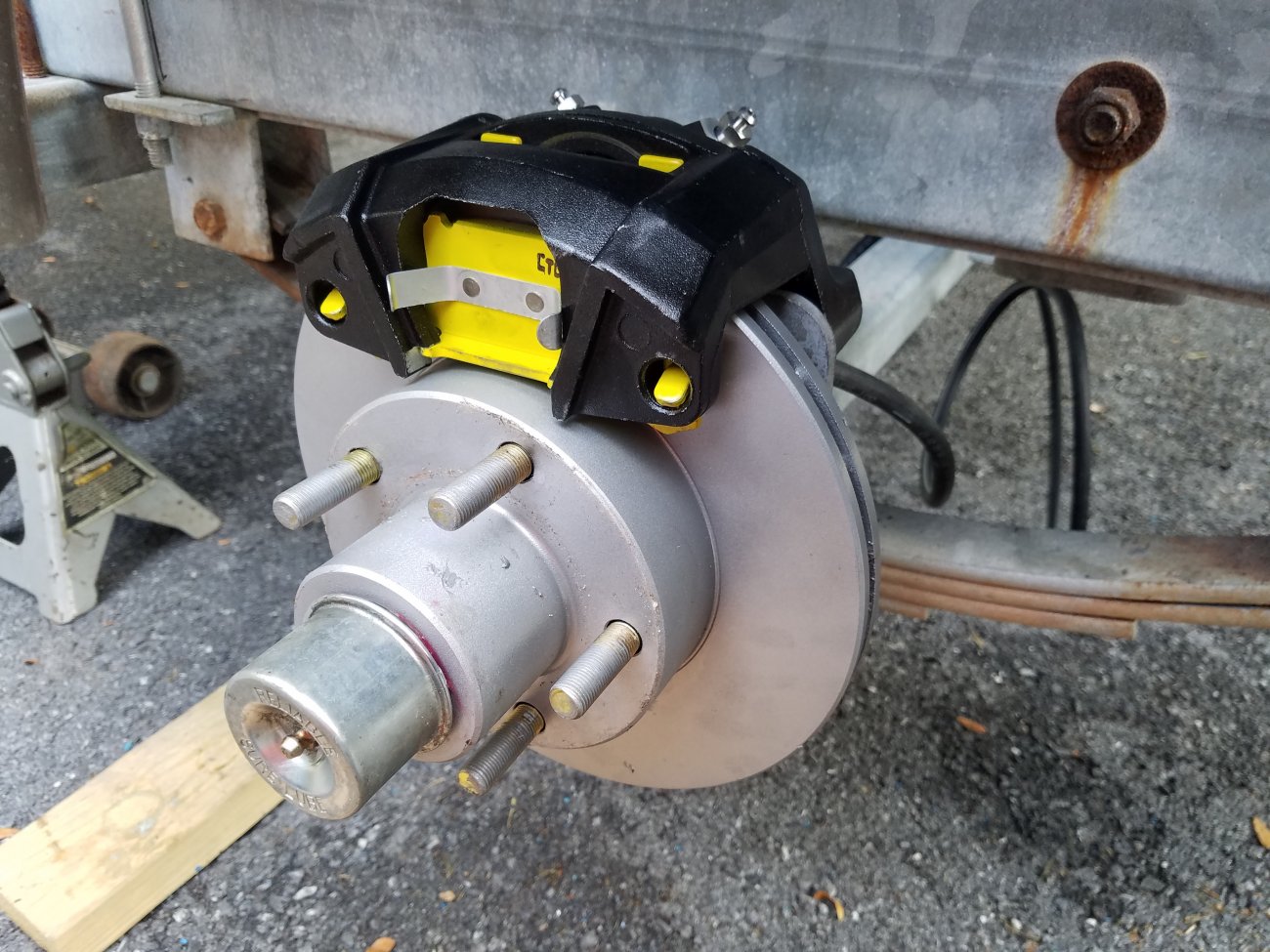

I put this disc brake kit on my Load Rite trailer last summer, <$500 with shipping. Easy install, the kit comes with everything you need, it is all nuts and bolts work. The caliper brackets bolt to the square flange that the drum brake backing plate bolts on to.
You will have to deal with your welded on actuator, nothing that a 4.5" angle grinder won't take care of. If you do a lot of salt water work they sell some pricier kits that come with stainless steel components.

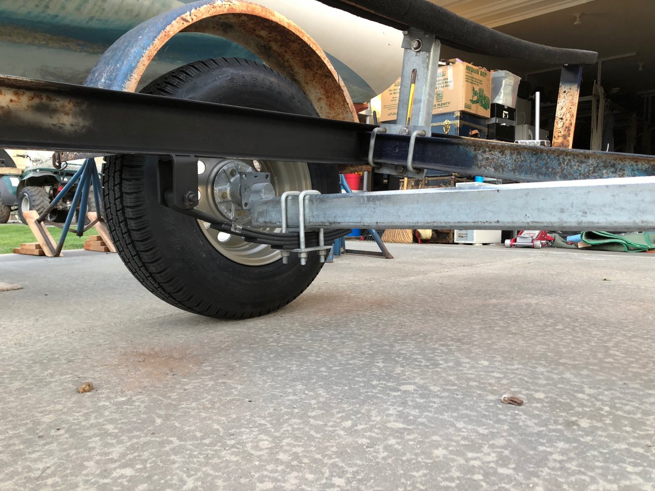

For comparison sake-- I took my stock '73 Sail Rite and bolted up a new #3500 axle / springs / hub/ wheels for around $600.00. Did all the work myself, and find the results (we road tested with the boat 300 miles round trip) quite pleasant. Think if I was to do anything short of what I accomplished I would just go new -- Philosophy is that my 1/3 investment should get me far enough down the road to not care when it comes time to talk trailer again.
Fair Warning-- the upgraded Axle adds HEIGHT!!! I had raise my bunks to accomodate the keel -- doh :)
Nice work, and you are lucky to have adjustable bunks. Mine are welded so I'll need to keep the replacement axle(s) as close to oem as possible, height-wise. Thanks for sharing your experience!

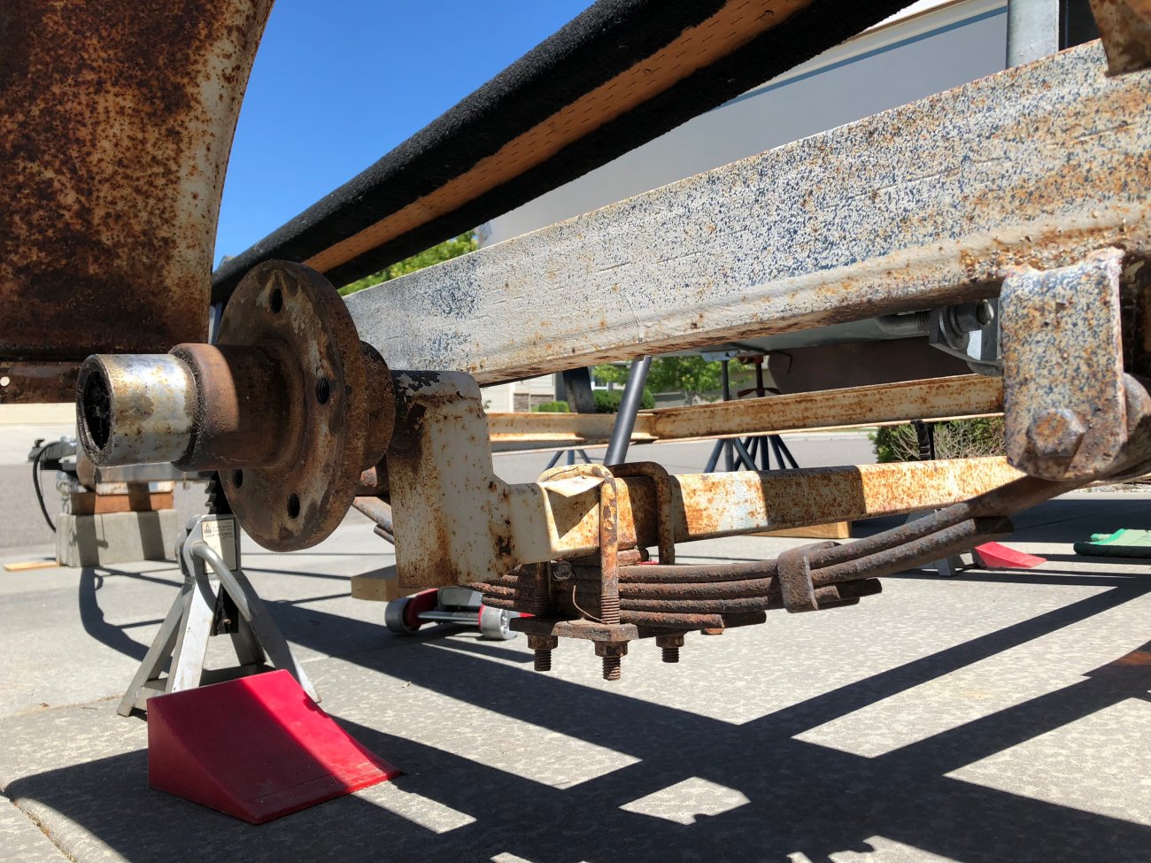

I have an 87 Catalina 22 swing keel in great shape. It came with an 89 Trail-Rite trailer with drum brakes that are totally inoperative. The axle is a "drop" type, attachment points have old-school lug bolts. Surface rust appears on the leaf springs and brake housings, but overall the frame and bunk supports seem solid.

Do you agree from the photos that the rust in question is likely surface only, and does not impact its load bearing capacity? Owner #2 used it to launch and haul once per season, but not sure about the original owner. I don't own any 30 year old cars, but I'm not sure that is a fair comparison anyway.

If you can rebuild the trailer for half the cost of new I think you should do it. Just because it's 30 years old doesn't mean the metal is bad. Make sure the rebuilder knows what he (or she ) is doing. I had a lot of work done to my trailer the work was done by a firm that specializes in serious rust repair of cars and trucks. They did a nice job.
