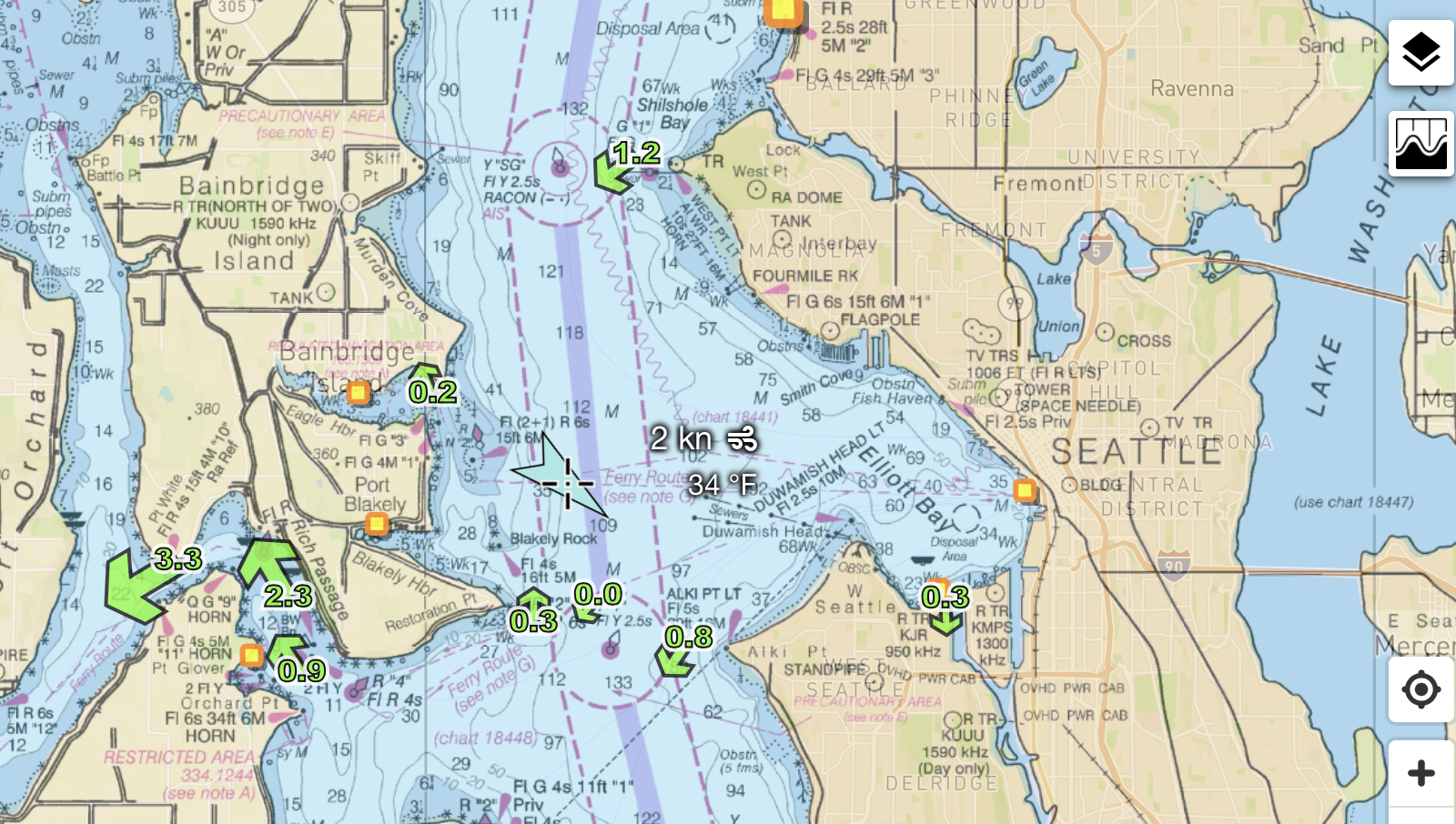

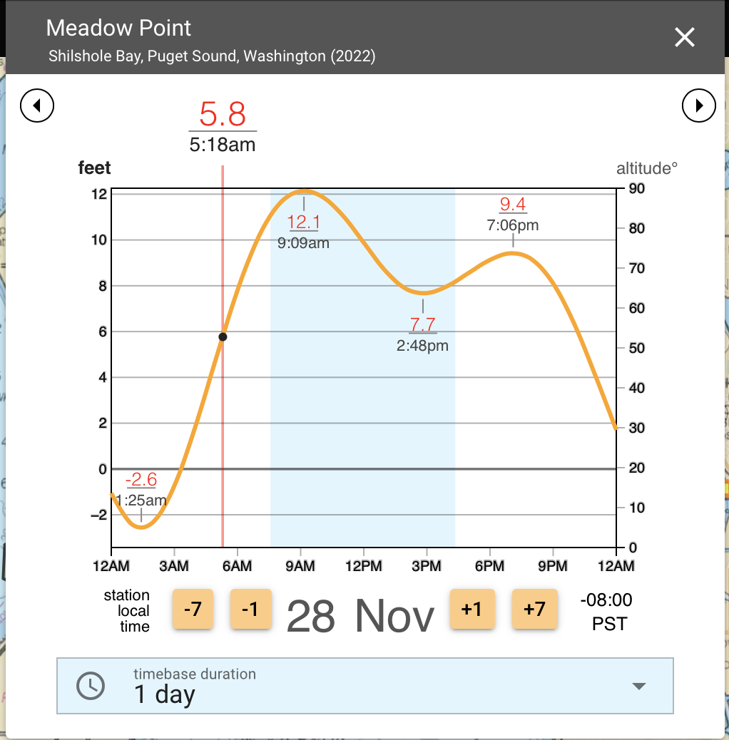

are you located where there is a current?
Unless you are lake sailing in the PacificNW there is a current 4 times a day.
Where you are located determines the speed of the current.
Here is a screen shot of the area showing the tidal currents at 05:15 this morning.
Shilshole Bay is a popular marina in the Seattle Area.
Here is today's tidal change.
