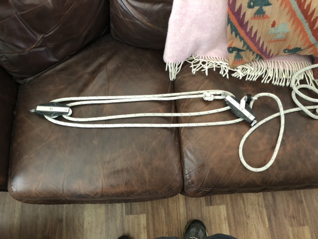

I have an ‘85 Hunter 23 and this is the first year I’ve had her in the water. I had the mast stepped and got the jib attached, but have my doubts about the mail...any help?

All I have now is a sail and empty boom and mast. I have some ideas so gonna try to do what I think is right, then I will have specific questions and photos. Thanks for replying so soon.
8,119
Mast will have either a sorta T shape track screwed into the aft side or a slot on the aft side. The main sail will have either a "Bolt rope", slugs or slides that fit over the T track. Knowing which would be the first step to me. Then figure out how the boom attaches to the mast - "The Gooseneck." You do have a halyard on the aft side of the mast to haul the sail up with -right? Be careful to not pull the tail of the halyard into the mast. If you lose the tail it's a job to re-reeve it. I know because I've done it. If the boom has a slot on the upper side the foot of the mainsail should have a bolt rope (Or Slugs) which fit into the boom. You normally do that prior to the hoist. The end of the boom should have a fitting, or even an adjustable fitting to receive the cringle on the clew of the mainsail. Mainsheet attached to a fitting on the under side of the boom. Normally there is a several part tackle with attachments for the boom and hull. There's a bit of variability to the system - in part to suit the owners taste. i.e. the cam could be low so that you can use your legs to release it. But then you would probably have to use your foot to put the mainsheet in it. Of is it's high you can use your body weight to release it but would need to pull up on the mainsheet to set it. You can put the cam almost anywhere through the use of a pennant. But just set it the way it is and sail it to see how you like it. It's pretty simple if the hardware is complete.

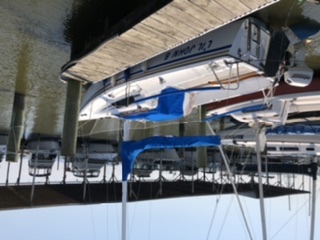

Ok folks...thanks a big gob for all the help and suggestions. Just got home from the marina and this is what was accomplished...main is secured to the boom w bolt rope foot...clew is attached to the outhaul...slugs are up the mast...and halyard is attached...see photo

Oh, but a hitch is such a useful knot.
How did you tie the fenders to the grabrail or shroud?

Nothin wrong w the tiller...had to change course a couple of times...as far as the hitch, I do creative knot tying...lol
24,779
Your avatar says your in MD, but from you boat photo thought you must be in Australia. Mainsail would likely run up the mast easier in that orientation.
Good for you and your boat surviving your first Sail together. More fun to come.

Don’t know why that photo was upside down, but it did make it almost like running the main down the mast...
