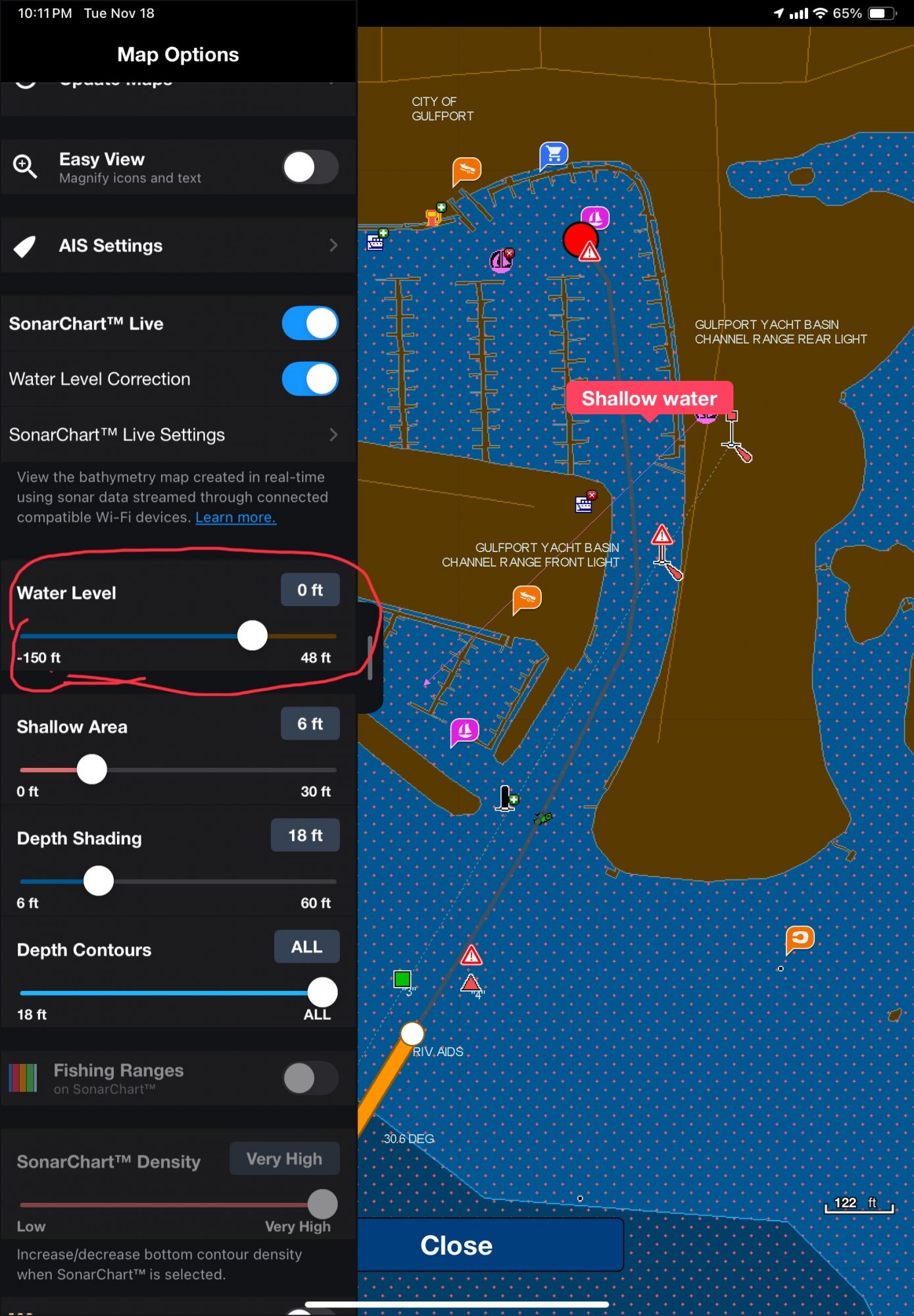

I’m not quite understanding the depth shown in some marina areas. For example, the Gulfport Municipal Marina in Florida. The app is showing a 0-3 foot depth for the whole marina area, yet I know there are some rather large boats that go in there, so it must be deeper than that. What am I missing?
Also, for the “Water Level” setting, what exactly does that mean, and where do I get that information?

Regarding the Water Level setting. It is a tool to establish the Datum of the water you are on. Charts have a Datum established. If you are on a lake and there has been a drought. The Lake might be 2ft below the datum level on the chart. This feature allows you to adjust the datum on the screen. This could help you avoid shallow places that could get you stuck had you not adjusted the datum to reflect the current water level.
Garmin provides a complete discussion of the Water Level adjustment feature.

Thank you. I was not aware of what the Water Level feature meant.
Fred W
On the Great Lakes there are several websites that report near real time water level data. In that data you can determine whether the water level is higher than the chart datum or lower. Lake Ontario chart datum is 243.3 ft above sea level. The current water level at Oswego, NY is 244.42 feet, the water is about 1.1 feet above chart datum.
