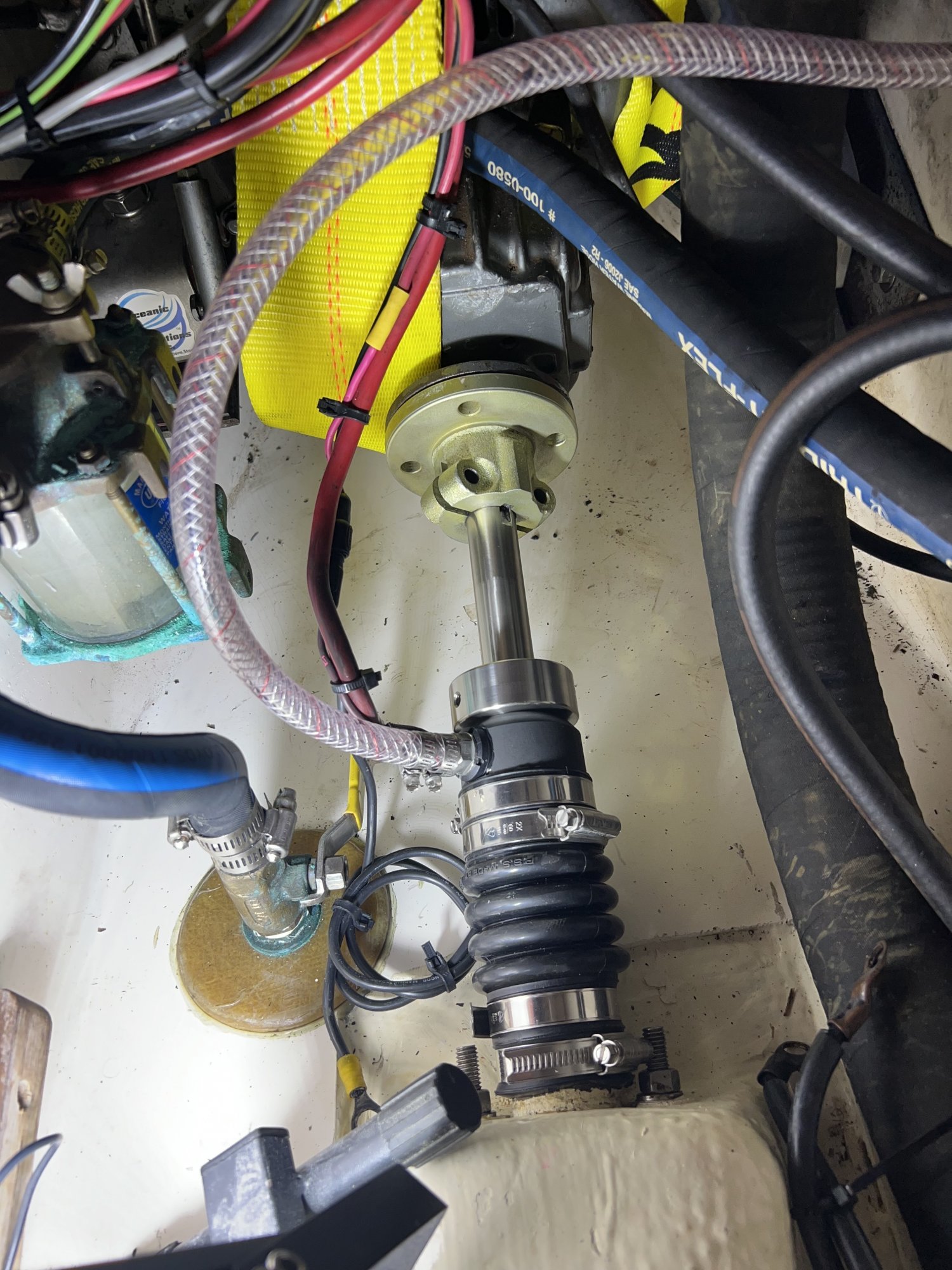

it looks like you have the shaft seal well under control. I would be concerned about getting the shaft coupling aligned to the transmission after changing the mounts and prop shaft.
Thank you for your response! This is my next project but I will have professional help when I complete that part.

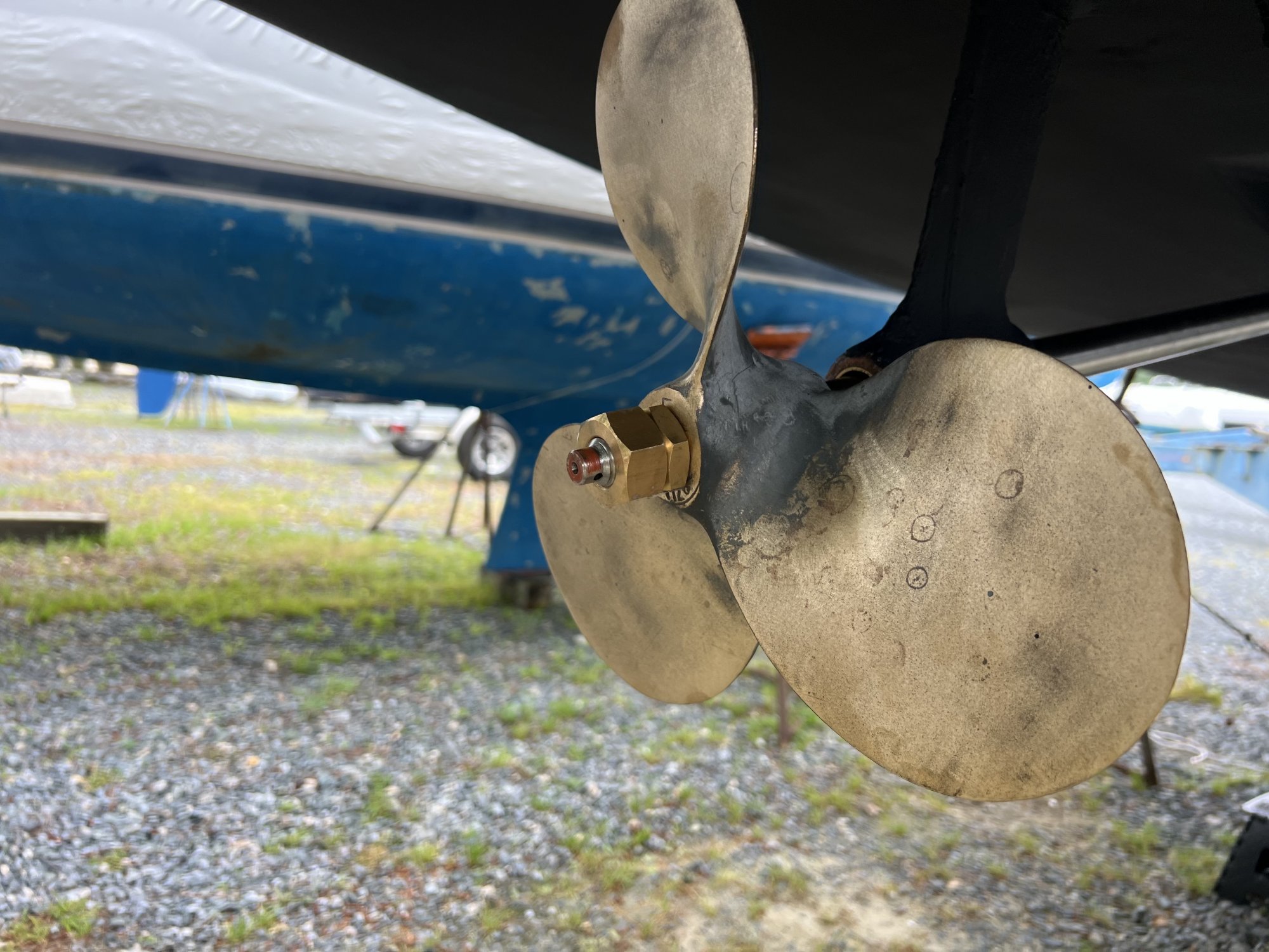

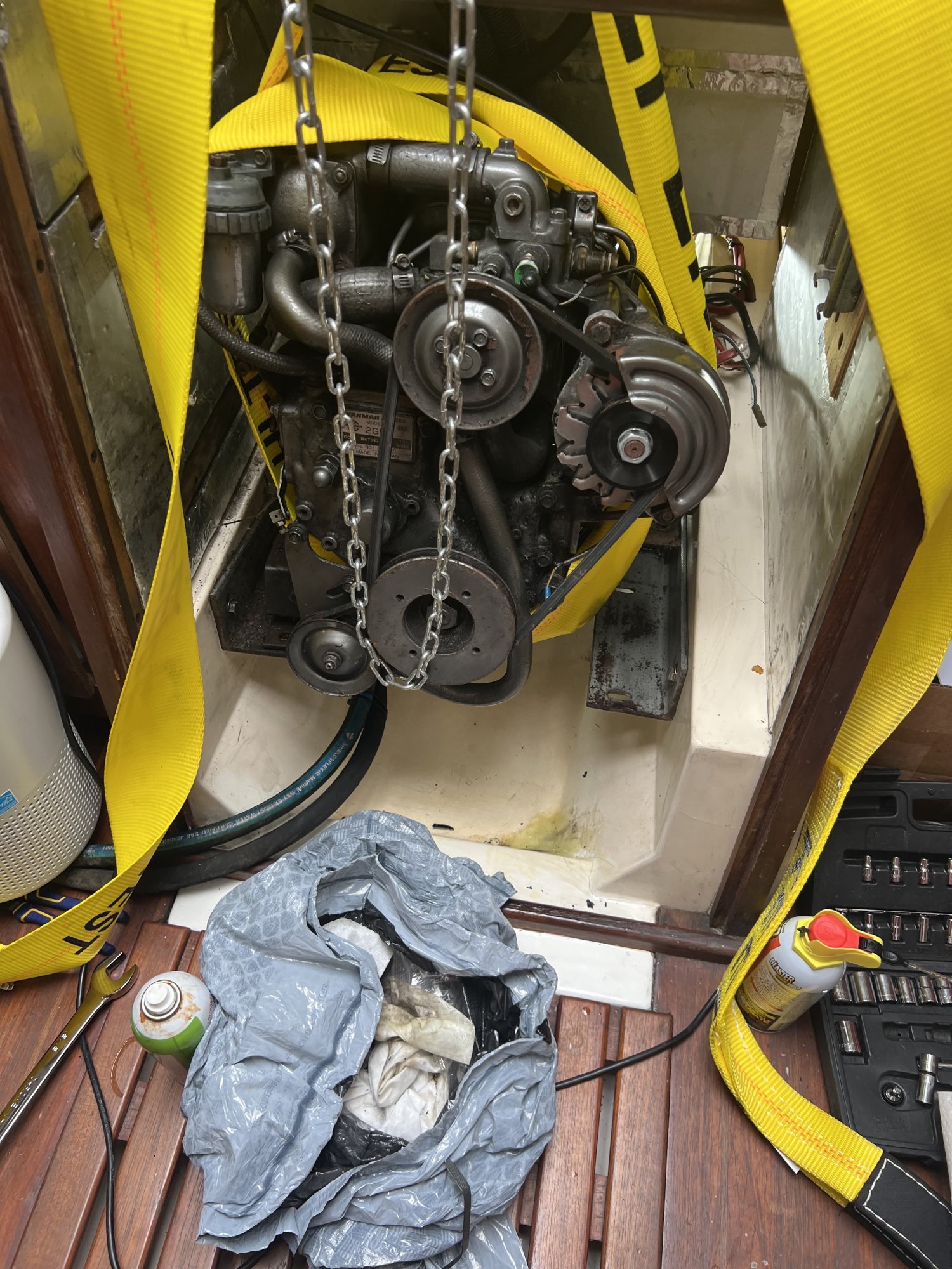

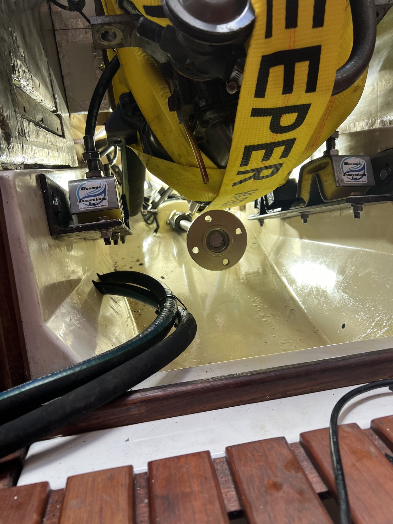

Hey everyone! I have a few updates. I didn't take enough pictures, but I do have a few to show the progress.
Tasks completed over the holiday weekend:
  • Installed new Cutlass bearing
  • Installed new engine mounts
  • Installed new prop shaft
  • Completed the first round of engine alignment (I have to do more, but I ran out of time)
Work still needing to be completed:
  • Finish the installation of the dripless (need to compress the seal with the bearing, just didn’t get to it yet)
  • Fully attach and tighten all motor mount bolts
  • Run a new fuel line (I have one that is leaking)
  • Finish installing the propeller & attach anodes to the to shaft & paint shaft with prop coat
  • Drop the boat into the water to complete final engine alignment
Sorry, I know this is a lot and more than the topic of this post, but I wanted to share my progress to make sure I am not missing anything. As always, thank you all for your support and helpful tips!
