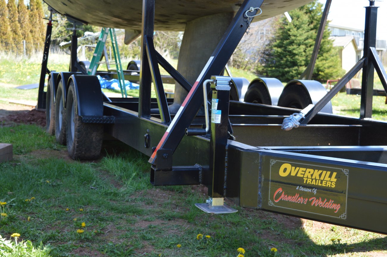

Dec 31, 2016
319
Beneteau Oceanis 351 Charlottetown
This is a timely thread. I'll be watching it as well. I've been thinking of getting two extra jacks for the back two corners of the trailer so I can jack the tires off of the ground an inch when the trailer is sitting for a long time. But then... I wonder if that is a necessary precaution. I'm thinking that if it was a good idea, people would already be doing it.
Yup, that works good, I welded one on each corner of mine when I built it.
Likes: rgranger
