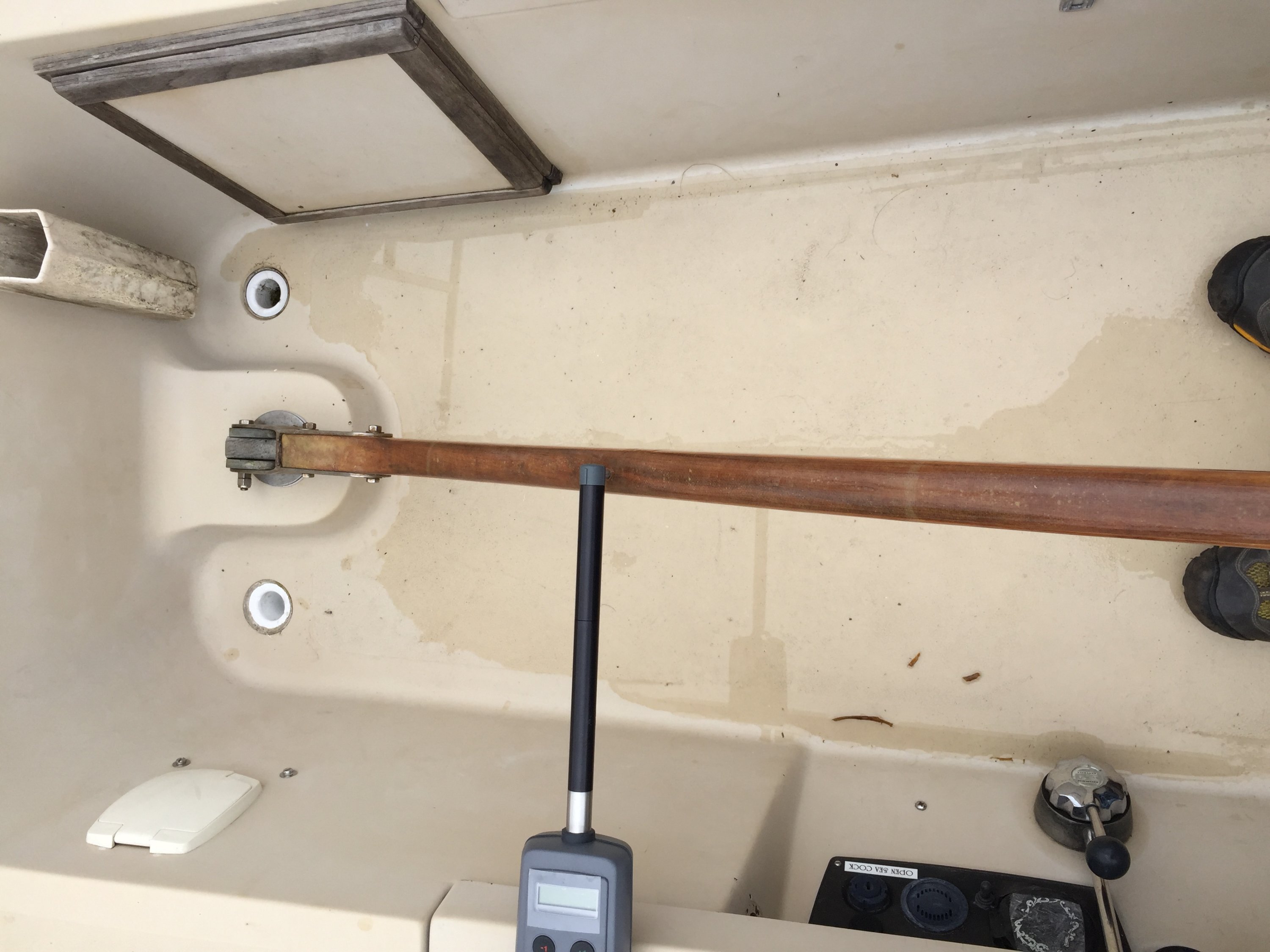

I bought a San Juan 28 which came with a new Raymarine ST2000 that the PO had begun installing. The mount on the seat and the tiller pin are installed. It came with two tiller rod extensions (4" and 5") which get it about an inch from center so I may need to get a 5" to get me closer to center. I have not connected the autopilot electronically yet.

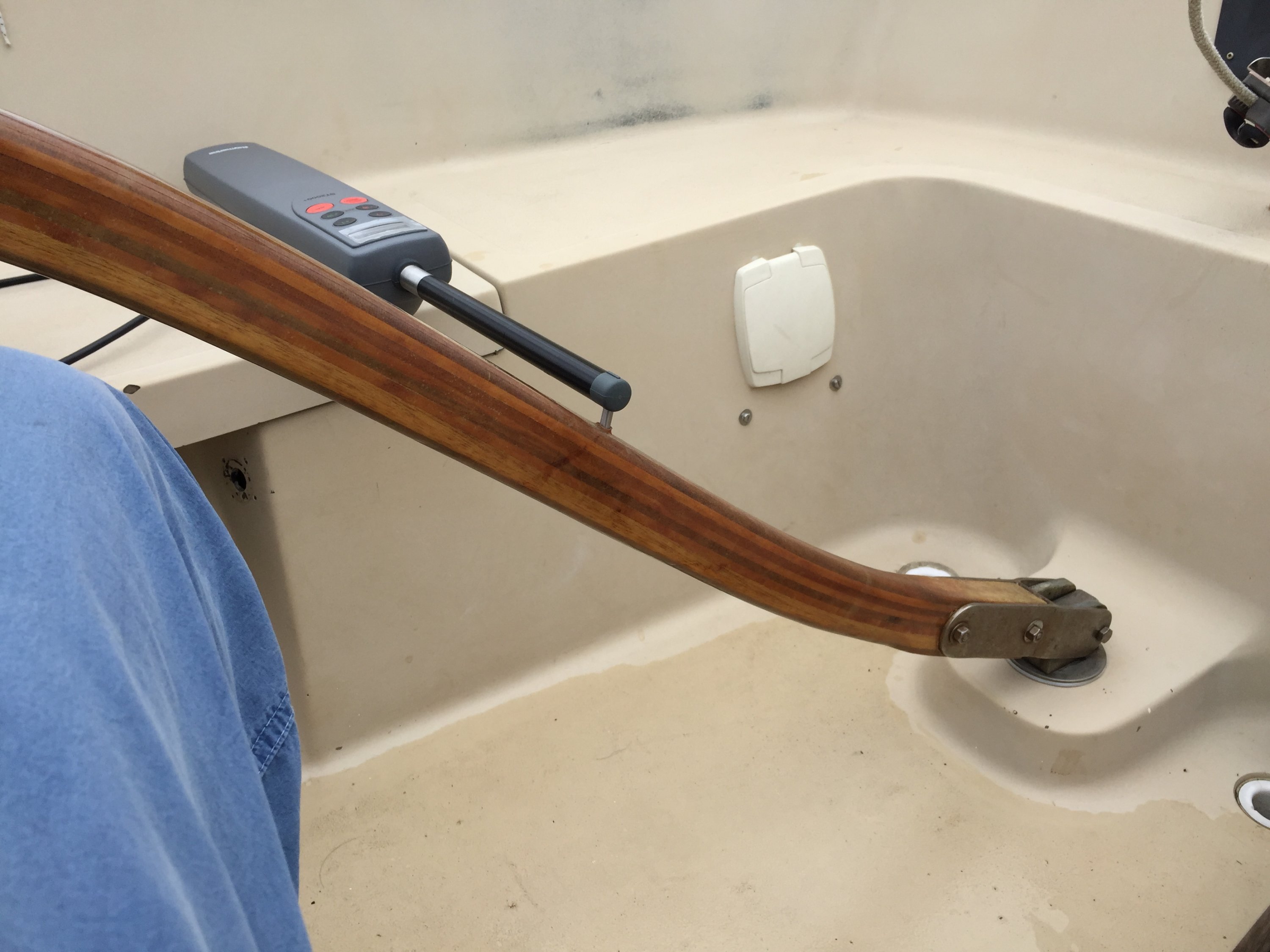

The tiller currently needs to be raised up to sail the boat or it hits the seats. This is not such a big deal without an autopilot as I just lift it up and sail. To operate the autopilot currently, it would have to rest (somewhat level) and slide a bit on the starboard seat but also the pin would have to essentially hold the tiller up above its naturally resting position....which I imagine will not stay connected when sailing as it is set up.
I've considered a couple options..... buy a new tiller with a much higher rise that clears my seats or extend the tiller up maybe enough to clear the seats or find a way to keep the tiller attached to the autopilot rod.
I would appreciate any ideas or solutions.

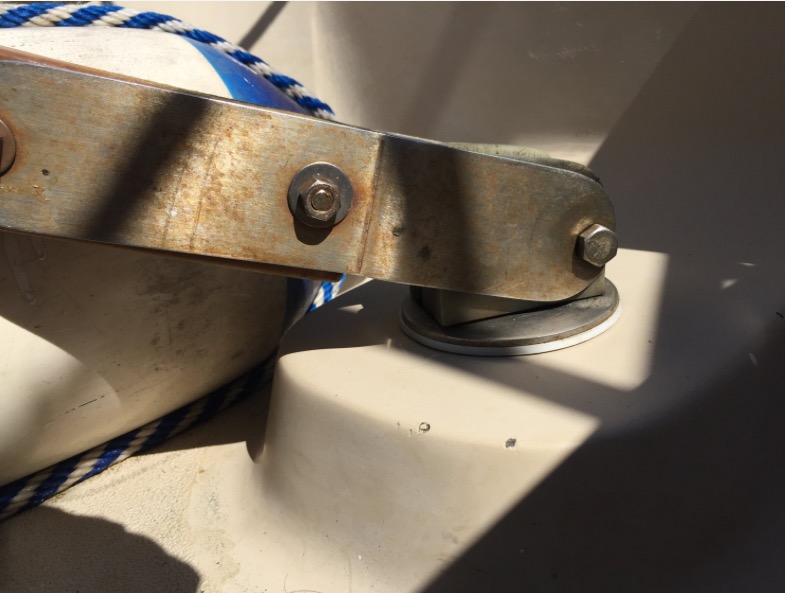

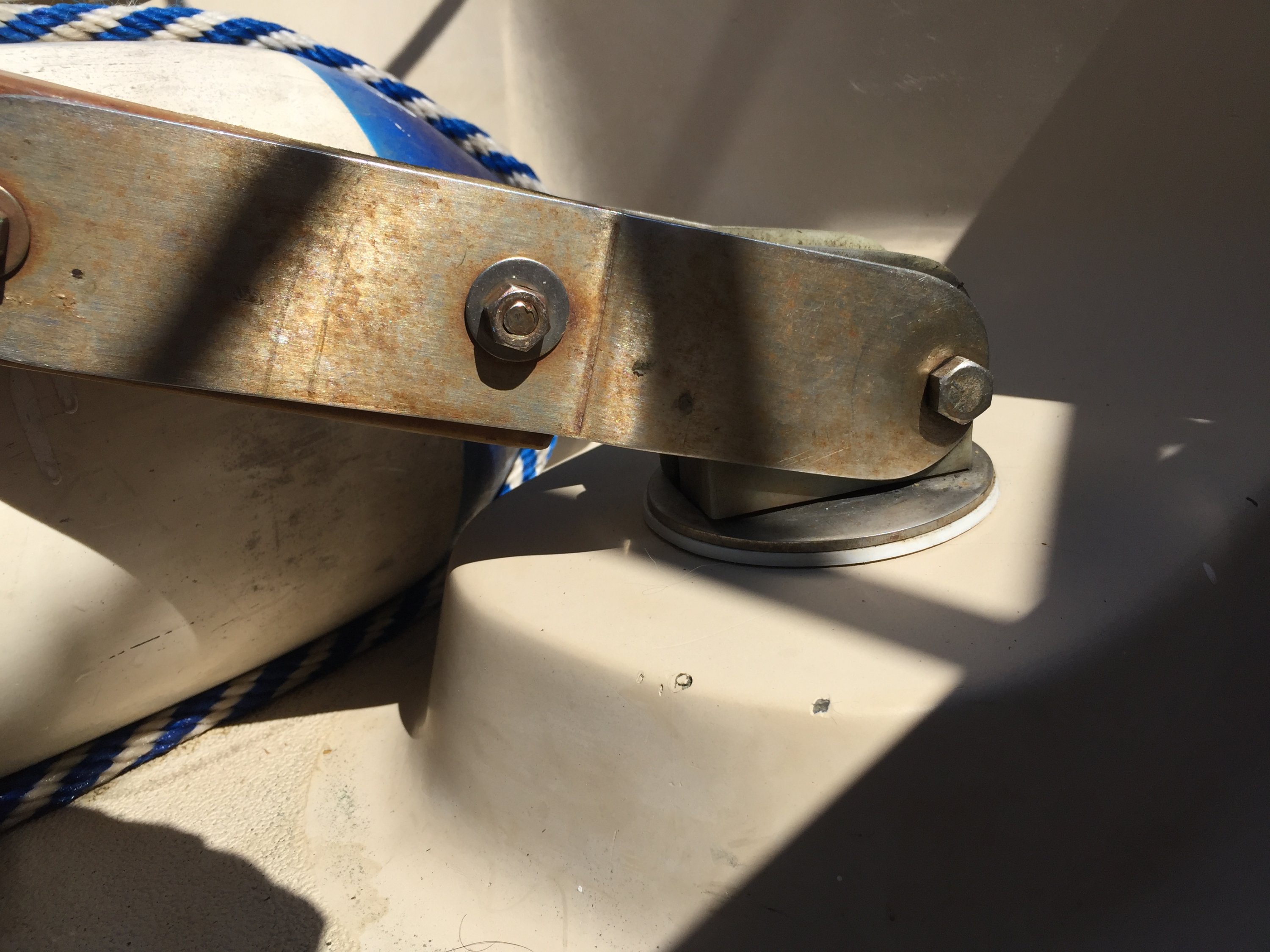

It appears the problem is not with the autopilot.. it is with the tiller bracket.. I tried looking at some other SJ 28's to compare to yours. I am somewhat convinced that the tiller bracket on your boat is NOT factory made.... it appears to be fabricated from metal sheets... and it does not support the tiller correctly. Looking closely at these two boats shows the bracket to be a much heavier casting or forged hardware... My C27 has a similar casting....
Unfortunately, tiller bracket castings or forgings.. are very expensive.. For instance, a replacement Catalina 27 tiller bracket runs around $600.00 !!!. Yikes...
I would consider modifying the bracket to support the tiller properly... if you can't find a reasonably priced replacement. You do not want the tiller pilot supporting the weight of the tiller... no, no, no.
Looking at your close up of the bracket.. I would take the entire thing off and have a welder attach a horizontal bar to the CAP...in such a way to keep the bracket from settling on the deck. Building up the deck area rather than modifying the bracket/head may work in the short run until a more robust solution can be found.

Thanks for the effort to provide the SJ28 pics. They do appear to have the same issue as mine.

If you were to install a large stainless steel "washer" around the washer that is already there, and attach it to the fiberglass with countersunk screws, you could then cut a UHMW or nylon washer to set on top of it..... then weld a support on the tiller attachment to rest on the UHMW..... this would be easy to do and prevent any wear any wear to any part of it.
providing you had the tools and the ability to visualize objects in relief, so you could know where to cut, and using delrin or filled nylon, one could build the plastic piece as the entire support(no welding).... the stainless wear ring would still be needed to protect the fiberglass from wear as the support rotated around, as grit and grime will always find its way under the it...

I agree with JSGs idea of a piece of UHMW (starboard?) cut into a half circle and positioned against the up against the existing washers. It will act as a support for the tiller, supporting it at the metal bracket. I did this on my first boat where the tiller sat on the transom. I didn't need more height so I used UHMW tape. worked well.
Then use whatever bracket is needed to support the pin of the tiller pilot so the socket of the rod just rests on the pin. I suggest you don't set it up where you need to tie it together. In case quick evasive action is needed for any reason you want to be able to quickly pop the tiller pilot off of the tiller so you can turn the boat by hand.
Edit: I was still writing when JSG just posted which made me think to add, my idea would probably require through bolting the UHMW support.
To eliminate that requirement you could use hole saws to cut a washer that the existing washers sit into. The new thicker washer would support the tiller.

I thought thru the UHMW idea and decided instead to have a welder add a very small triangular wedge at the bottom of my tiller bracket so it would rest on the large base swivel washer. Cost me $30 at Pete's Welding in Port Townsend. It works perfect and the autotiller rests level in its pivots points on my seat and tiller. While waiting for my welding job, I went next door to the Marine Thrift and bought a new, in the box Raymarine wired remote for my autotiller for $40 which will allow me piloting all over my boat. I ordered a second switch panel before I wire and need to get a 1" or 5" tiller rod extension to get the tiller 1/4" off center of my boat. Thanks for your help.

I have a 30 but by looking at the pic's your going thru what I went thru on mine I ended up getting 2- 6 inch extensions from west Marine from what I saw in the pic you only have an inch or so pull to Starboard and then full extend to port I would add the extension with the st 2000 farther back so the extend was equal on both the pull and retract of the Unit I had to go with 2 six inch ext. and a 4inch on mine had to go from the edge under the rail all the way across the seat but I think if you just add and ext and mount the unit farther back that should give you plenty of roomBut looks like you may end up cutting in the cockpit wall to make it work and easy sealing Job since the control is exposed then when not in use just remove the ext and disconnect from tiller and you could pretty much seal the unit right in place Where you cut into the side wall
