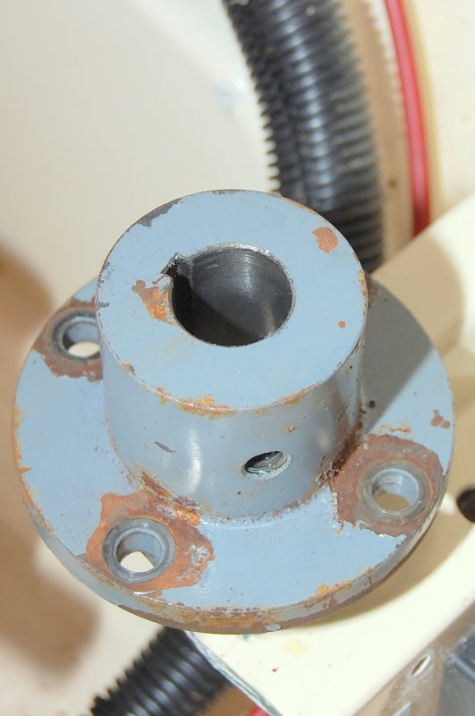

I do have experience with seeing failed couplings due to fit issues. I worked in boat yards in my younger days and was the grunt who was small enough to be doing most of the stuffing boxes and shafting repairs (really hated that job:doh:).
A friend also manages a local shafting shop here in Maine so I do intimately understand the process and have physically watched the entire process from start to finish, had my hands on the machining tools, and played with the calipers and dial indicators, it's where the shafting pictures came from, my friends shop.
It is not only the coupling that will suffer from a sloppy fit it is the key, key way, shaft and set screws. If you are cleaning up "corrosion", that is, and was very likely, your "fit". Good boat yards around here will not re-use a used coupling due to the loss in fit as it is not worth the liability. A new fitted and faced coupling is usually under $100.00. A new shaft with coupling starts at $400.00 and goes up from there. Whey potentially ruin a good shaft?
The fit should be a light tap fit or a light interference fit as my prop shop manager refers to it as, not "hammer", and I never used the word hammer anywhere. If you choose to not believe that a light tap fit or light interference fit is how good shops do it, then that is fine.
If your coupling when, "brand new it did not need force" was fitted and faced by a competent shafting shop it probably should have been sent back for a better interference type fit.
I have ordered and used shafting and fitted and faced couplings from Catalina Yachts (good prices BTW), required a light tap fit. Also from H&H Prop, requires a light tap fit and NE Prop whic also requires a light tap fit. Hamilton Marine, requires light tap fit. Donovan Marine, requires light tap fit. Brackett Machine, requires a light tap fit..
Every once in a while, when working in the boat yard, we'd get one that just "slid on" far to easily and it would be quickly sent back to the prop shop. Of course this was in the days of Tobin Bronze shafting and they went on slightly easier than they do with the Aqualoy or Nitronic shafts but still always required a light tap fit..
In order to re-use a coupling the interior should look at least this good. If you have a layer of rust you should pitch it and get a new coupling and have it fitted and faced.
