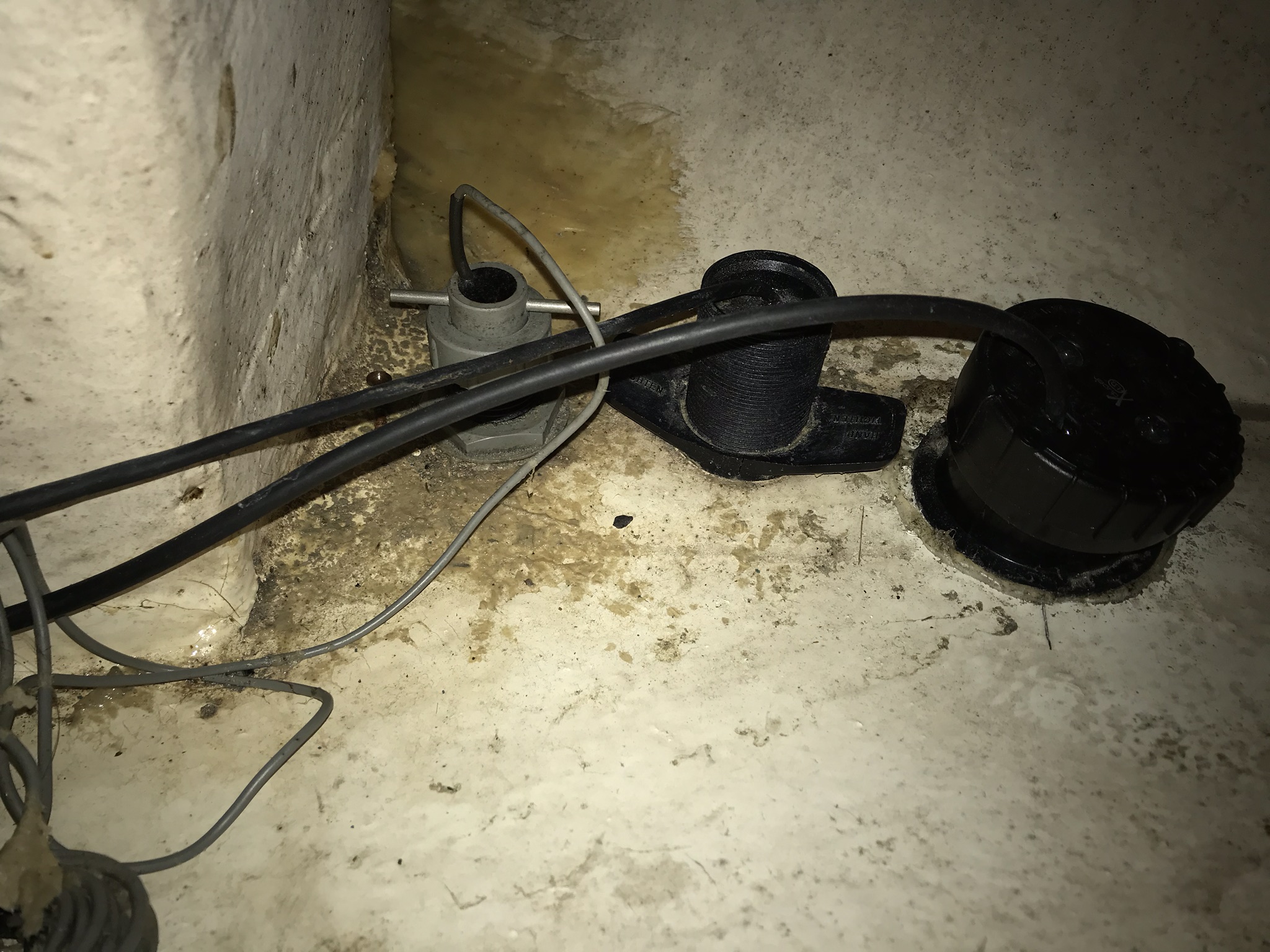

Well my first thought is to not put any new holes in your boat at that location. Unfortunately it’s not likely that any of the newer Through Hull sounders will fit that hole...but maybe. What’s the sidewall patch in the background, behind the curious transducer, all about? Your shoot through the hull (puck style) transducer/sounder should work with a lot of newer equipment. Is that currently not working? Perhaps just a remount will serve you well.Any thoughts on locating a new transducer in that same area with the existing working transducer? Any interference issues? Thanks for the replies!
