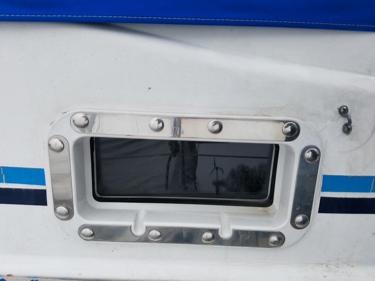

I recently purchased a 1985 Hunter 34 and the previous owner was in the process or replacing all of the portlights. Unfortunately, he stopped 3 short of completing the task. I'd like to finish the job using the same type of portlight but can't seem to locate the manufacturer. I've asked the previous owner where the replacements were sourced but haven't received and answer. Hoping someone on the forums might recognize them and be able to point me in the right direction?

They look like the ones from New Found Metals. Welcome to the group.
I agree. They look like New Found Metals.
The originals are likely the Gray Enterprises portlites offered on this site. They are still made in the original sizes, so are the easiest to install, but the P.O. already started with the NFM, so probably a moot point. The NFM portlites are a good product, but are not an exact size match and require some adjustments to the cutouts. NFM offers teak trim rings for the interior side to accommodate differences in cabintop thickness.

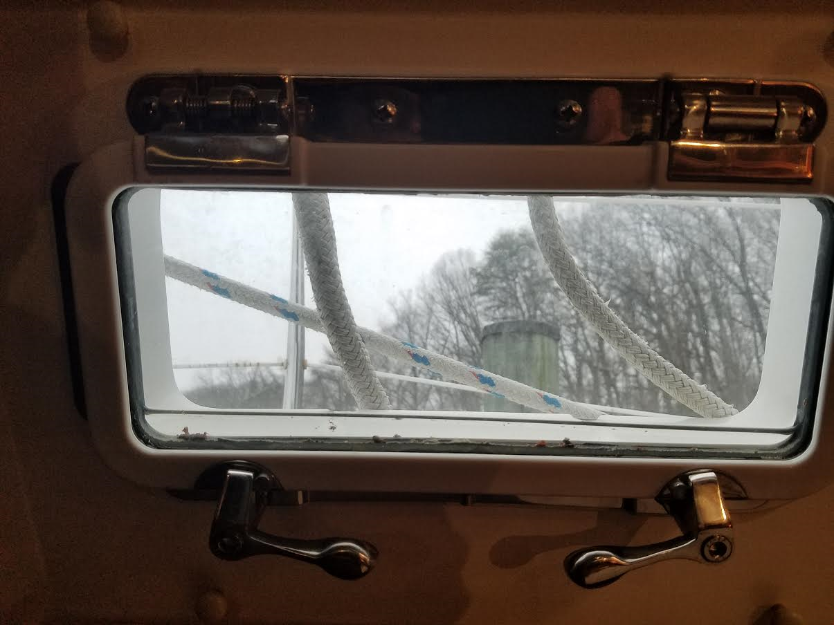

Your photo of the interior side is a bit blurry, so it's hard to tell for sure, but it looks like there may be something funky going on along the lower edge of the portlite. What are we seeing there?

That was quick! Thanks for the welcome and info on the portlights. Those are definitely the ones installed by the P.O. From the New Found Metals website it looks like I have the 5x12 model (2 latches) vs the 7x15 model (4 latches). Not sure if all the portlights originally equipped on the Hunter 34 were of identical size but the 3 remaining that I need to replace are the ones that open to the cockpit. I'll have to take some measurements and verify, I already have one of the remaining 3 removed.
Dalliance,
The picture does have some weird shadows going on but what you are seeing on the bottom edge is the metal trim and bracket for the latch. They are mounted directly to the cabin without any type of extra trim.
