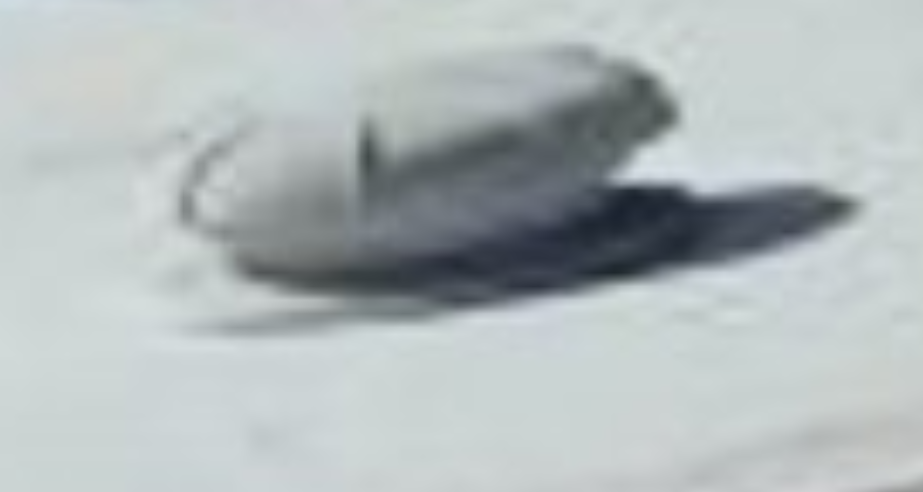

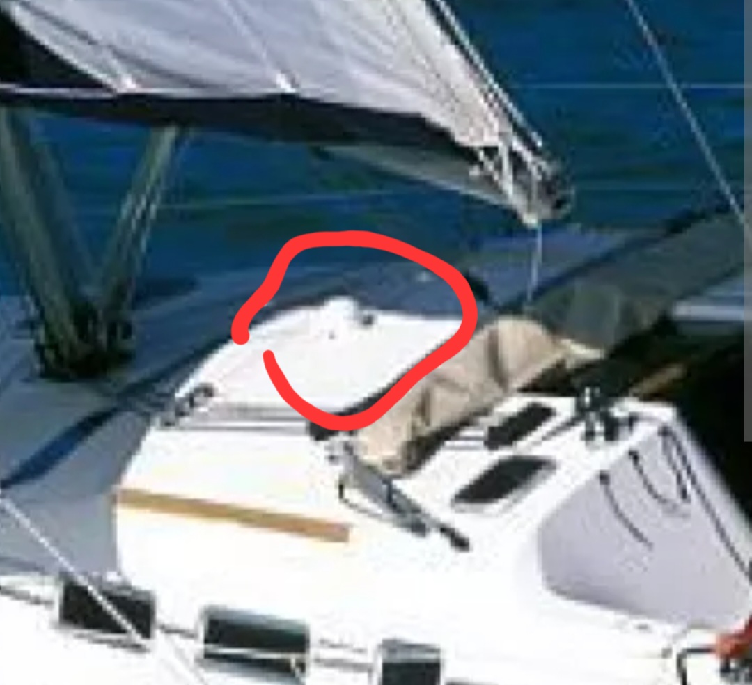

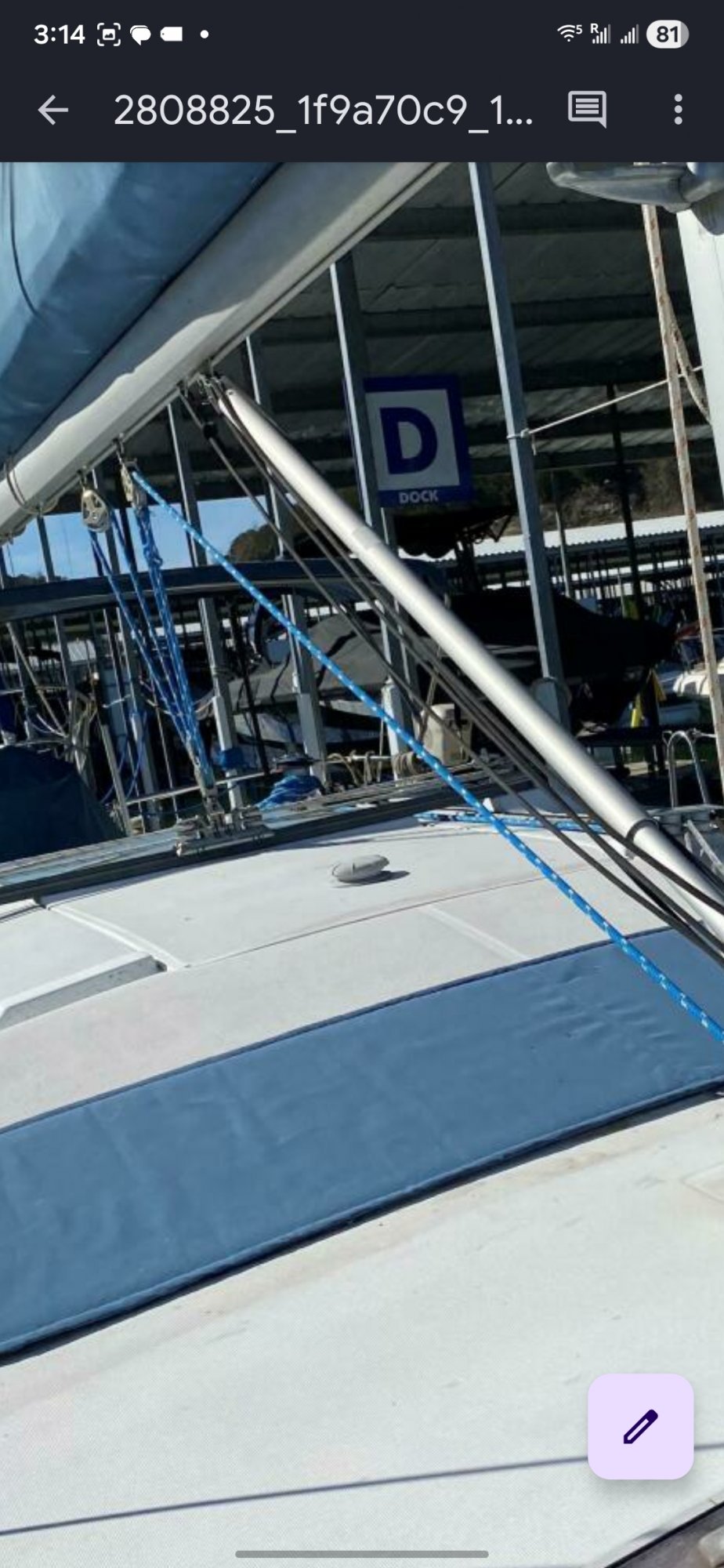

Please help me to identify how this white plastic ventilation thing is called in the top of the boats cabin? Mine is falling apart and I can't find how it is called to order new :(

And a happy belated April Fool's Day to you too. From the look of that excellent photo, I'd say it's a white toadstool which is growing out of your cabin roof.

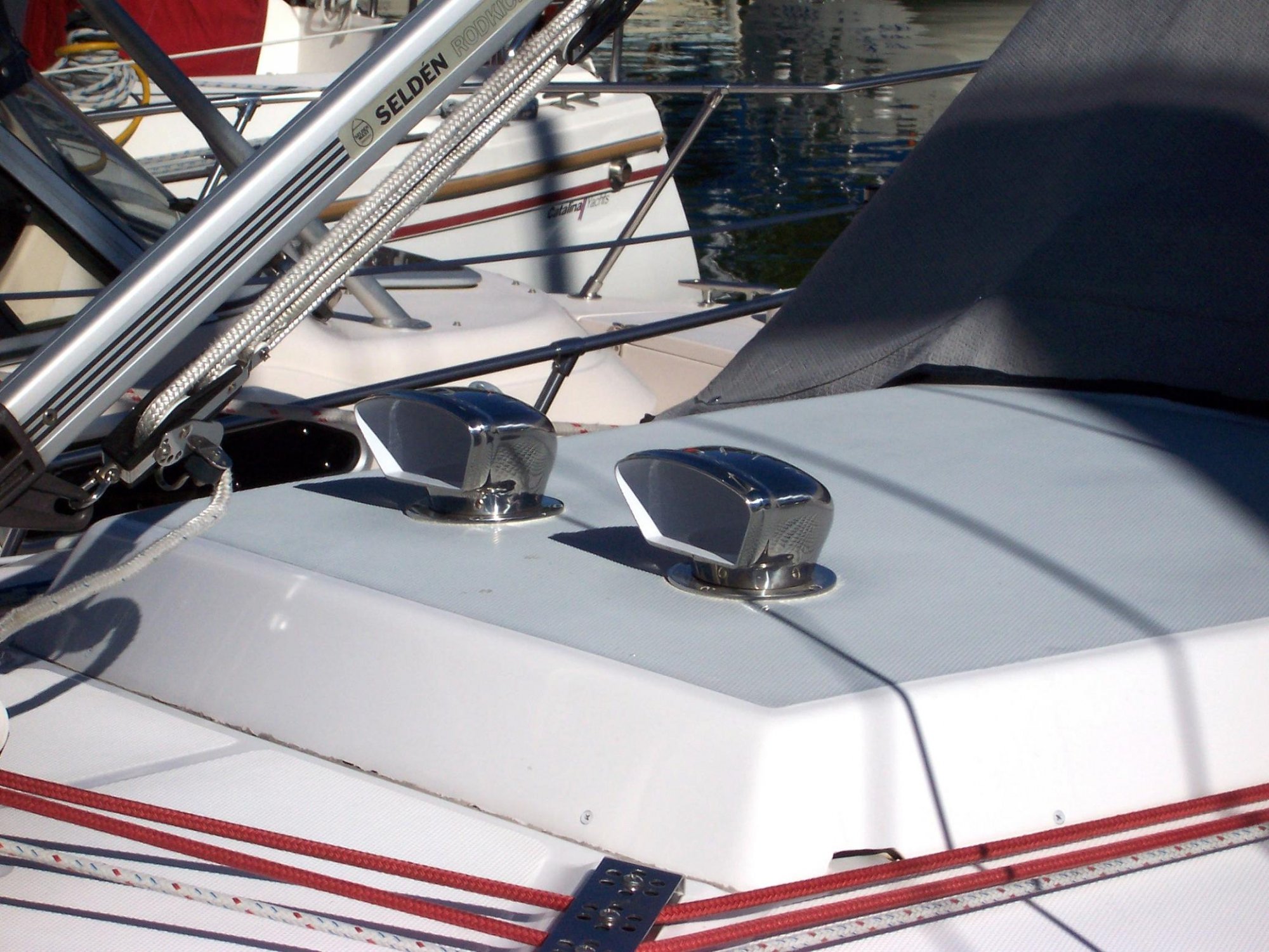

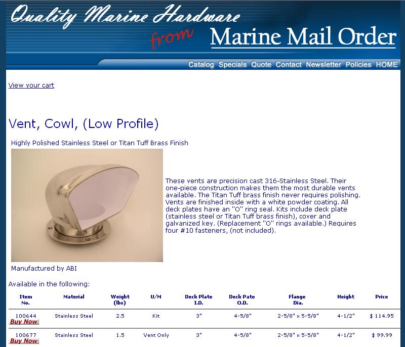

Barring that, it could be a cowl as shown here :
The SS is a little more pricey but the vinyl ones don't last more than a few years.

Now we're off in a whole new direction :
What you're showing is simply a vent with a weather cover. It allows stale air to be released from the cabin below it.
A cowl uses the kinetic energy of the wind to force air down into the cabin below. Two different devices for two different uses. Your call.

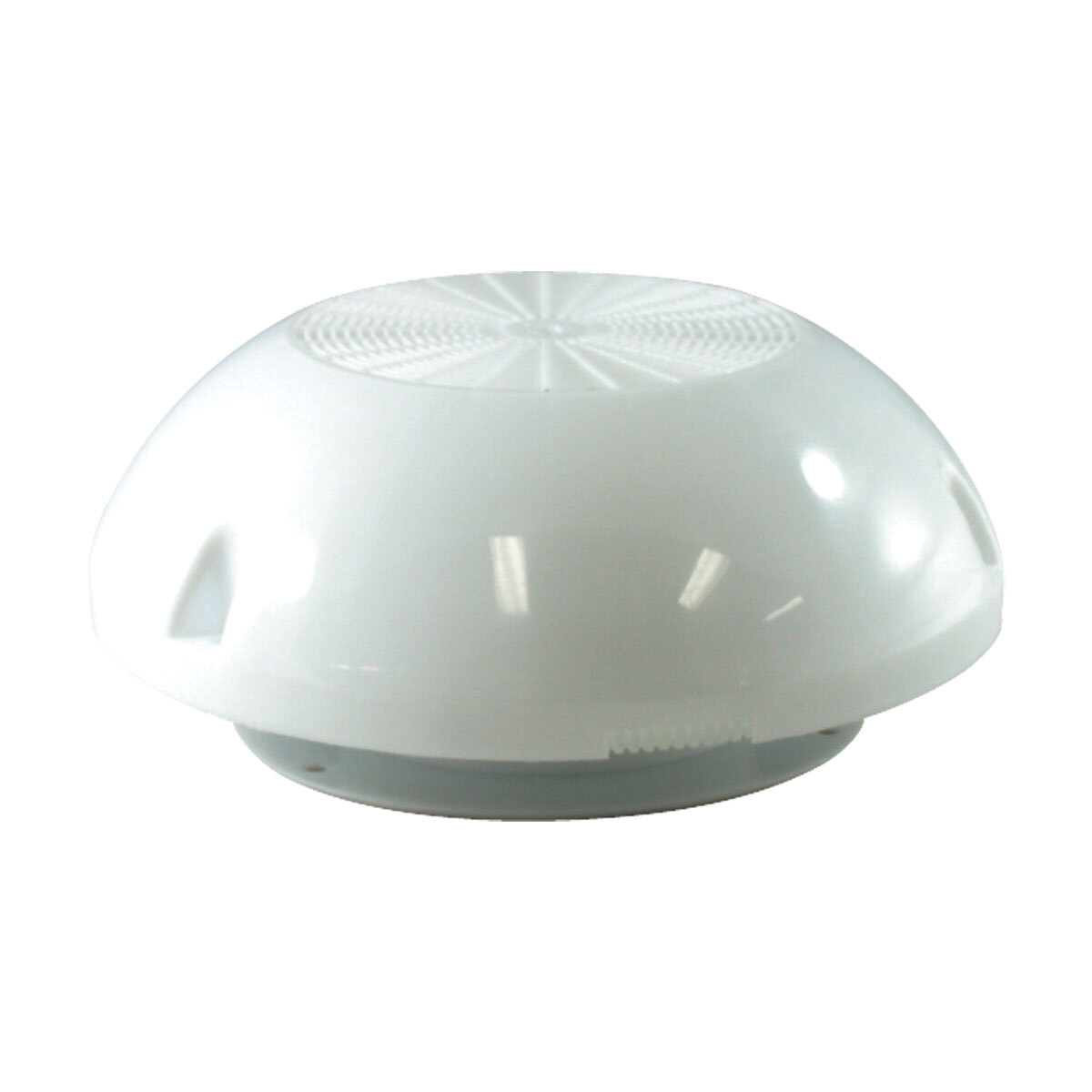

It is a dorade. It may be one of these.
Marine Town Dorade Dome Vent 175370. Marine Town Dorade Dome Vent 175370
