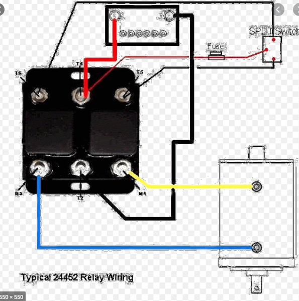

The wires could be for a control relay for the windlass or thruster. I have both and there is a dedicated battery behind a forward cover. A reversing relay would take 3 control wires.
