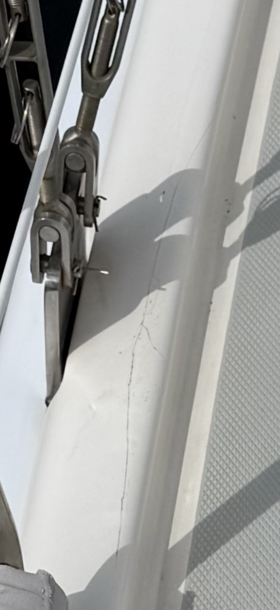

Under contract on this boat and a survey was done within a year so I was going to skip survey. But I’m a little nervous about the cracking on the deck. Everything else on the boat is in amazing shape.

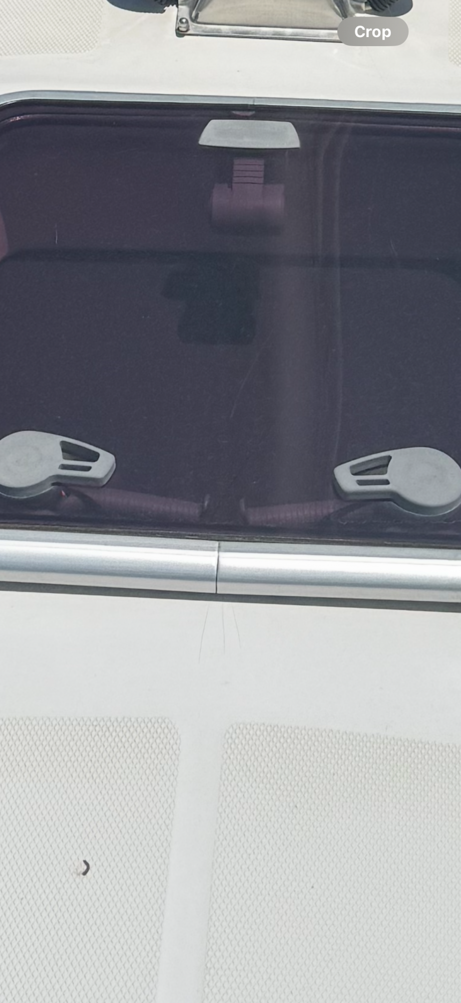

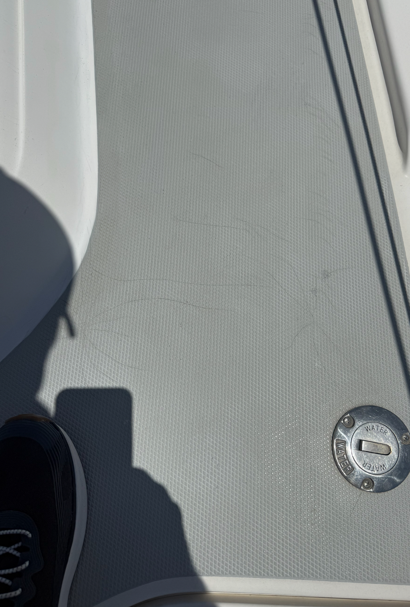

but on the forward port shroud deck plate I see a long stress crack on the rail. A smaller similar one on the starboard side same area. Also the port side has lots of spider cracks in the non slip texture that spreads out a bunch and into the flat decking. Boat is 15 years old stored in southern Cali sun so this could be normal but just curious what others think!

It would be a rare exception to find any 15 yr old boat with no stress cracks. Generally superficial.
The more troubling part of your post is your reliance on a previous survey. There are different types of surveys and different levels of thoroughness and obviously different levels of competence among surveyors.
If it was done for condition and value (. E.g., insurance) or if it was done by an owner or if it was done by some random surveyor, I wouldn’t place much value on its content.

Good. Just make sure that survey is acceptable to your insurance company. It may not be given it’s not current.
What you pictured appear to be stress cracks. No big deal.
