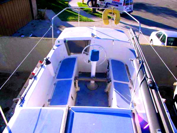

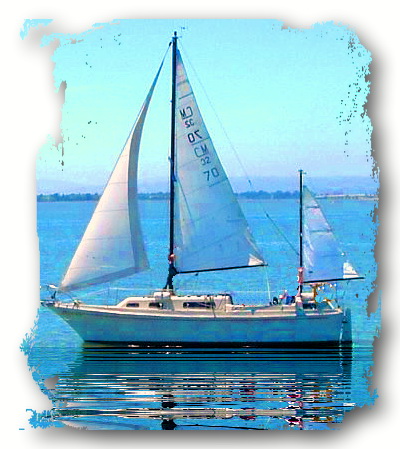

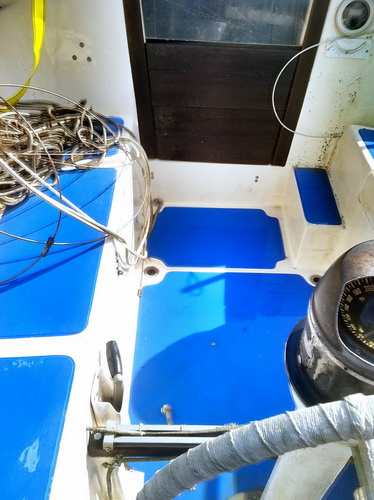

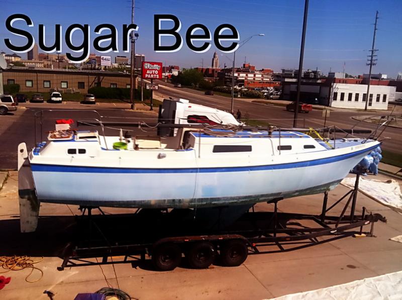

Not new to sailing, but I am new to a helm.
Purchased a Clipper Marine 32 Aft Cabin ketch sailboat with a inboard 8 hp Yanmar diesel, and a helm. The mizzen, helm and inboard diesel is new to me.
I own a sister ship, same length, with tiller steering.
My main question is, what differences will I notice right away going from a tiller to a helm?
Also is the introduction of a mizzen sail going to change the way the boat interacts with the wind to any great deal? I can surmise it will tack quicker?
This yacht also has a fin keel, and my other 32 has a shoal keel.
I like to hear about what it is I will soon be doing, before I do it, so let me know what I am likely to expirence.
Should splash her in two weeks after a bottom paint, buff of the hull, and engine gets checked out.

A helm with a wheel instead of a tiller, does not give one the feel a tiller gives. With a tiller one can easily feel when the boat gets out of the groove. A wheel will not give you that feel and you will have to develop other ways to find the groove. The nice thing about a wheel is when one tacks, you don't have to move everyone in the cockpit around to avoid the tiller. A wheel often gives you a more comfortable position at the helm. Tillers can give you a stiff neck.
The deeper draft will give better upwind performance.
The mizzen won't help upwind and there is probably no point in setting it in those conditions. On a reach, though, it gives you added sail area. I have never sailed a ketch, but I suspect its advantages may be similar to a cutter rig. As the wind pipes up, it gives you more options to keep the boat balanced and moving fast off the wind.

The biggest advantage of the ketch rig is that it allows more trim options with its relatively low aspect sail plan. This means you have the sail area spread horizontally fore and aft, as opposed to a sloop's essentially vertical distribution. On long passages you can balance the rig with a lot of precision because you have so many sails to mess with... genoa, staysail, main, and mizzen... not to mention some other possibilities.
Sailing with the headsail or staysail and the mizzen only (no main) is a popular heavy weather set up.. aka "jib and jigger".
Another option is the ability to rig a mizzen staysail when sailing off wind. A second spinnaker is possible... but you need a bunch of crew to handle all these sails.
On your lake I think jib and jigger would be a cool experience... for you and your crew.... and the onlookers around the lake.
On your ketch... a wheel is practically a necessity because the cockpit appears smaller than your sloop rig, and the rudder post is covered by the aft cabin... but I wouldn't anticipate any difficulty in making the transition between tiller and wheel steering.

To the OP - that is a nice looking boat...congrats.
