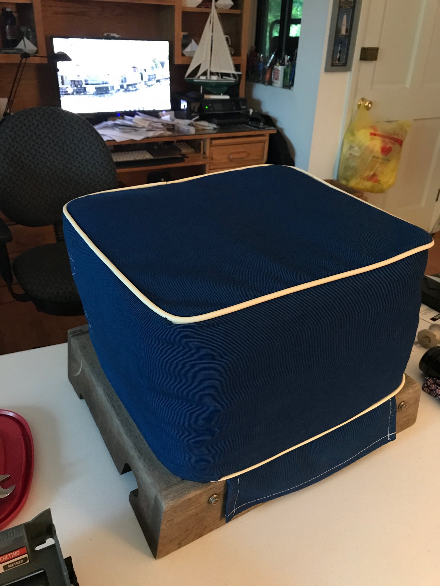

My C30 had the same problem. The helm seat was flat. It had a hump seat cushion that was worn out. I layered up throwable seat cushions until I had a seat high enough. I then took the 4 throwable cushions apart, stacked up the insides and sewed a cover to fit. I ended up with a 12" tall cushion. I talked to a couple of cushion makers like C-Cushions, or maybe even them, at boat shows. They all said they could only make a cushion 6-8" tall max.
Here's a photo of my cushion.

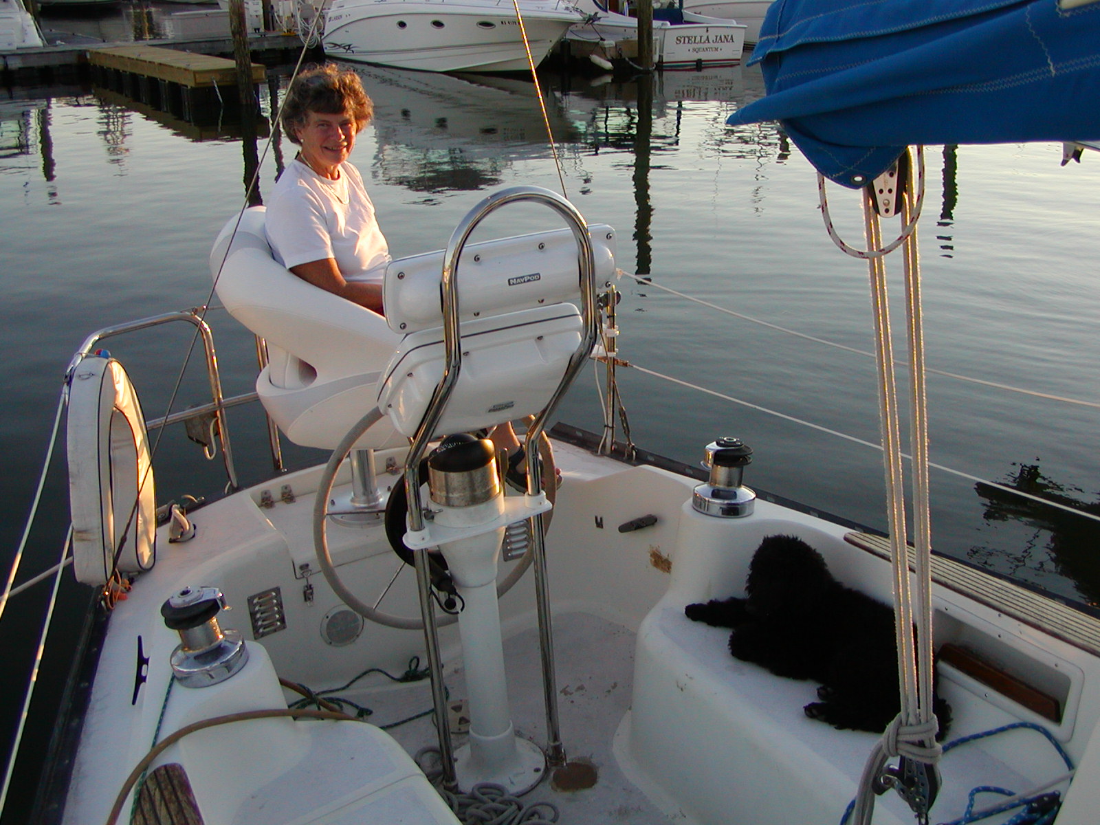

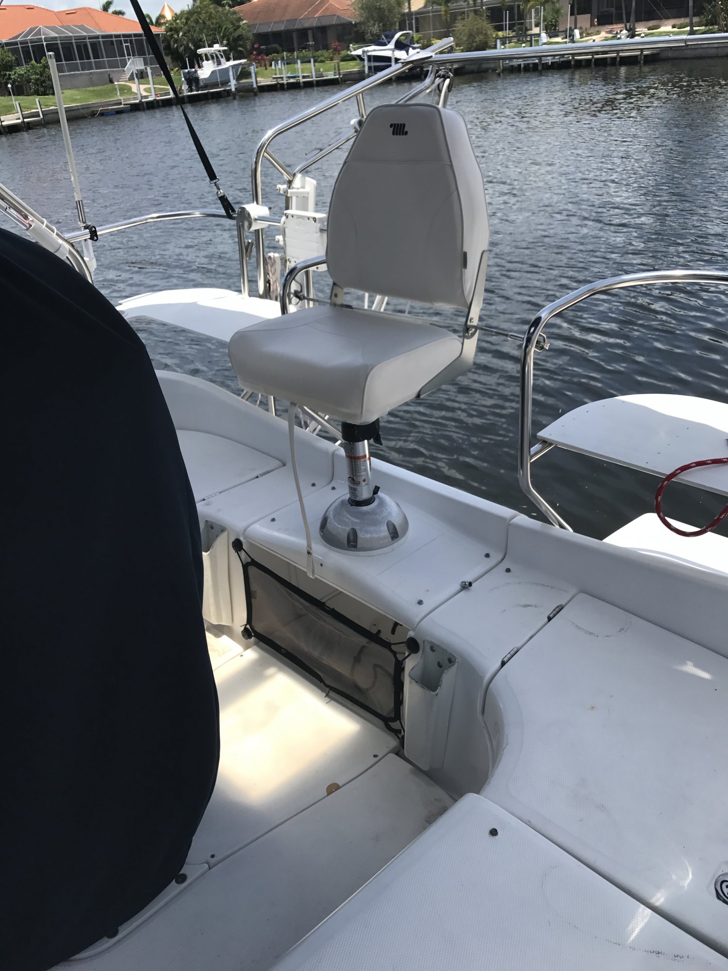

Here was my solution and it works great!
We did the same thing except latter upgraded to a chair with armrests. The beauty of the installation is that the chair and post can be easily removed and the seat converted back to a transom step. To cover the bolts that protruded from the seat when used as a step we used rubber grate tiles epoxied to the bottom of the seat.

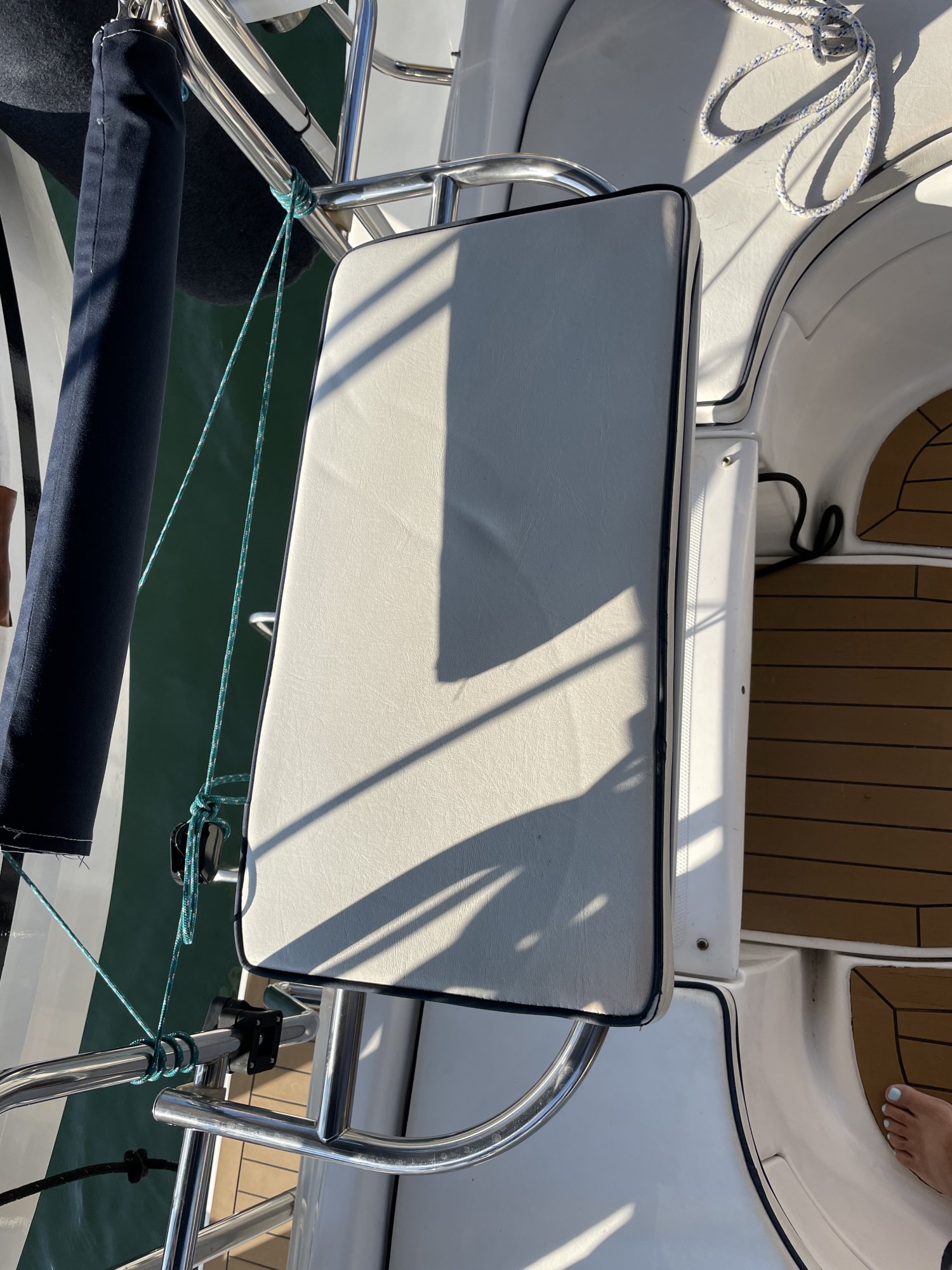

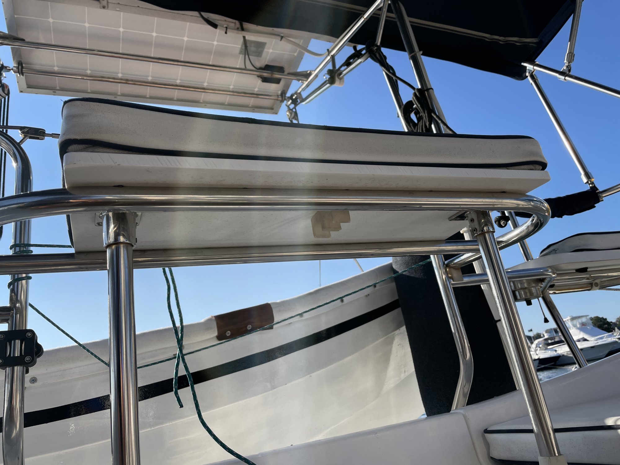

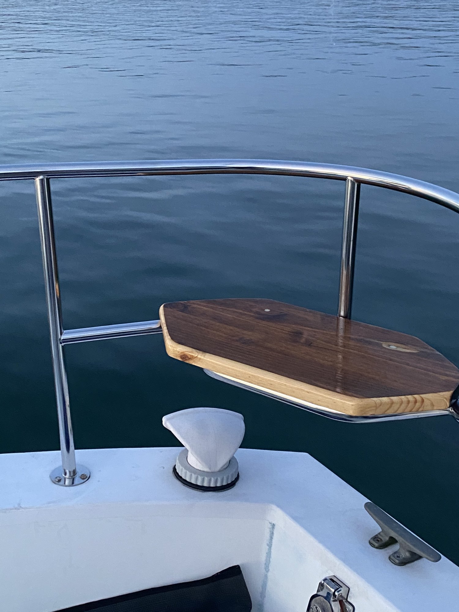

Ditto John's comments. Hard to sit in one spot for any length of time. Trimming, bow sweeps, etc. Our 150 deck sweeper Genoa keeps me on my toes. But, I did make rail seats for our boat port and starboard in order to offer good visibility while under sail. The windward side seems to work the best. Hunter 42 Owner Modifications and Upgrades

I also insist on being able to see clearly from a seated position behind the helm. To this end I installed a proper captains helm seat, tossed the dodger, and raised the head sail so that I could see the water around me. I sail in an area polluted with lobster pots. Regarding the dodger, unless your boat is prone to splash coming over the bow and into the cockpit you would be better off without it IMHO.

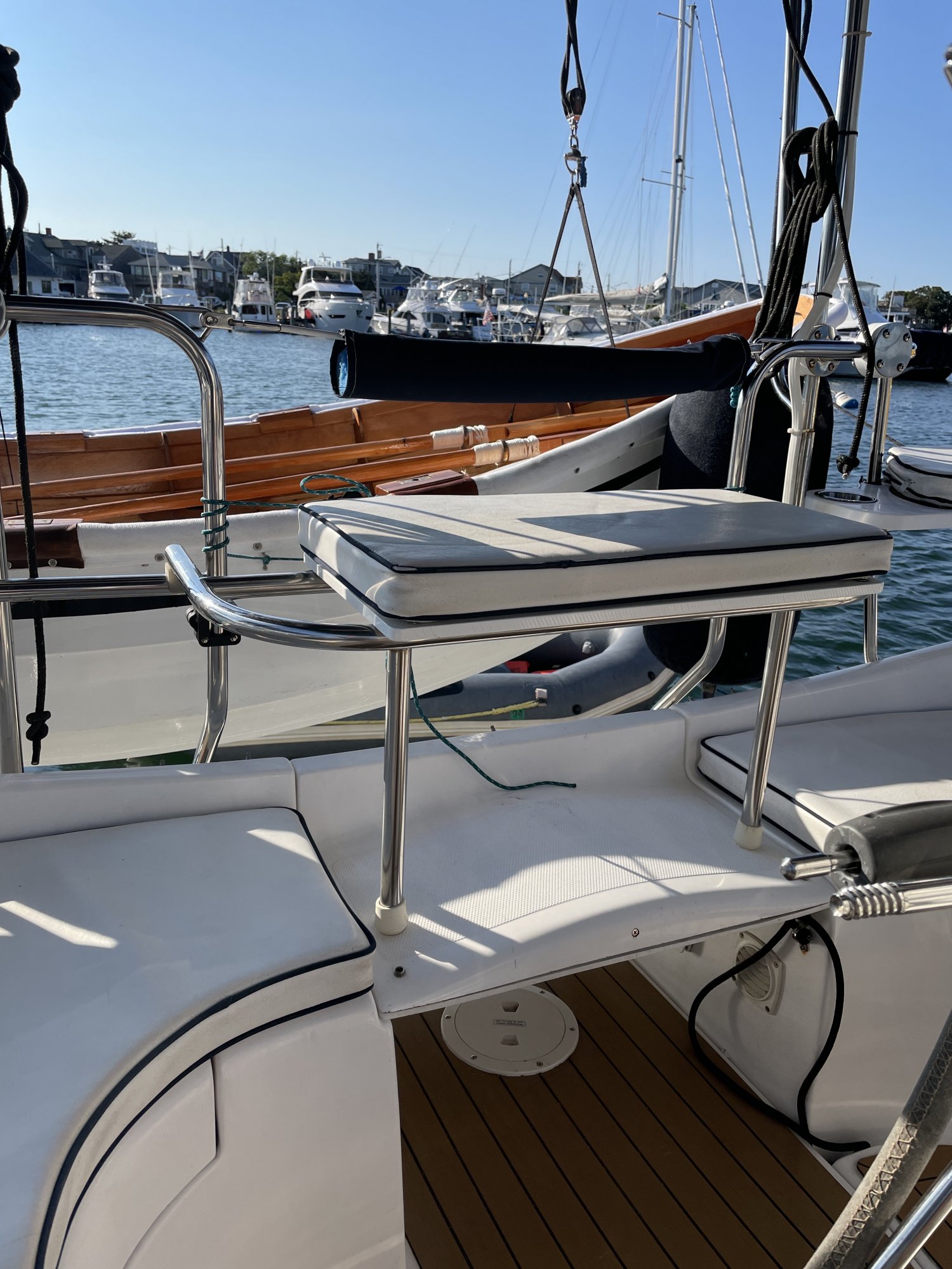

The previous owner of our boat designed this seat for our 08 H36 which we have since also replicated for an 03 H356 with some minor modifications. This is very comfortable for us to sit on as well as lean on at the helm. When we need access to the swim step it can stow under the dodger. Our dodger is very tall so easy to see under even for my over 6 ft tall husband.
