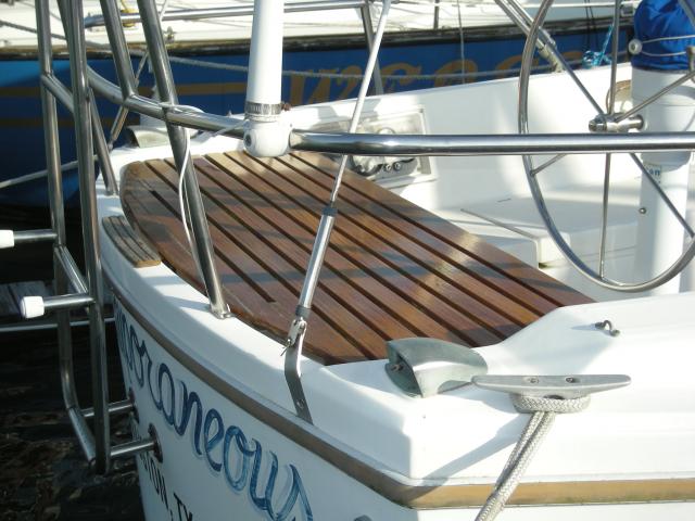

Catalina 30 Seabrook Texas
I built this helm seat because I could not see over the cabin on my C30. It is 1/2" x 1-1/2" teak spaced 1/2" on an aluminum angle frame. Quickly removed for access to the aft locker. The only thing in the locker is the alcohol tank for the stove so I am seldom in there.
I do not like being behind the wheel, that is why I made the helm seat go all the way across the stern. In light wind I sit on the lee side, when the wind picks up I move to the weather side. Sunday, our 5 year old and 2-1/2 year old granddaughters went sailing for the first time. Plenty of room on the seat for all.
