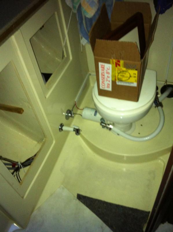

Ciao stretch, in my own hanter the bathroom , and already electric, but i have changed the old pipes with new, and I changed the position of the tanks, the price of diesel has become the one in the bathroom, and the diesel tank and advanced I send you pictures [/ATTACH][/ATTACH]As you can see i still repeat the wall of the booth and many other things, when I put the tanks i sent thee other photos, i have put a motor for the bathroom and one for the tank, IMG_2689.jpg hello.

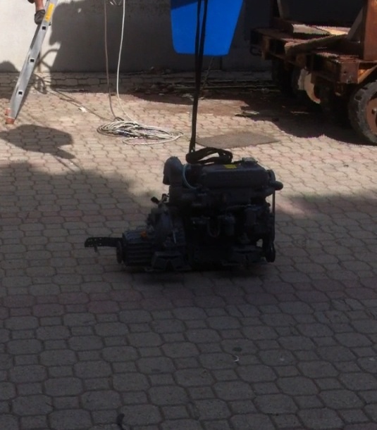

Brilliant Idea, but where i go,there are a few ports to recharge from the dock, i make two solar panels and the diesel engine Yanmar 30 f , but I hope that this technology goes forward , thank you very much for your message and if you want you can write in french ciao

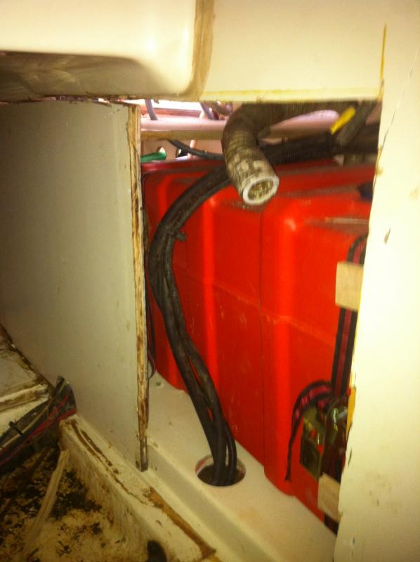

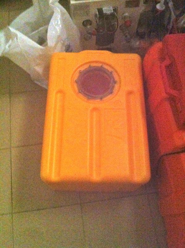

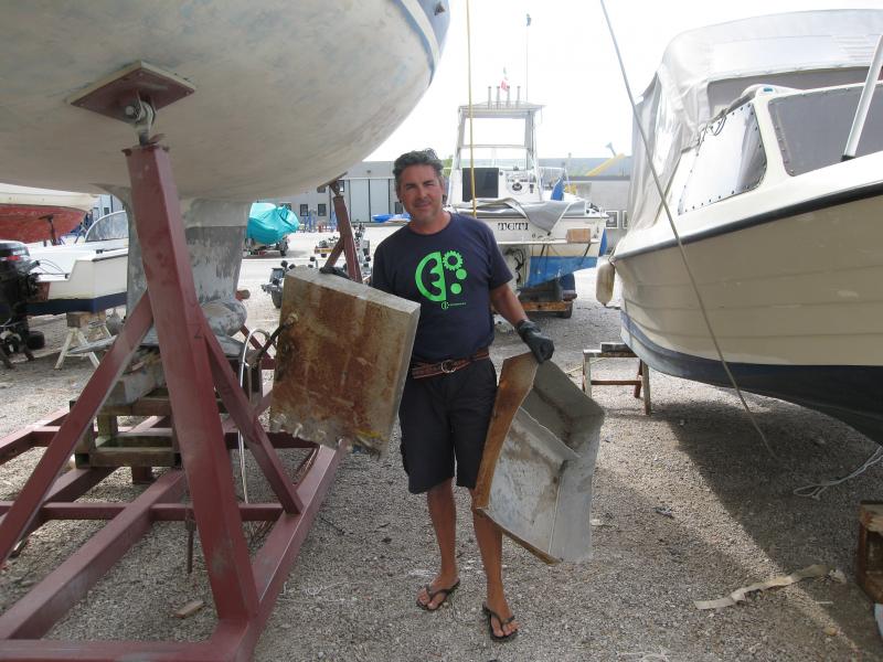

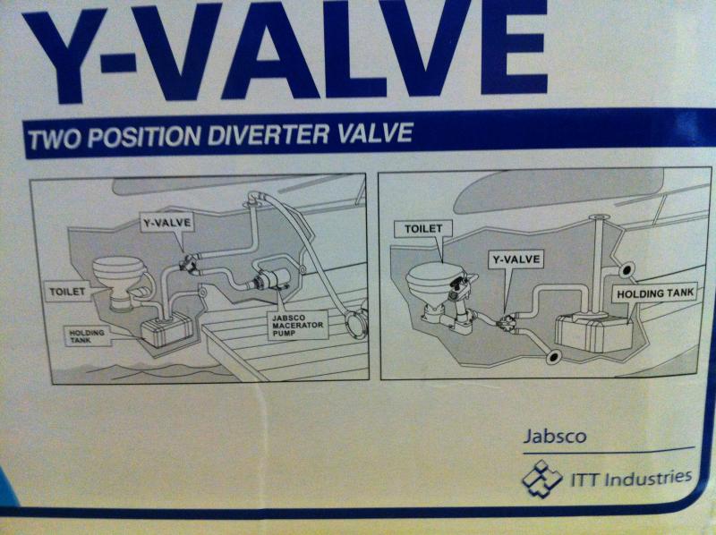

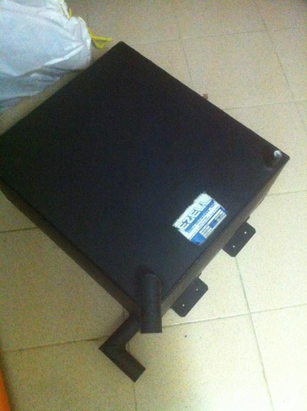

Ciao stretch, he sent two photos on the tank sewage, then I will send thee the project drawings, after you have cleaned the aluminum tank i found signs of corrosion, i decided that I put a plastic tank, more lightweight and easy to change if it breaks,
Will be in place of diesel fuel tank that i had to remove it because corroded and laundry. The discharge will have a double circuit, one of which is directed to the sea, and one in the tank, with a valve to y i choose what to do. I hope I have explained, ciao
Ciao stretch, di mando due foto sul serbatoio acque nere, poi ti mando il progetto e disegni, dopo aver pulito il serbatoio in alluminio ho trovato i segni di corrosione, ho deciso che metto un serbatoio di plastica, più leggero e facile da cambiare se si rompe, sarà messo al posto del serbatoio del gasolio che ho dovuto togliere perché corroso e bucato. lo scarico avrà un doppio circuito, uno diretto al mare, e uno nel serbatoio, con una valvola a y scelgo cosa fare. spero di essermi spiegato,ciao

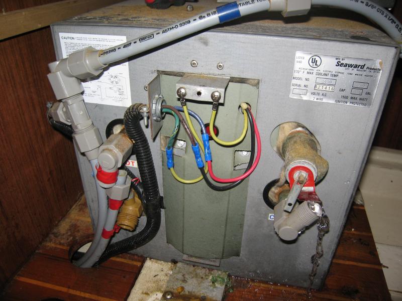

Ciao stretch, thank you very much for the photo, very good idea of the handle on the dodger, you sent a photo of the valve to y i use, with examples on the circuit, my is similar to the one on the right, but with the electric motors for the exhaust. This weekend a nasty surprise, the boiler hot water of the seaward, despite my efforts in the restoration, and died, fortunately is still in production, i found for sale new $300 ! IMG_0017_3.jpg

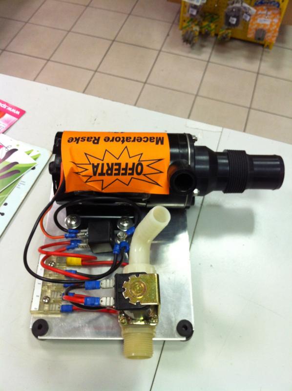

Ciao stretch, if I understand you want to put the macerator under the floor? For the tubes there are no problems, but, the macerator and the valves i prefer that they are visible for a better maintenance, very nice the chartplotter , put him also i in that position, i bought a SIMRAD nss7 with the radar, that brand and the plastic housing that holds the chartplotter ?

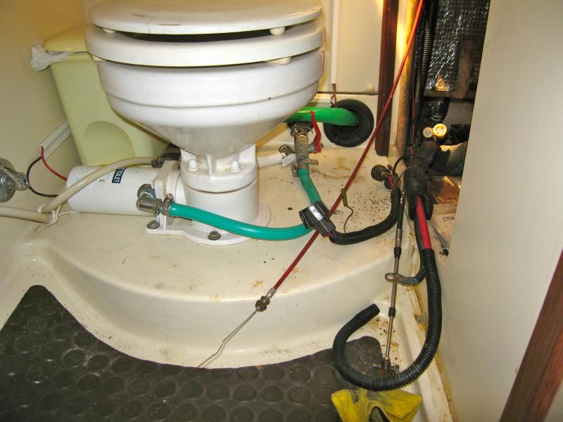

As you can see here i have already changed the tubes, those first were not secure, and as you can see the macerator and view, there are for sale but the better bathrooms with macerator hidden behind the cup, see you soon ciao . image.jpg

Ciao stretch, thank you very much for the photo, very good idea of the handle on the dodger, you sent a photo of the valve to y i use, with examples on the circuit, my is similar to the one on the right, but with the electric motors for the exhaust. This weekend a nasty surprise, the boiler hot water of the seaward, despite my efforts in the restoration, and died, fortunately is still in production, i found for sale new $300 ! <img src="http://forums.sbo.sailboatowners.com/attachment.php?attachmentid=61107"/>
<img src="http://forums.sbo.sailboatowners.com/attachment.php?attachmentid=61106"/>
Are you sure you need to replace the water heater? My Seaward stopped heating on 110 v electric, but I traced the problem to a $5 Temperature limiter switch. You could also check to see if the element is shot, and it is easily replaced as well. Unless the tank is leaking, most of the heating element parts can be replaced. You can remove the cardboard cover shown in your photo, and CAREFULLY use a multimeter to check for electricity at each of the 3 sets of terminals...there is also a red "reset" button that may just need to be pushed in. On mine, the reset switch was shot, but once I replaced the switch...viola! Hot water.

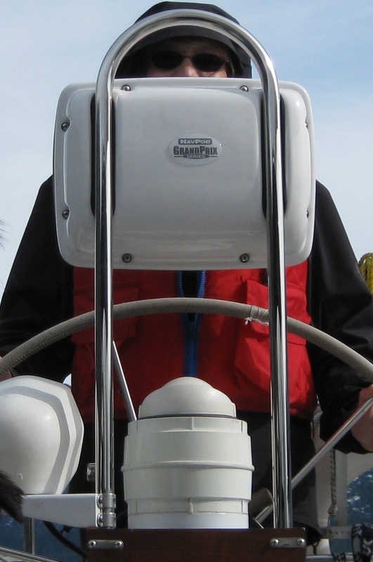

Hi ELMAX, I will get the toilet with the cup to hide the macerator. I will keep the rear discharge like you have, much easier to install. I have a heater in the closet beside the toilet and a warm vent to keep the toilet seat warm, haha
The chartplotter I have is a ''Navpod Gran Prix''. See photo for logo. You have a nice Simrad. Thanks for the pictures.
