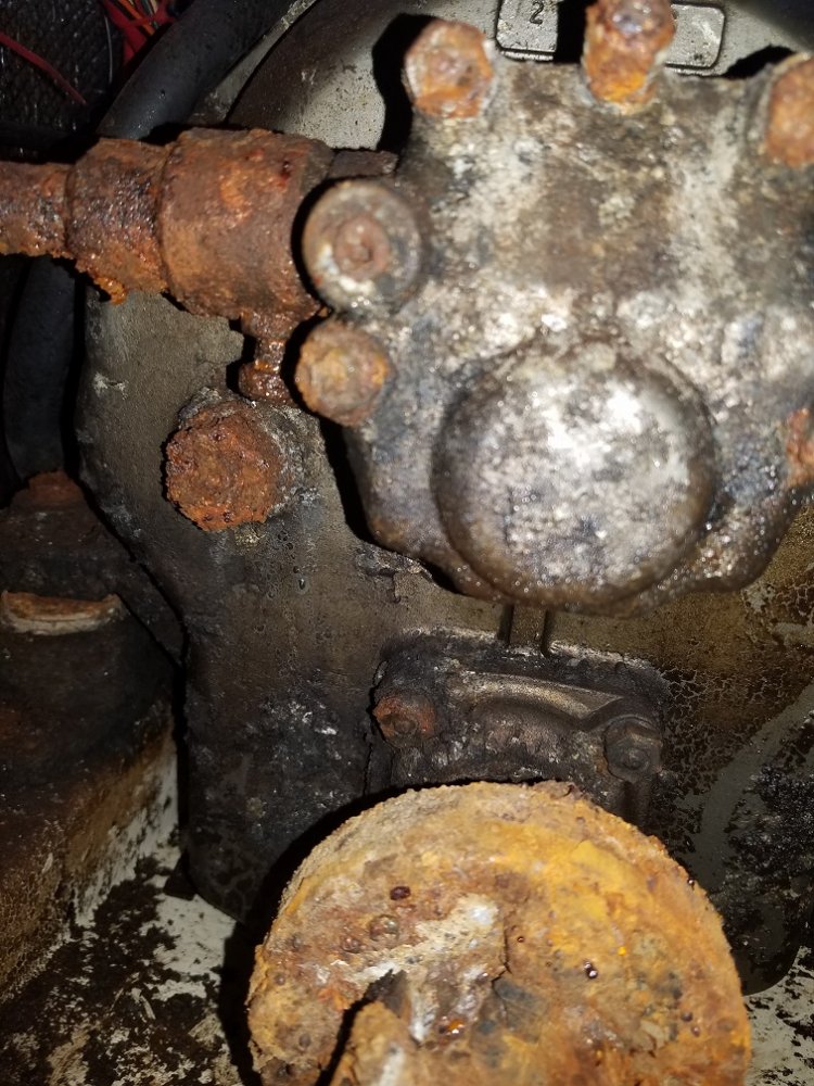

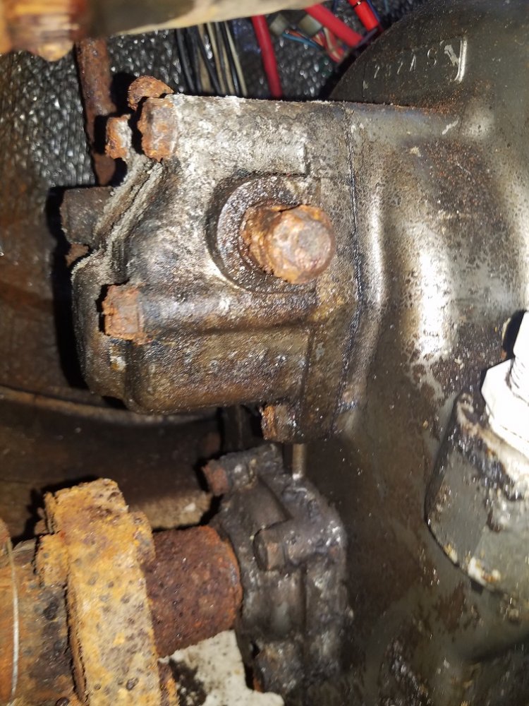

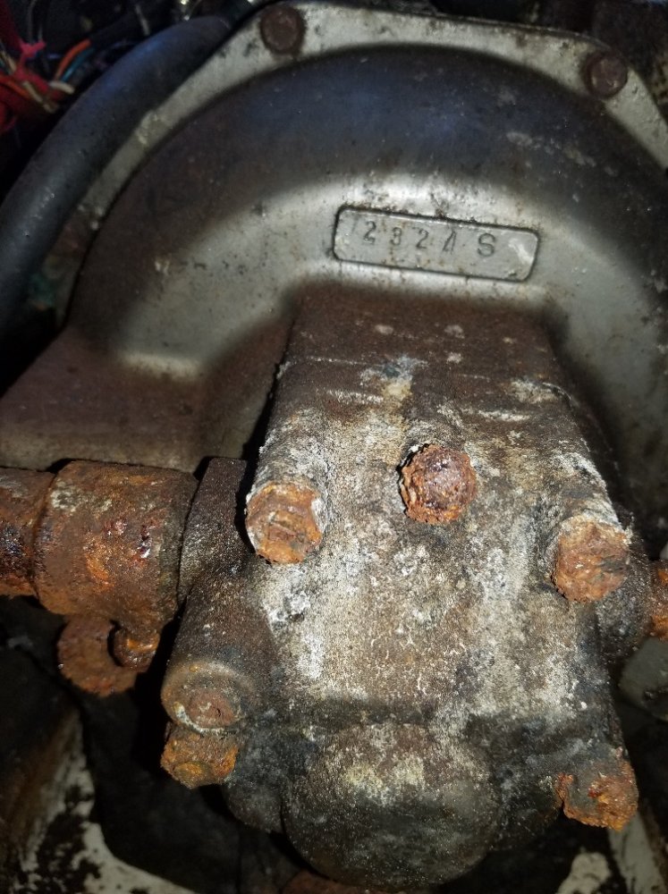

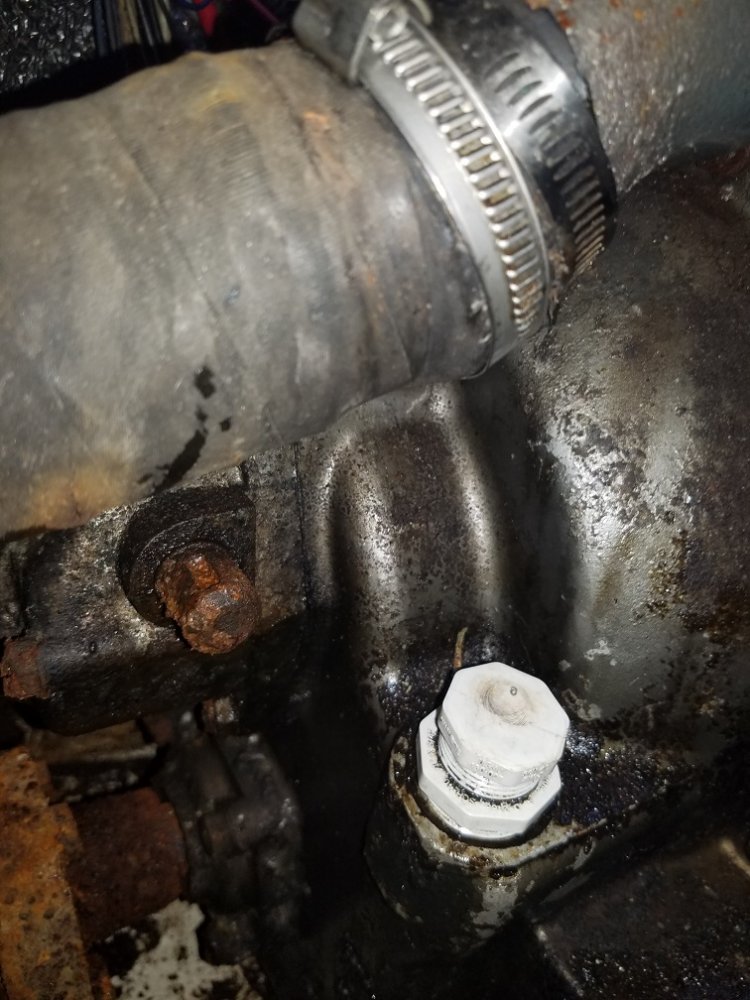

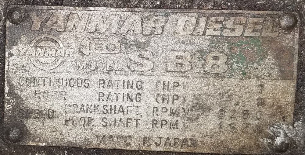

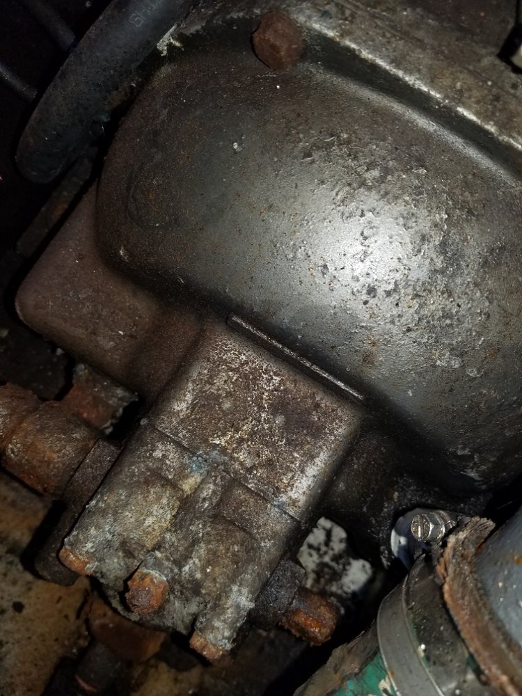

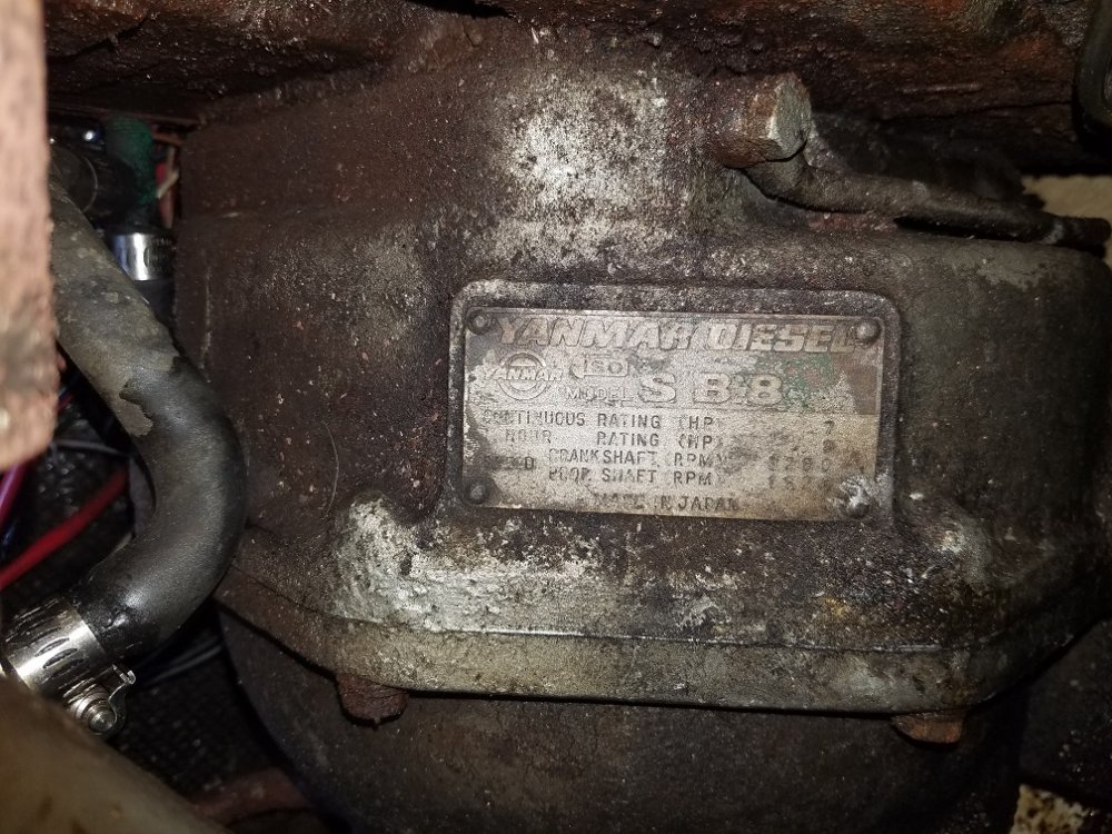

Thank you for everyone that's responded so far. I did make it down to the marina today and took a few pictures of the transmission as I've been asked a couple times for the model number, but unfortunately there's nothing anywhere on the transmission besides the plate pictured that shows SB8 , the horsepower rating, and the RPMs at crank and prop, as shown in the pictures. I even called a local marine yanmar service center in Tampa and they were unable to tell me what model transmission would go with this SB8 engine. I'm leaving in a few days for vacation and will need to take up this project again after I return on Monday 7/2. If any of these pictures help anyone, and they can lend a hand it would be greatly appreciated. Thank you all!

One additional note, I tried the Lucas transmission stop slip with hopes I'd at least be able to see some forward movement, but it did not make any difference after pumping out the old fluid and replacing it with a mix of new oil and the Lucas additive.
