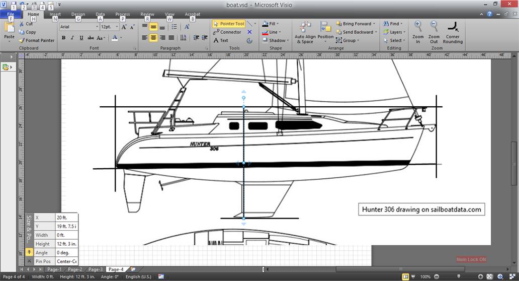

Whenever I need to make any measurements on my boat, I go to Sailboatdata.com. They usually do not have the data I need but enough data to move the line drawing image into Visio. Then I can scale the boat accordingly and get a pretty good picture of what I need.
Based on this, I measured the height of the boat from the keel to a few inches about the coachroof as 12' 4". I would give about a foot just in case. So, say 13'.
Again, not an exact measurement, but based on the 5.33' keel to waterline data.

There was no specification of keel, just draft of 5.33'. The image looks like a wing keel.

Measure twice, cut once.
This time I measure from the LWL of 29.92' and have a value of keel to top of bow pulpit of 11' 5.25". So I am pretty sure that given fudge room, 13' should be about the correct figure for overall height. I used the bow pulpit because it rises higher than the coach roof. But your mileage may vary.
