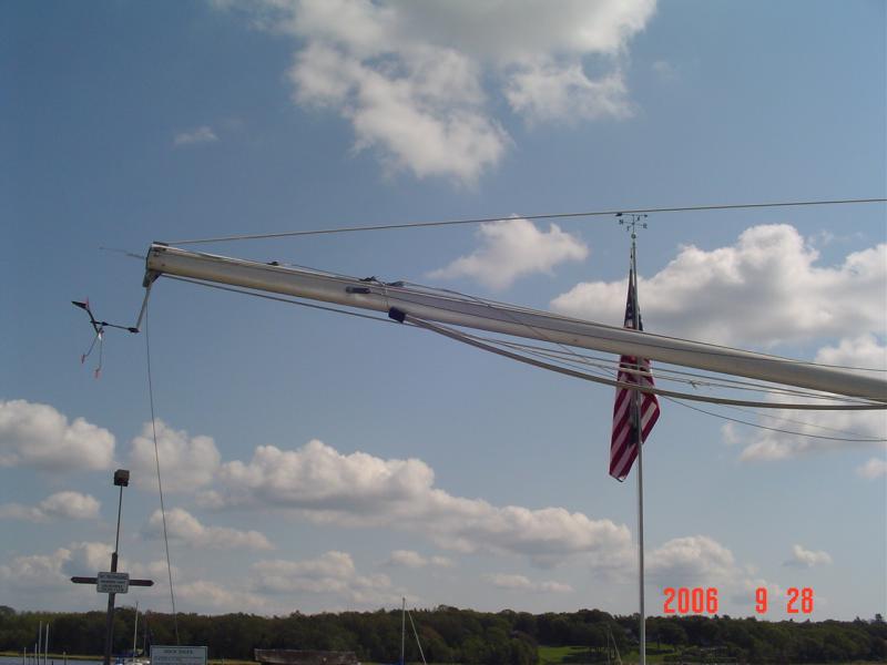

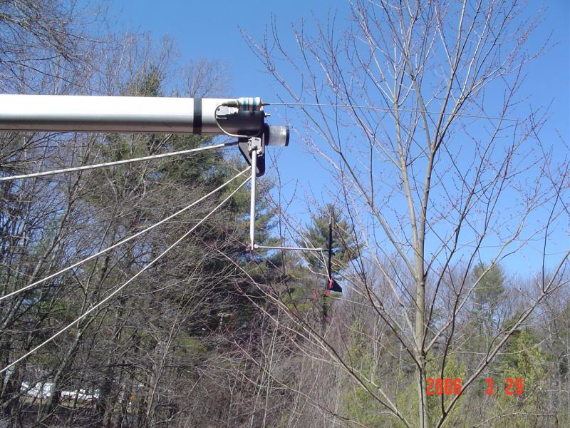

Probably one of the most important things you need to have is a good wind indicator and I'm not talking about yarns attached to the stays.
Davis makes a great Windex wind indicator that has a "V" shaped vane attached to it. I bought one years ago and attached it to a 12" extension bracket and mounted it at the top of my mast on the Port side.
These things are great especially when sailing downwind which can be scary if the wind gets behind the wrong side of the sail and causes an accidental jibe. The Windex can alert you before hand if you are keeping an eye on the pointer in relation to the "V" shaped vanes.
