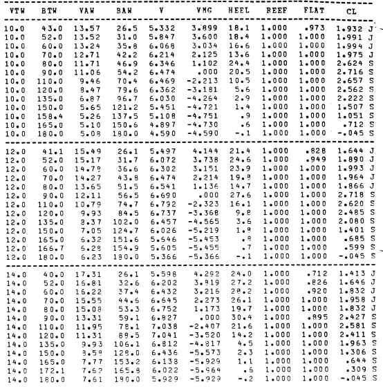

All boats are different and proper heel angle changes with wind angle and wind speed. Attached is chart of wind speed, angle vmg and heel angle for my C&C 29-2. To decipher, VTW=True wind velocity, BTW- true wind angle VAW=apparent wind velocity, BAW apparent wind angle, V=velocity, VMG= velocity made good, HEEL ANGLE. This is very instructive as to proper heel angle. Notice that heel angle increases until about a 50 degrees apparent reach.

What vintage is that data?
The first set of polars I had for my Cat30 looked like that. I had new ones run under the newer VPP that US Sailing uses. One of the differences is that the VPP shows 23.4 degrees as a limit for best speed, the older polars showed up to 27 degrees at optimum speed/angle.
The new polars show the speed and heel angles for both Jib/Genoa and Spinnaker for BTW over 60 degrees. It is easy to see that flying the spinnaker increases heel for a small gain in speed in a breeze. When Wench is aboard I use a set of numbers that keeps heel within her comfort zone and I still get to "fuss" to hit my numbers. Keeping heel under 15 degrees won't win any races in my boat, but it sure makes momma happy!
23,353

The polars are an excerpt from my old ones circa 1992. Actual optimum angle of heel is about 23 degrees. I've always wondered how you could tell 23 from 25 degress as you are bouncing along in a seaway. Usually when I get close I adjust heel angle to knot meter readings. My wife used to call the clinometer the scream-o-meter. Fortunately she has gotten over it and doesn't pay much attention to it anymore.

I had the bow pulpit built so the forward legs are vertical at 23 deg of heel. :)
When the legs are vertical I know that I need to pay more attention and keep from sailing at more heel than that. My dad is an old "rail down" guy from the skinny, low freeboard boats he grew up with. "Rail down" was about 20-25 degrees on many of those boats and a good indicator. For tall, fat boats like the C30 rail down is too far and slow. Took me a few days for him to see the difference by forcing him to compare knotmeter readings his way and my way. :)
