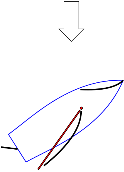

Handling a MOB situation will require boat handling skills dependent on the situation. It is beyond the scope of a discussion on the Hove-To skill.
Heaving-to is a great tool to have in your sailing skills tool box.
I think of it as putting the boat in a stall and sliding sideways slowly.
Here is the configuration of the sails and rudder. The forces involved are:
  1. the wind on the foresail trying to push the bow down to lee, (to the right in the image)
  2. the wind in the main trying to push the stern to lee and also tying to move the boat forward
  3. the rudder trying to turn the boat into the wind.
That is the set up. You work with the three forces to balance the boats movement in a stalled position. Going what feels like no where.
But that is only what it feels like. Actually the boat slides in the water down the wind direction. Think of it like a car on a slippery boat ramp. The breaks are all on, the wheels are spinning and the car is slowly sliding down the ramp towards the water.
Your concern of "flipping the boat over" are relevant in a small unstable boat. In your big keel boat it is highly unlikely.
Unless you are going out in winds exceeding 60 mph and waves the size of a 2 story house, then yes it is possible. That would be a time when you might want to have more skills than hove-to.
YES.... Go out and practice the set up and the skill. You will know you have mastered the skill of balancing the 3 primary forces when you see the boat wake moving up wind as you slide down wind. It is a great skill to know and you will find a variety of times when you will use it, if for no other than a few moments to catch your breath during a challenging passage.

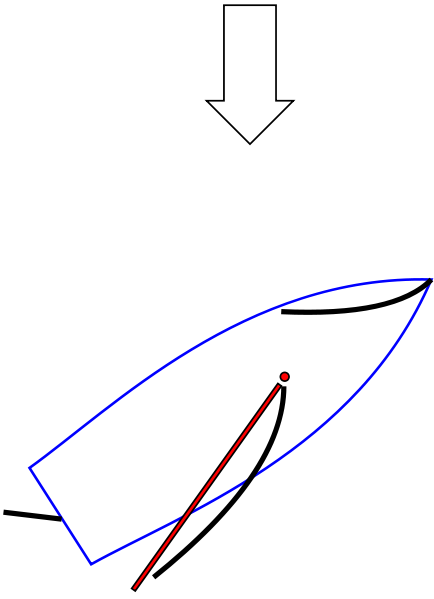

We are still on the waitlist for Everett. I am hoping we get the call in a month or so, that way I will have better daylight to work with. The more I think about my friends comments about a stuck headsail the more I think he was just encouraging effecient tacking! ha
I will certainly be practicing this!
