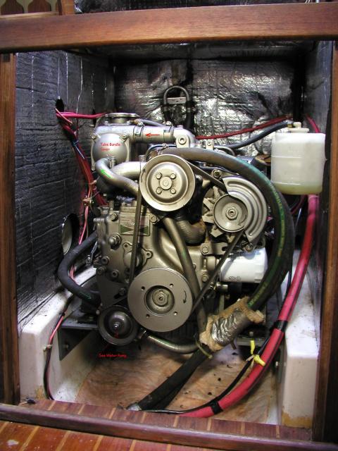

Water Flush
My tee flush fitting on the 3GMF is in the line going to the heater from the thermostat housing. You can see the little black cap on the tee just to the left of the coolant overflow tank mounted on the sidewall. On the aft most hose on my engine; put there by the P.O. I agree that it doesn’t have to be done every year, especially if you keep good long life antifreeze in it. Every two to three years is fine, when you change the coolant. I also agree that it doesn’t make a whole lot of difference which hose it is in but ya need to drain the block and exhaust manifold, using the petcocks, before you start to flush.
