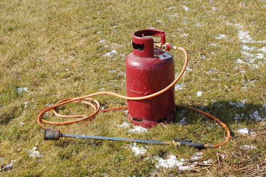

Here in Texas that 'weed burner' is called a 'pear burner'. To burn spines off the prickly pear so the cows can eat them. Works great for starting brush piles also....
That's where I got mine. Originally it was used on a roofing job. I can't remember whose roof now., flat roof with rolled asphalt material a carport or shed maybe. But it does an awesome job along a chain link fence.
