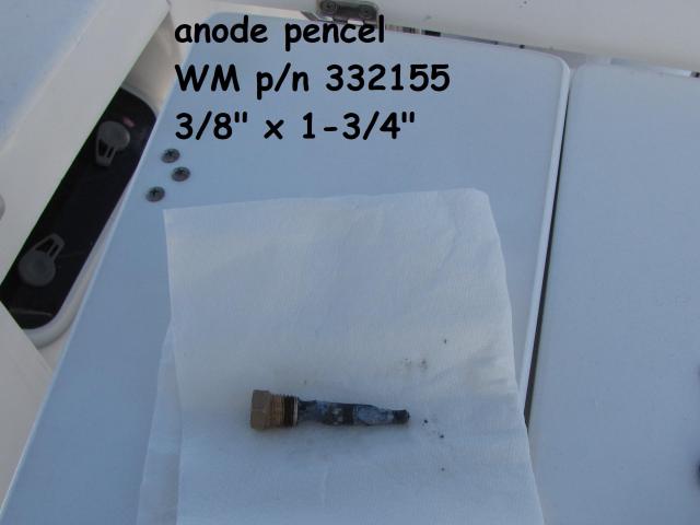

I believe I have answered my own question. http://www.boatzincs.com/engine-sizes.html
According to this E0 should cross to 011885. It is called a NPT 1/4" zinc but the shaft actually measures 3/8" in dia, we will see if it fits.
Pulled the zinc, nothing left after 3 years in the mid Chesapeake. Pulled the end off the X and nothing but a white slime. I flushed and replaced. Beware even in brackish water.
