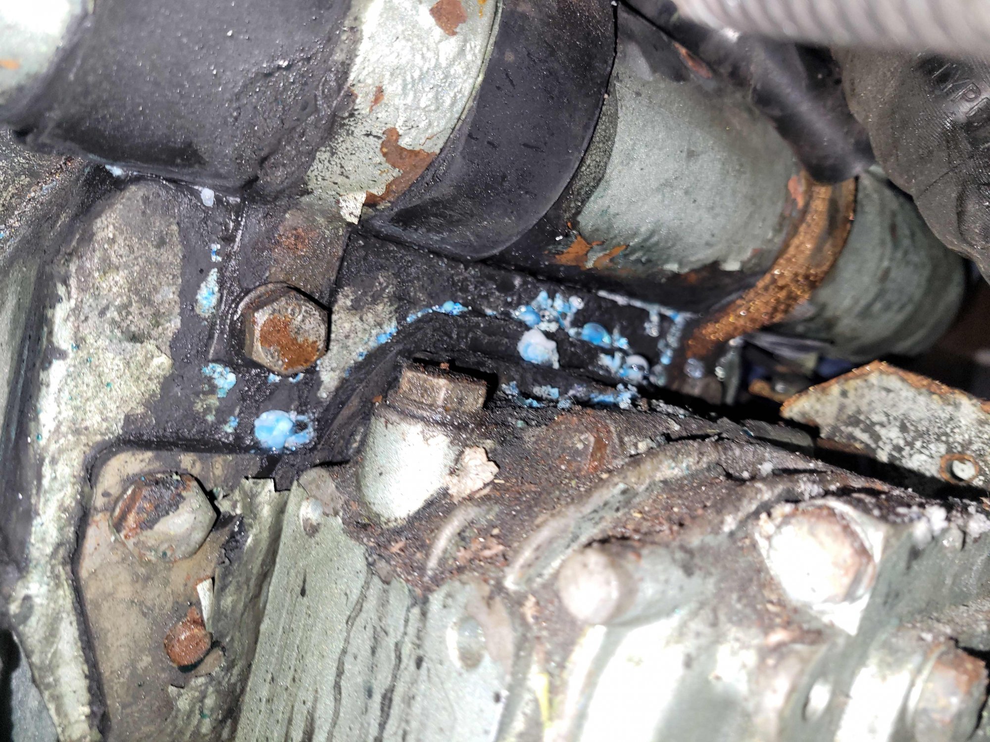

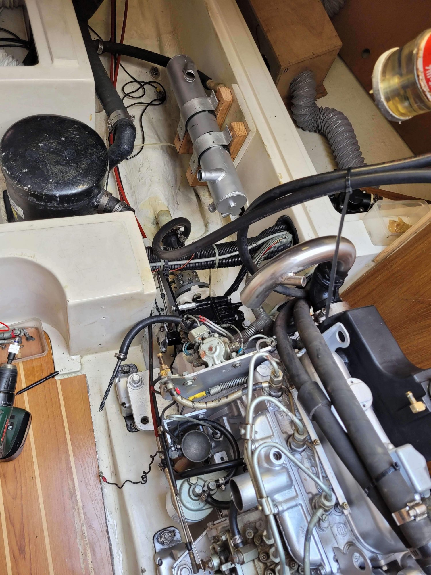

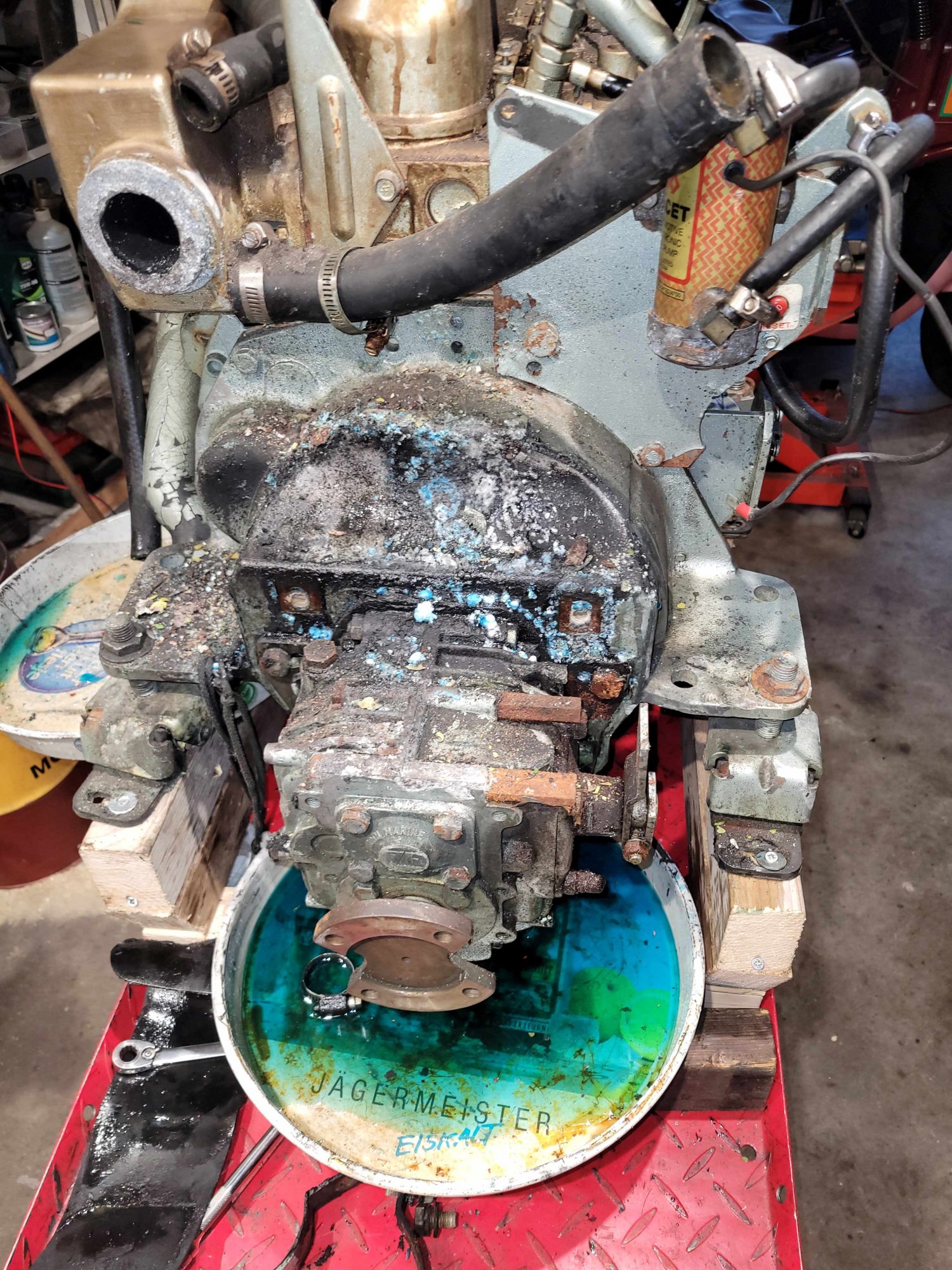

While rebuilding the engine i thought that the heat exchanger could have a better place for the rest of his life...
brackets were broken off and sheaved through the housing. left a mess on the engine.
now you can easely check the transmission oil, more space around exhaust hose and if it leaks , it's not on the engine.

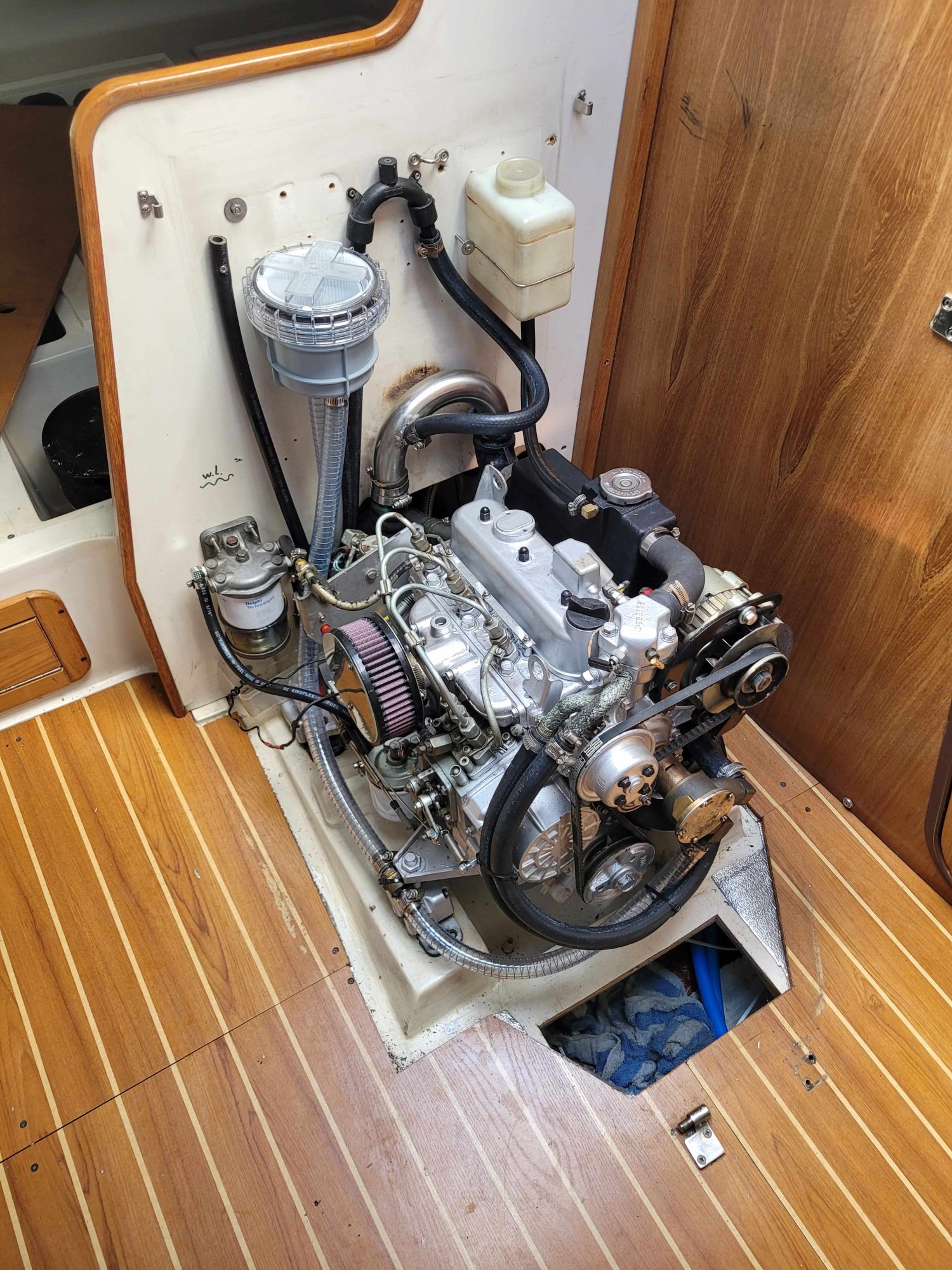

also water strainer in the engine room. (above waterline) and some re routing of hoses.
all for more acces at maintenance.
