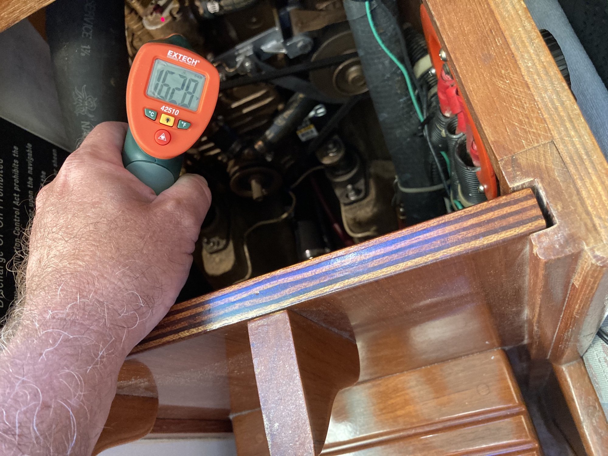

When measured with infrared gun at one point at cruising speed, when at 180 at the thermostat housing and elsewhere, coolant pump intake was 145. So the HX is reducing coolant temp by 35 degrees.
Is this normal or is the HX underperforming?

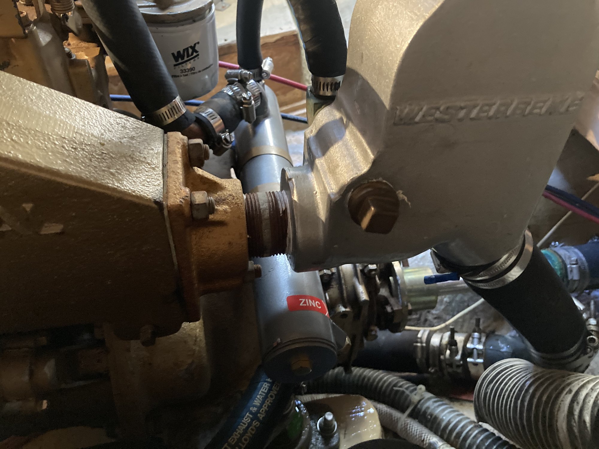

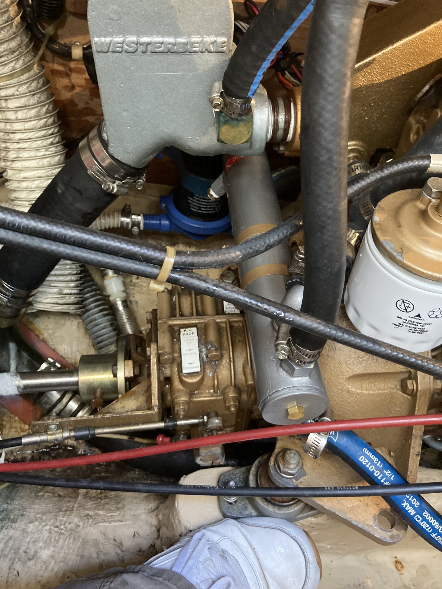

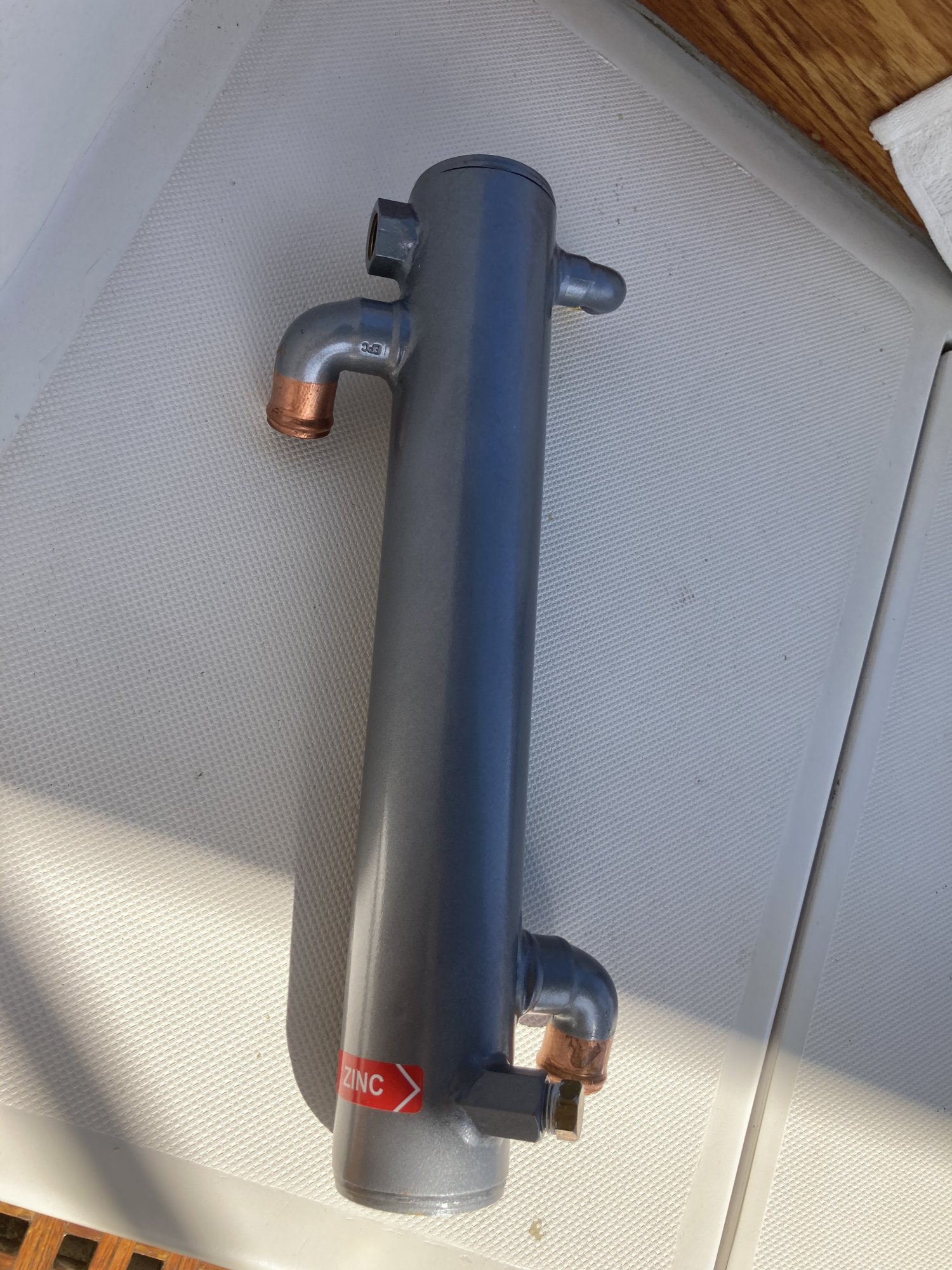

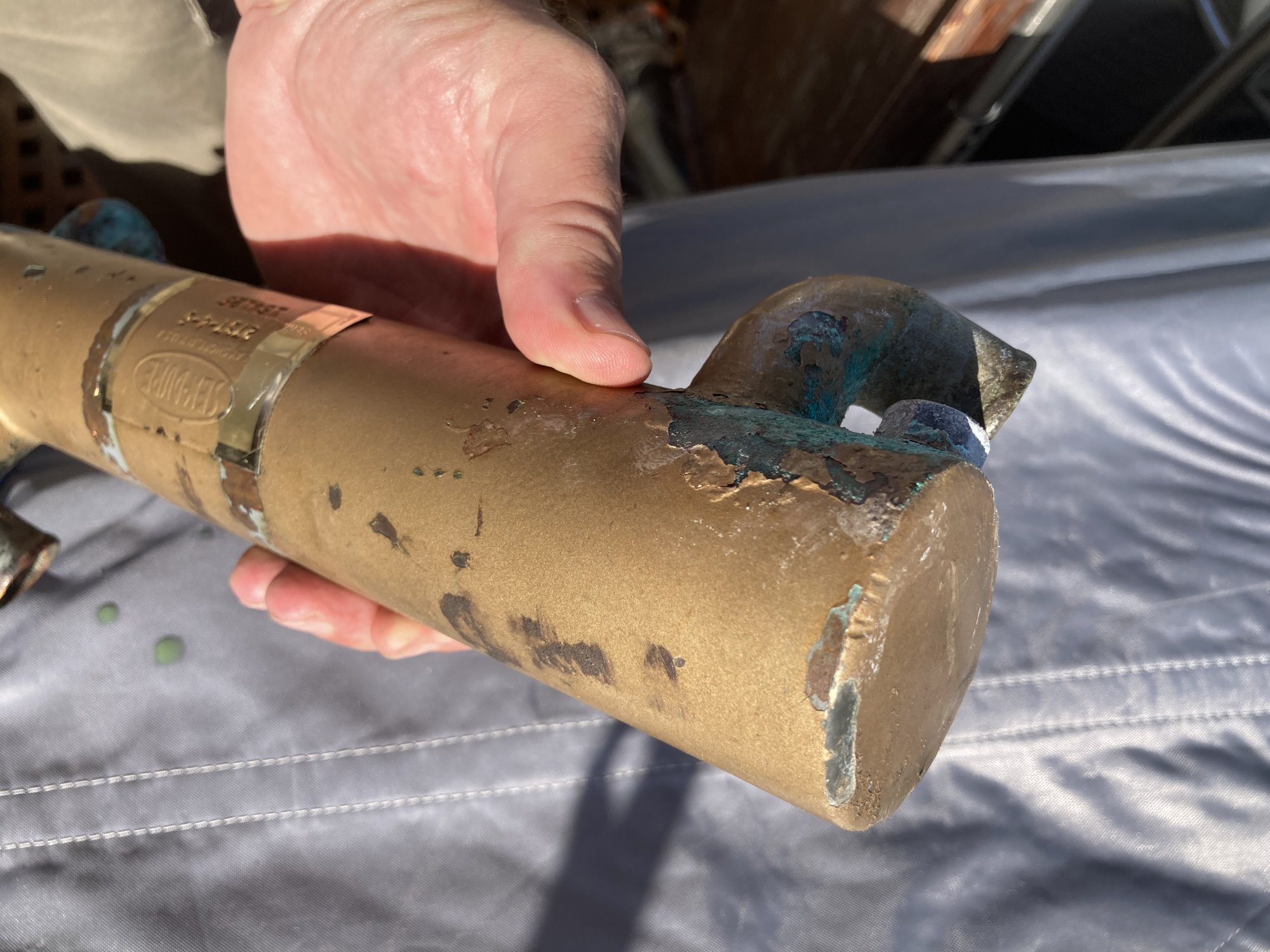

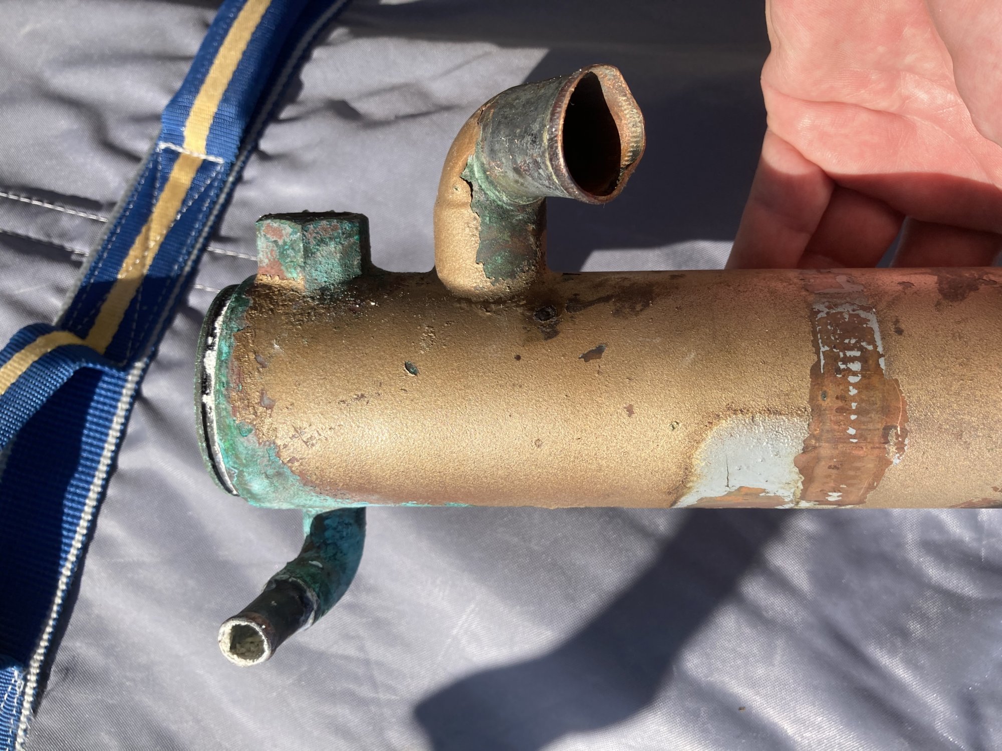

Update: I replaced the heat exchanger.
It was $100 to acid wash the old one and repair a couple of the hose pipes which were oblong from the factory (?), which restricted flow and caused salt built up there which I had to clear out every 3 years or so.
For $275, I obtained one from Mr. Cool.
There’s a lot going on there:
1. It has end caps on both ends. The old one only had one end cap, with the end containing the zinc pencil enclosed. This resulted in broken zincs piling up in that end, blocking flow. Had to remove the HX every few years to shake it and clean them out by poking with a screwdriver.
2. The zinc is bigger, which not only will last longer but might reduce the chance of their breaking off.
3. The hose pipes are round :).
4. It’s new, so clear of calcium and any coolant clogs.
5. I think the zinc mount threads on the old one were getting stripped. It was blooming salt.
6. The new zinc location is slightly farther from the hose pipe on that end, making zinc removal drastically easier.
7. The new one looks much better.
So the extra money was worth it.
Pics of old and new attached.

We have confirmation of a cure. :clap:
After 1 hour running, all is normal.
The problem was the HX, due to calcium buildup.
See pics.

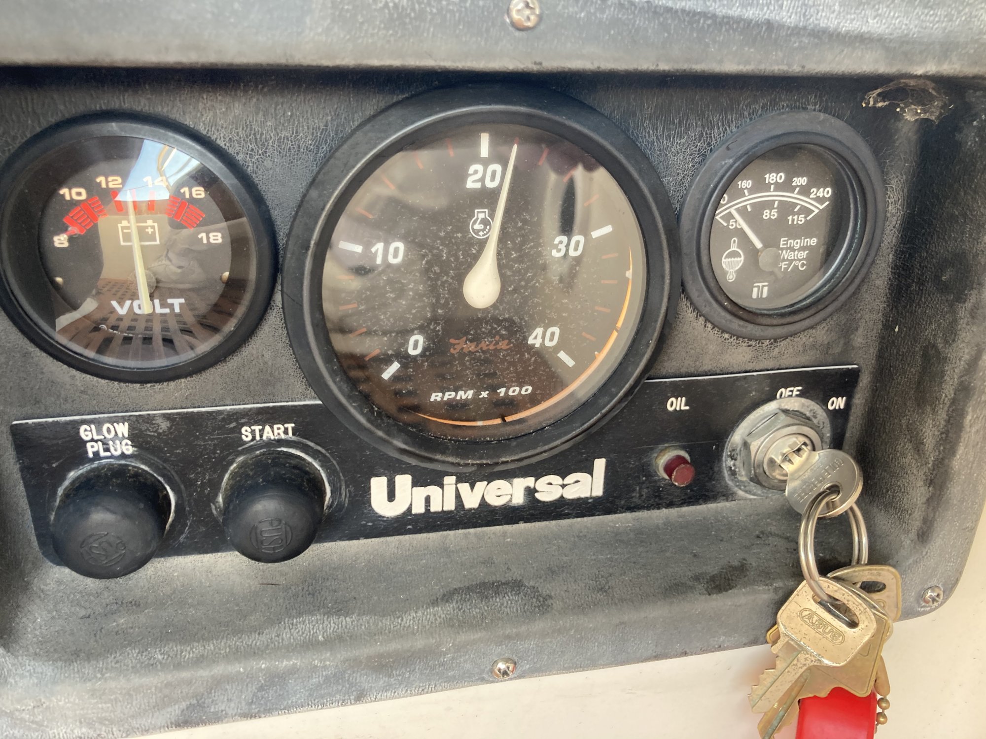

140 at the gauge equals 165 at the thermostat. The gauge has always been off, 10 years of my owning it, but it has always been perfectly reliable. So I know that if it goes over “140”, the motor is operating out of character.
