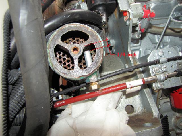

While checking my HE zinc last couple times I found them broken off from the screw in fitting and laying flat.
When I replaced the zinc this time, the HE end cap was off and discovered why they were breaking, the zincs where too long...........cut approx. 1/4 " off.
