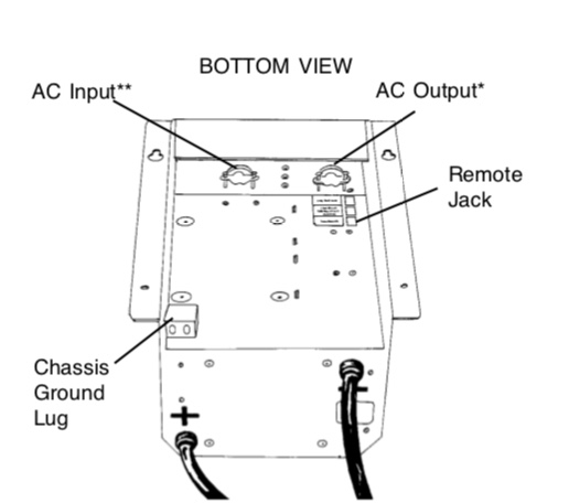

The older black models did not have a temp sensor option. The port for the remote control is on the bottom of the unit. On the remote control you can set general ranges to simulate your battery average temperature but, this is not an on-battery temp sensor. The Link series remotes were discontinued many years ago and only the basic remote may be found as new old stock.

Hello!
I found a picture in the manual that shows three connectors at the bottom of the black freedom 10 but no descripion about it. So i thought it's possible to connect a BTS - isn't it? I am 300km away from my boat and can't check it now.
