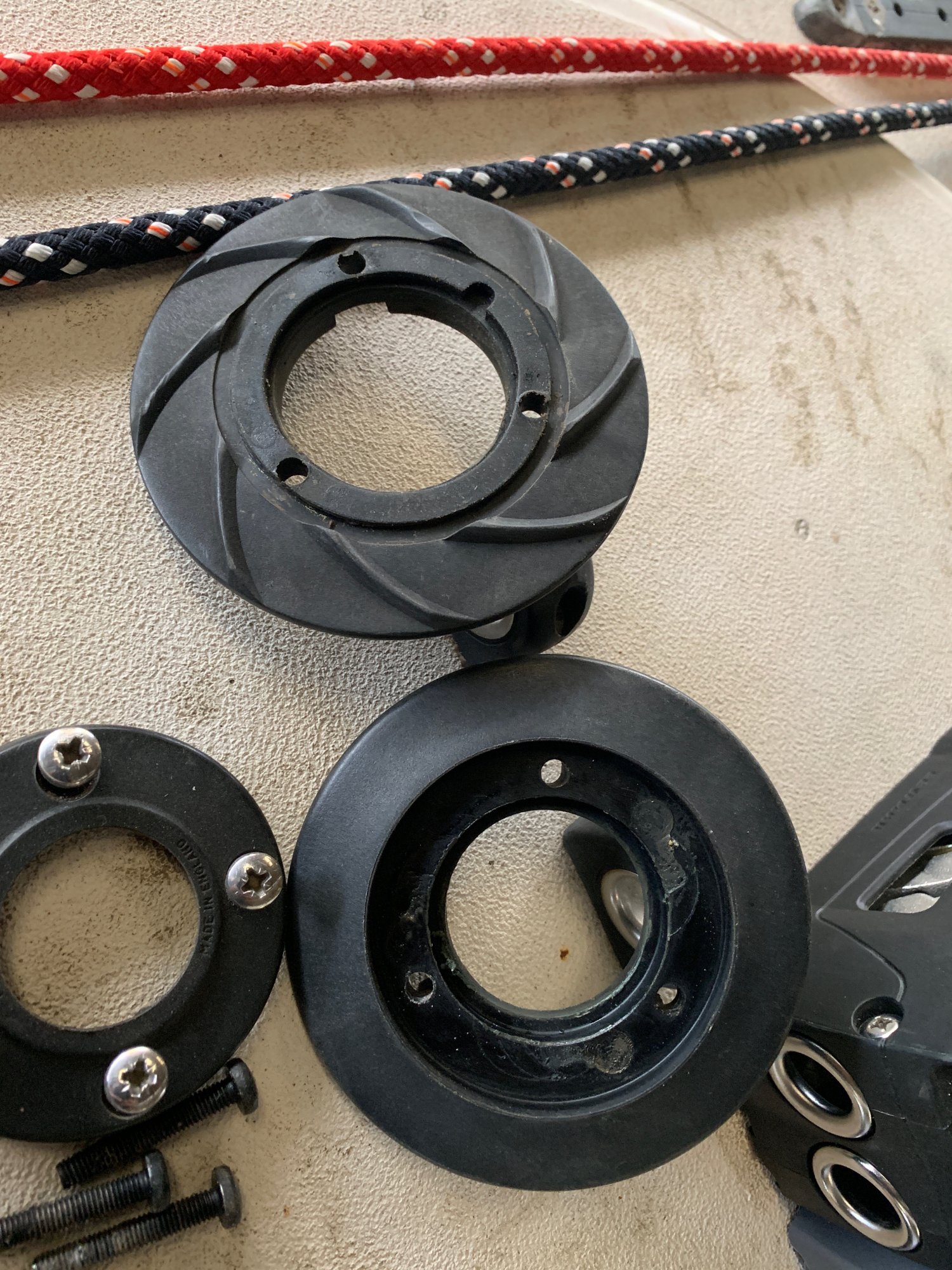

I always have to hold the tail while winching or the sheet will slip out of the teeth.
Try new sheets that are a size larger than the sheets you are using. If you are using ⅜" sheets, go to 7/16". The sheet size has to match the winch self tailer.
Jun 25, 2004
1,109
I’ve tried everything and nothing solves the problem.
Check the diameter of the line first, compared to the specs on the winches.
If the line is still slipping, the jaws are probably worn. Replace them. Look at the pic below. If you look carefully, you can see some worn spots on the raised ribs of the jaws. Some brands call the parts jaws;
other brands call them crowns.
c
14,190
After posting an earlier response to this comment, I realized there are 3 possibilities, the sheet is too small, the jaws are worn, or the sheet is too large. If the sheets are too large for the winch, they will tend to slip out of the jaws. Larger sheets are easier on the hands, but add extra weight and expense. What size sheets do you have on the boat? What size winch? For a 28' boat, ⅜" or 7/16" sheets should be adequate. Half inch will be easier on the hand, but may not fit in the jaws as well.

I’ve spent a small fortune on sheeting this year. Three different diameters and they all slipped. All three where within the specs. I’ve tried several different positions with the stripper arm. The jaws seem to be fine but may be the culprit. The starboard winch holds a little better then the port. Ive been meaning to swap the drums and see if it makes a difference. If so then I will know the jaws are the culprit. My winches are Harken ST16 single speed.

Thanks for all the feedback. I think I will go with the 135%. As far as the winches I just swapped the drums. Previously the starboard one held the sheet pretty well. Now that there swapped the port side grips. So it appears the jaws are worn one side more then the other. Looks like I will order new ones along with a sail.
Dec 27, 2012
587
Precision Precision 28 St Augustine
I apologize for the topic going from headsail to winches but I wanted to follow up on my winches. Thanks to the above advice I determined that the jaws on my Harken ST16 are worn and causing the sheet slippage. I pulled the drums and realized that the drum and lower jaws are one solid unit. Apparently a newer version allowed the user to replace the jaws. I contacted Harken and learned they have a upgrade kit that replaces the upper jaw only. The price for a pair was $400. The Harken rep was very honest and advised that the older 16s never worked well. I decided to throw in a boat buck and replace my winches. I read good reviews on Anderson/Ronstan so I bought a pair of 18 ST. They came in the other day and look to be very well made. I won’t know until next season.
