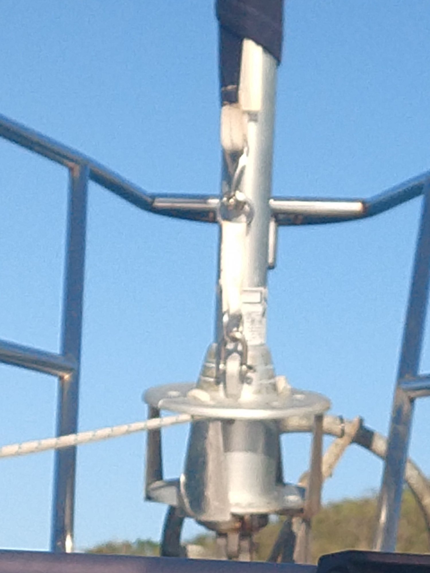

Over the winter I had a new headsail made. The luff is about 6 inches shorter then the one I’m replacing. I’m having a problem with the halyard getting wrapped around the top of my harken furler. I originally thought it was the rode inside the drum. I replaced the furler rode and realized the problem was what I described. Im thinking of making a bridle (terminology?) between The sail and furler drum. I’m thinking that will raise the sail height and hopefully solve my problem. Has anyone else done this? The only alternative I can think of would be to add a block on the mast below where the halyard enters the mast. The first option seems a lot easier if it works.
