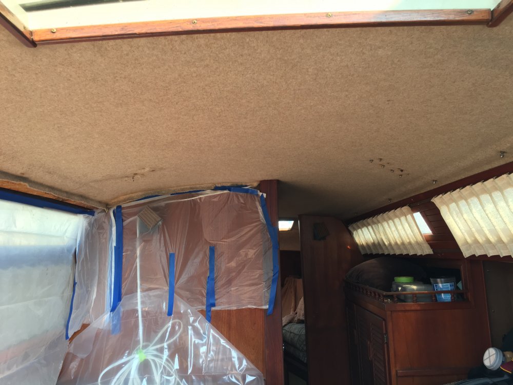

As a part of my recent investigations into the depression in my deck next to the mast I took the trim down in front of the bulkhead and peeled back the head liner, which was sagging anyways, there and in the vee birth. I had bought the 3M spray adhesive to fix it years ago. I maked off the interior, sprayed both the fiberglass and the back of the headliner, and rolled it back into place using my metal roller for fiberglass work. Note that I didn’t do any prep at all to remove old adhesive. It went up perfectly and looks mint!
