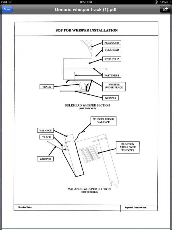

Searched a lot on this forum on tips for removing the headliner from Hunter sailboats. Most were very helpful.
I came across this schematic from Hunter and wanted to post it to help go along with the narrative that others have posted.
Hope it is of use to someone!
