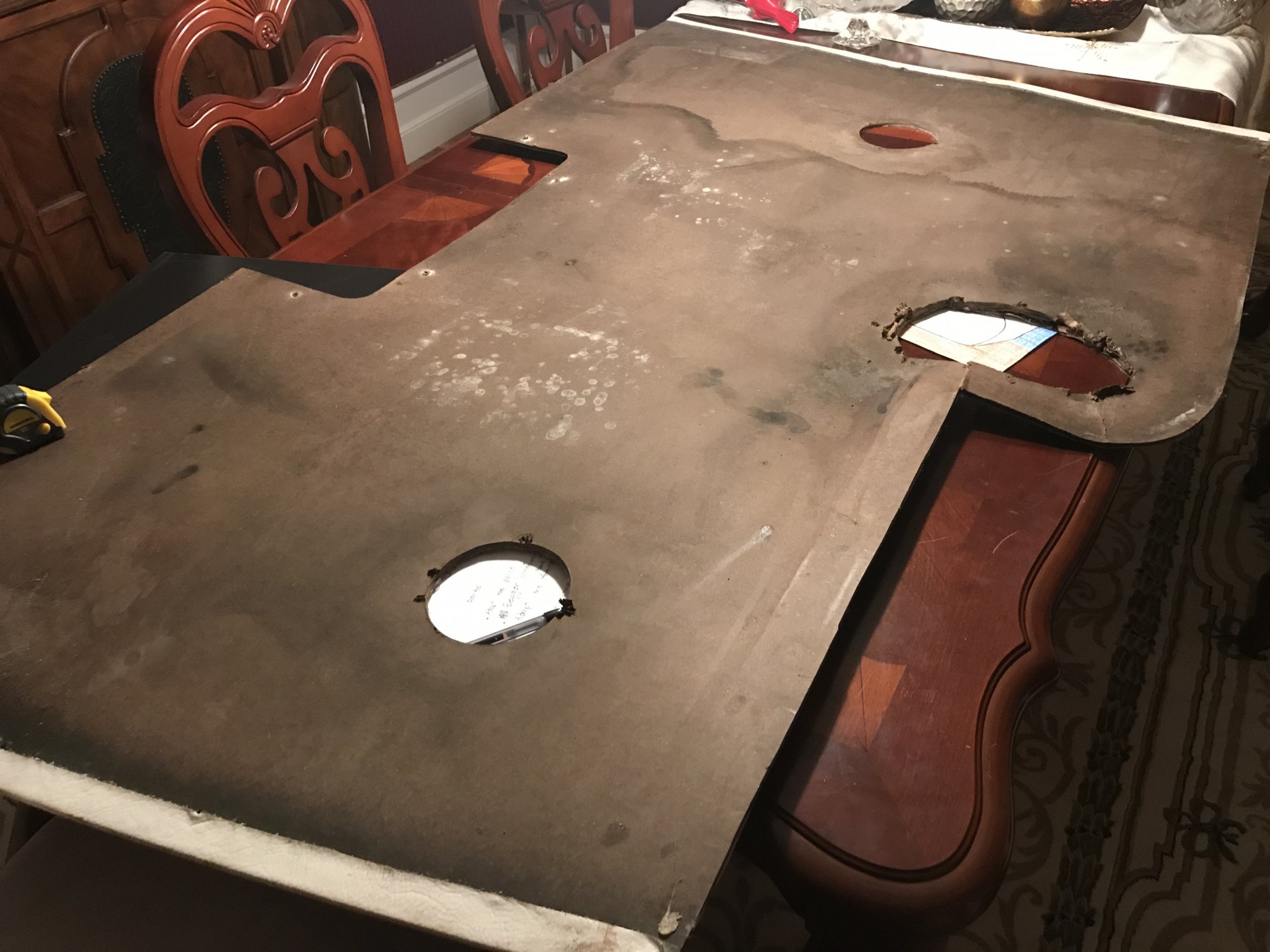

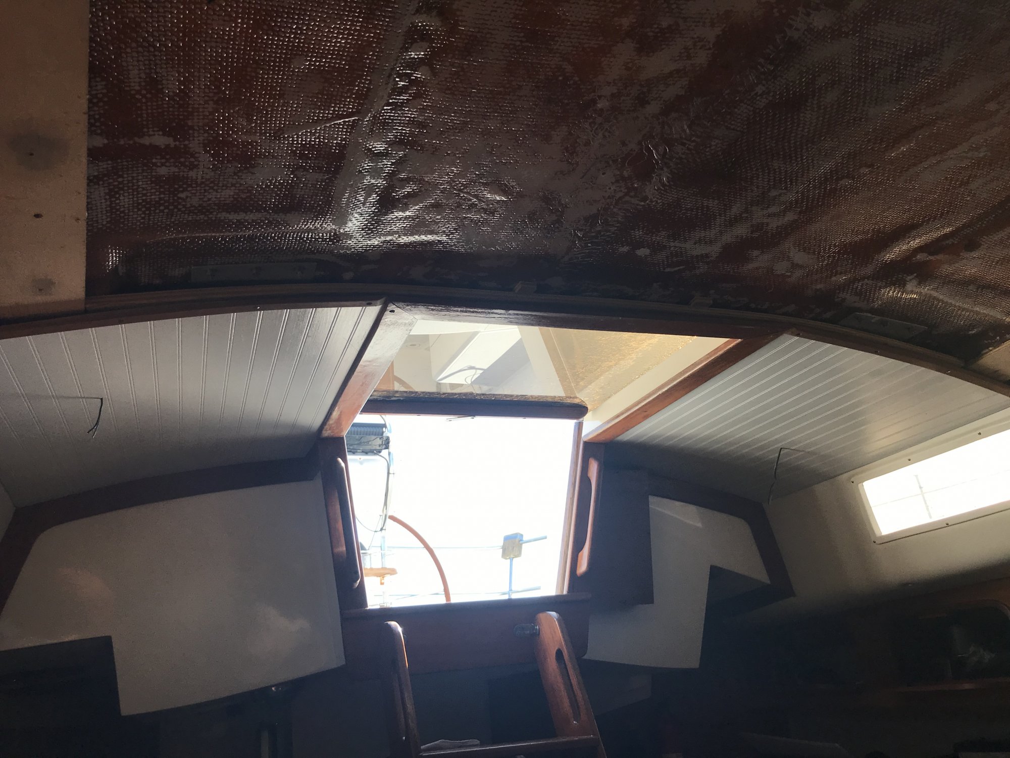

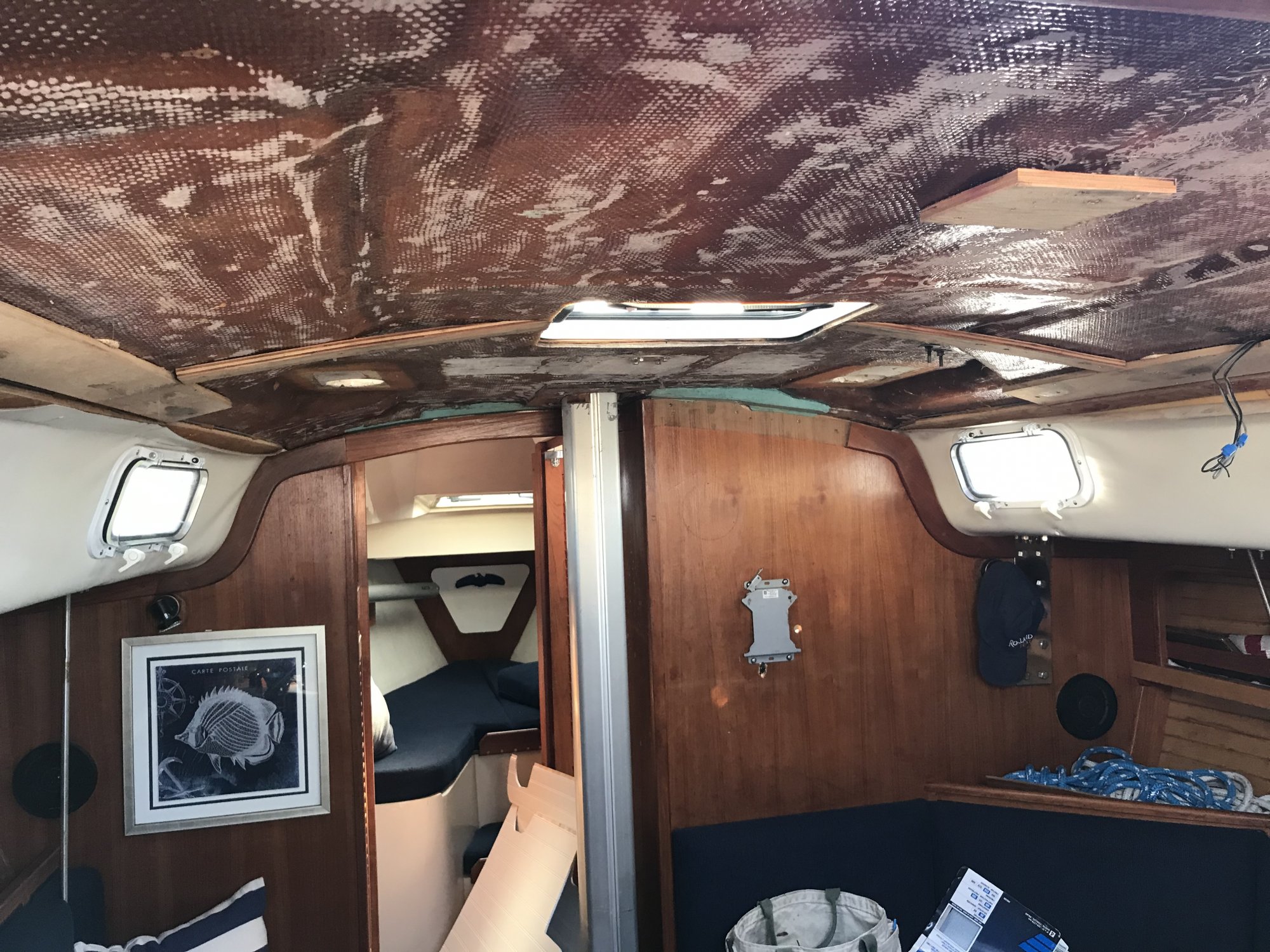

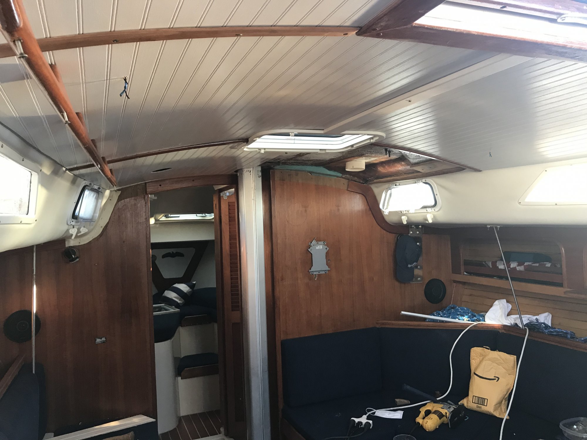

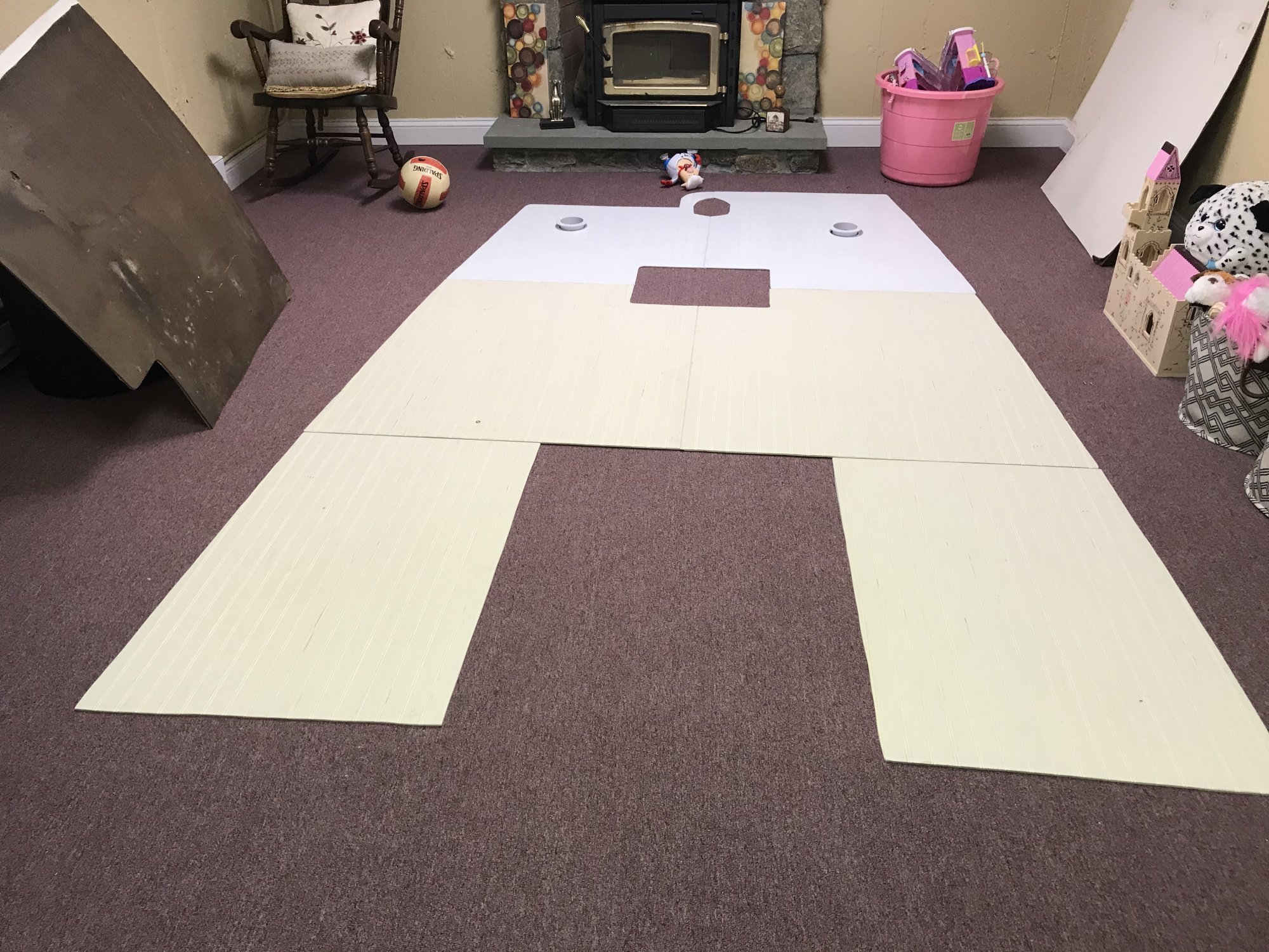

Hi Folks,
Ripped out (Headliner) Ceiling (masonite covered with vinyl) not a bad combo, however, 30 years of wear/tear and occasional drip caused some swell & rot. So I painted some bead board and screwed it up, hopefully not literally. Here's some photos, it was a PITA, templates didn't fit, curves didn't match, found old leak-(needed to rebed clutch), plywood nailers had to be moved, some trim needed trimming, screw heads stripped....ect. Some cutting, sanding, swearing, and chiselling, and after almost every tool in the box was used, here's the almost finish product. I quit for key lime pie with daughter, will finish next week.
Cheers, Bill

Looks good! What type of beadboard did you use (vinyl, MDF, wood)? Did the old liner get torn up during removal resulting in the need to fabricate new templates?
Wood beadboard. Old headliner stayed in relatively good shape, some tears, but overall not bad.

Best things about project, 1) Access to stuff underneath (check bolts, through deck stuff) 2) Easy to upgrade lights 3) Change color/upgrade look. The project took a couple of days, you'll need good templates, jig-saw, and patience. Very doable. My brother's quote "Caulking trim and paint can make a carpenter what he ain't." my thoughts are time & money can solve any boat project. Thanks for checking out my work.

How do you secure the board & stuff to the ceiling? If you put a screw through won't that penetrate the coach roof causing leaks?

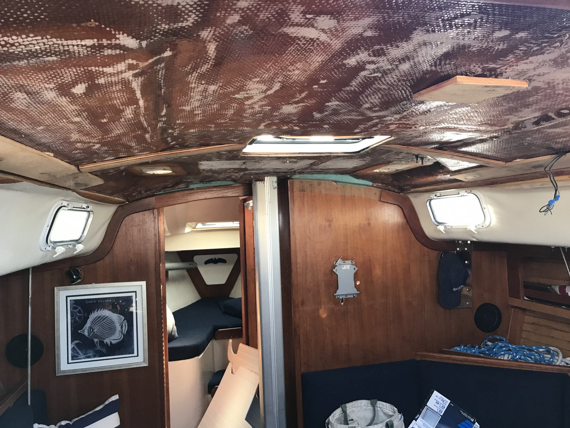

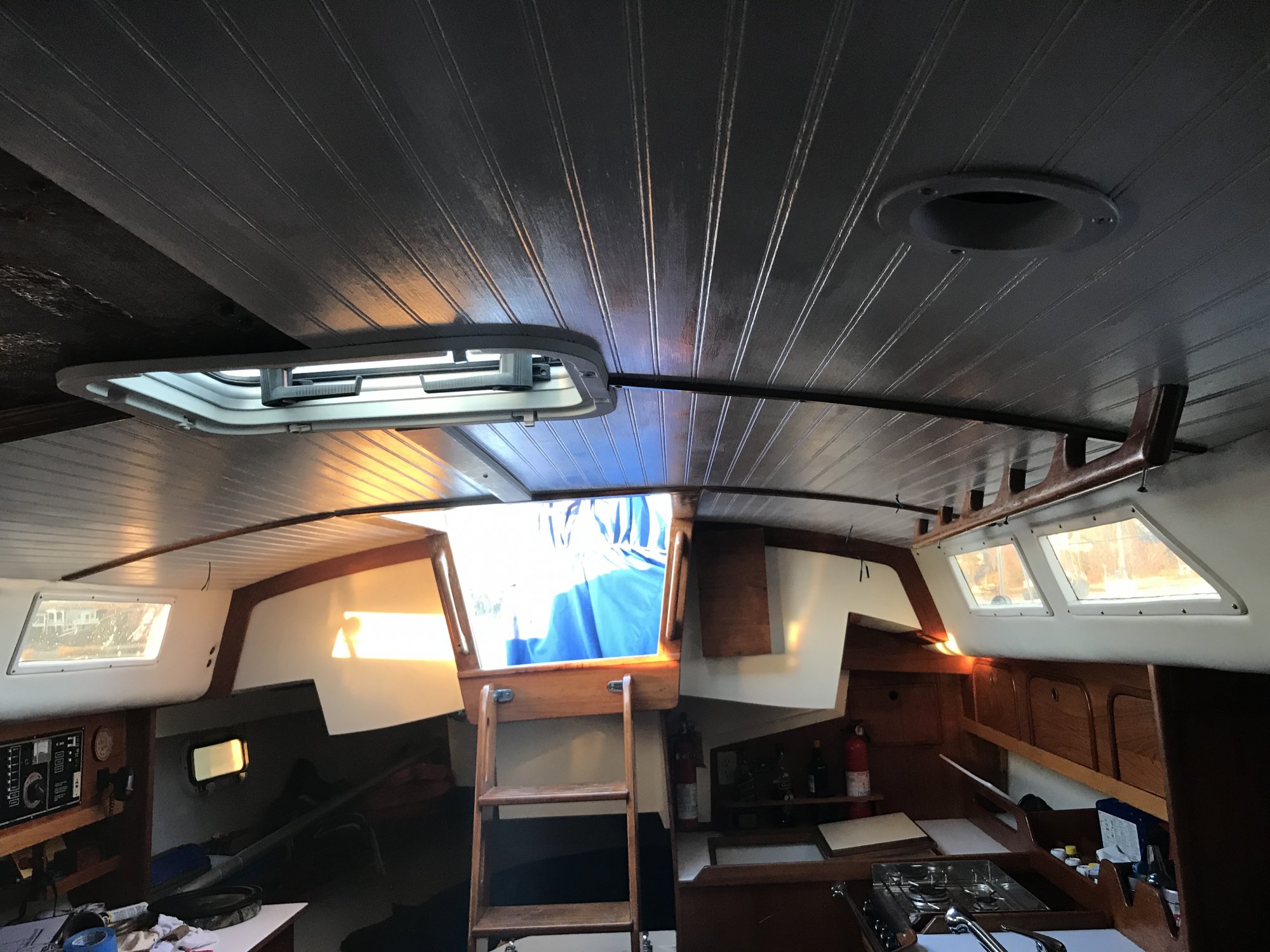

Wood Bead board (a plywood primed on one side from (Carby's lumber yard) was secured by small screws pre-drilled. Some went into fiberglass some to plywood nailers that were already glued/screwed to coach roof. The deck is sandwiched with balsa wood, (two layers of fiberglass, balsa in middle) won't leak because holes don't go all the way through deck. I didn't insulate since I'm coastal cruising/racing May-October. Also the screws and trim pieces make the sections easily removable.
