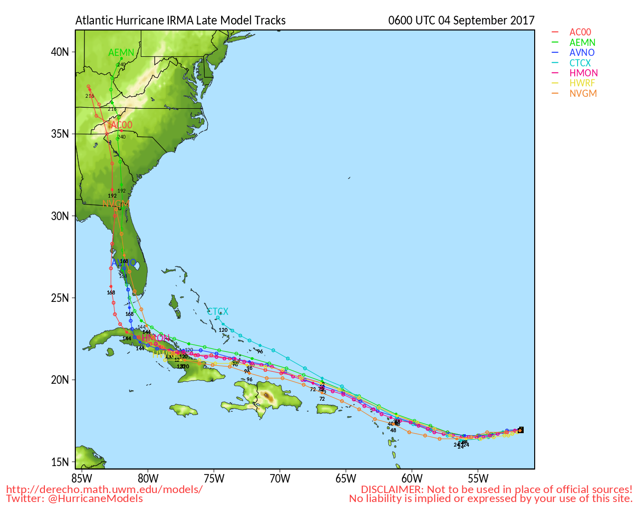

If you are going to head west, you must depart now. Do not delay. Of course, Irma's track could move further west if you move west. It is forecast to be a category 4 hurricane as it moves up the west coast of Florida. Your goal will be to get upriver toward Tennessee before the hurricane arrives. If it finds you while you are in open water, you die. If you choose to stay, find a hole and lots of long lines to tie her up.

Do not stay on the boat during a tropical storm or hurricane. There is nothing you can do on the boat during a storm except be terrified or worse.

Given the current forecast, always subject to change, You want to go as far west as you can in the ensuing days.

I don't know that I would be trying to get to Florida right now. By this time next week, it is likely to look like Houston does now. If you are safe where you are, why head towards a bad situation (irrespective of making the passage)?
