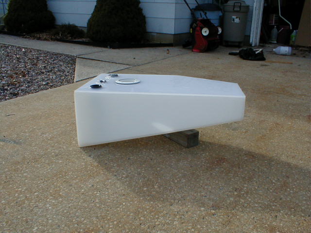

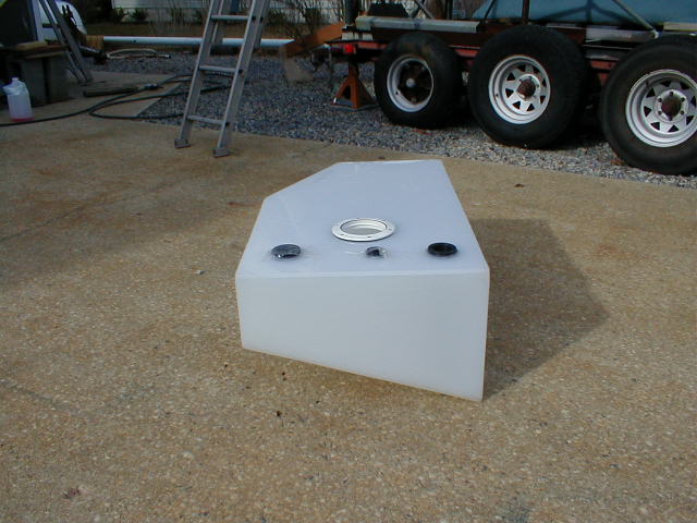

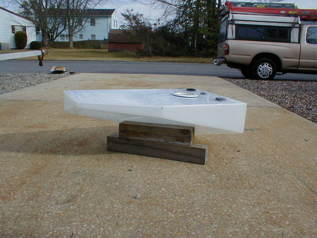

Your best source for a new tank is Ronco Plastics
Ronco Plastics They make top quality tanks for a very reasonable price and have more than 400 shapes and sizes, over 100 of which are non-rectangular...and they install fittings in the sizes and locations specifiedy by the customer when they make the tank. The online store at this site is now a dealer for Ronco Plastics
http://shop.sailboatowners.com/detail.htm?group=1250, and they discount Ronco's already low prices...so find the tank that fits your space in the Ronco catalog, then call Dave to order it. You'll also want to get your hose and fittings from sbo.com In fact, you should just bookmark the plumbing page
