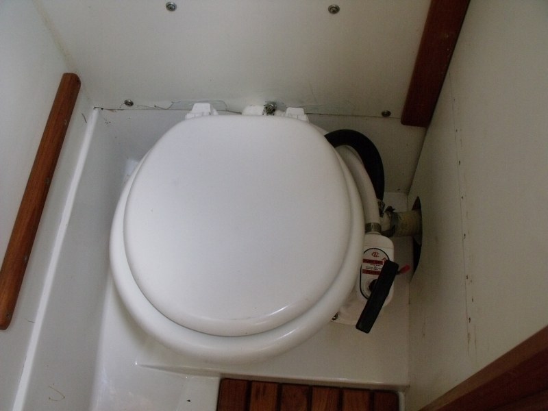

My son called, he was using our boat this evening, and reported that the head won't pump out (reportedly just liquid).
We have n 88 Hunter 28.5 with a manual pump on the head. The head is a SeaLander Model 752.
I'll have to go up there (about 50 minutes) and take a look at it.
Can anyone give me a hint as to what I need to look for?
How do I get it to pump out without making a mess?
At this point, that's my biggest concern!!!
I remember that I took it apart when we first got the boat 3 years ago, but it has worked fine, but I'm guessing that the pump may have to be rebuilt.
Anyone suggest what I should take along for special tools?
Mike

Wet vacuum to dry it out. Other than that, might as well have a rebuild kit with you when ya go.

Just to follow up, I was able to use the pump to pump out the water in the bowl, it pushed very hard, but worked slowly. I used the shop vac to get the rest out.
Turned out that the original toilet had been replaced with a Wilcox Crittenden Head-Mate.
I removed the hoses and took the pump apart. I couldn’t find any obvious bad parts. I re-assembled the pump and it works - kinda, at least enough to get me through until I can get replacement parts next week.
The 4th of July is coming next week! Great day for sailing and having a brew! The toilet has to be working...
I was able to find a rebuild kit for $75 which seems quite reasonable considering that kits for the other toilets I looked at were well over $100.
