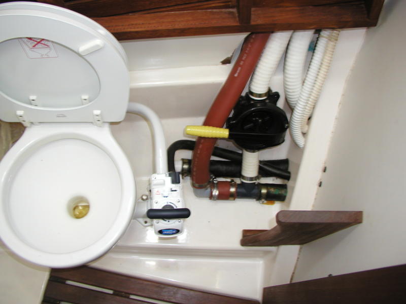

The original H-34 plumbing : Waste left toilet and directly into top fitting on tank. Outlet fitting went to a tee where horizontal continued to deck pump-out.. (red hose in picture if I can get one o post today). Other leg of tee goes through Gusher hand pump, up inside cabinet to a vented loop just under the deck. Other side of loop goes down, aft through the bulkhead stringer and loops over the tank top as yours does, before going out through the valve. I left mine original because it works for me..

Agreed, that is the current setup. With the addition of two Y valves and a gusher pump one would have the ability to empty the tank without having to go in for a pumpout when cruising.

kloudie1, many thanks for the explanation and picture. That is not the way I found mine. From toilet to Y valve which directed to top of tank or vented loop that went overboard. This is the part I couldn't understand - how was the toilet pump supposed to push that volume up and over the vented loop. I don't have the extra holes in the liner for all the pipes in your picture so I have to wonder if we have different plumbing. Mine is '83 hull#68
Jun 23, 2015
117
Hunter H34 Deltaville
kloudie1, thanks for the link, I like the low profile of that one. I also like the setup in your picture. As I see it your setup requires everything to go into the tank then either pumped out or manual pump overboard. This requires a decent seal on the deck fitting as well I presume. I'll wait to get Peggy's book to see if there are any other piping suggestions before I decide what to put back.
