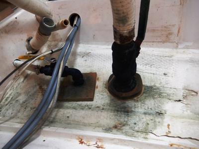

Tracking down the stink in my new (to me) H34 I found a PO attempted to repair the top connection to the holding tank with a few screws, apparently a long time ago as there is significant rot in the floor and bottom of seat. The two seacocks for the head are black and the discharge is frozen in the open position.
I'm new to all of this on a boat but not to plumbing so I have two large pipe wrenches but they don't fit due to the curvature of the hull. I am very leery of putting side pressure on the hull to break the joint. I have experience with radiator "spud" wrenches that are similar to steep wrench that go inside of the fitting but from my experience this will require way too much force on the small nipples inside and will probably break them off.
Unless someone has an alternative my plan is to use a sawzall to cut the valve & ell off then cut the retaining nut off the thru hull fittings and replace both. I have looked at several threads about replacing with true thru hull fittings but none have addressed this situation.
I assume the blacking of the fittings is from the leaking tank.

the blueishness looks like corrosion from hydrogen sulphide (i think thats what its called) its from decomposting organic material primarily blackwater. an angle grinder may cut with less vibration. that fitting is not going to be fun to get off.

I wouldn't try to repair any of that...it'll cost you more than replacing it all.
I'm guessing the rectangular "plate" under one of the fittings is wood. Whatever the plastic "sheet" is, it's seriously cracked But the fittings are obviously metal--which should never be used in a marine sanitation system. I don't see anything in your photo that looks like a holding tank, but based on what I can see and what you've said about PO repair attempts, it's not likely to be salvageable either....(and btw..."rot in the bottom of WHAT seat?") I'm betting, that the toilet is also too old and neglected to be salvageable. Get rid of all of it! The simplest solution to removing those fittings might be to cut out the fiberglass around 'em, glass over the holes (yards do it all the time)...and install new ones in a better location.
You said you know a lot about plumbing... Fwiw, except for "water runs downhill" in boats and buildings, there's very little if anything that applies to plumbing on land that'll work on a boat...'cuz systems on a boat don't work the same way. Trying to apply the same principles ends up just causes problems.
If you'd like some help spec'ing out a system that will work, you're welcome to shoot an email.

i doubt those fittings are metal, for starters ball valves only come in bronze or stainless steel. my bet would be bronze because as i said hydrogen sulfide will eat away at bronze, stainless steel aswell but mostly staining.
i would check the holding tank vent and make sure it leaves the boat the thru hull for this should be plastic no metal/bronze/ss fittins on the vent line from the black water tank
i personally would not relocate those thru hulls, they seem fine to me. i would replace them though. relocating them is a huge job.

Peggy I didn't want to start out with what I found when I removed the top (forward stard, seat H34) but since you brought it up. A bio hazard if ever there was one. It gets worse....
This in no recent leak. You can't see it but the pipes and wires run into the hull liner through a hole in the floor. Right under the leak!
You can see the saturation of the flooring and rot of the seat box bottom.
Those are two pieces of plywood backing the thruhulls. The cracking noticeable to the right of the larger one is the liner that is, or was, attached to the hull. That will be my next thread, where the "tabs??" have cracked. The hull shows no signs of stress outside. I had it hauled because this valve is frozen and even now the handle bends before moving.
I've heard this before "houses and boats are totally different trades", I'll say, now that the boats systems & frame is exposed I see work that I don't even know if it's "acceptable" but I'll tell you that if I or anyone did that on my job they wouldn't make it to coffee break.
I have the floor up and the parts under the holding tank have de-laminated and the one nearest the leak broke when I moved it.
