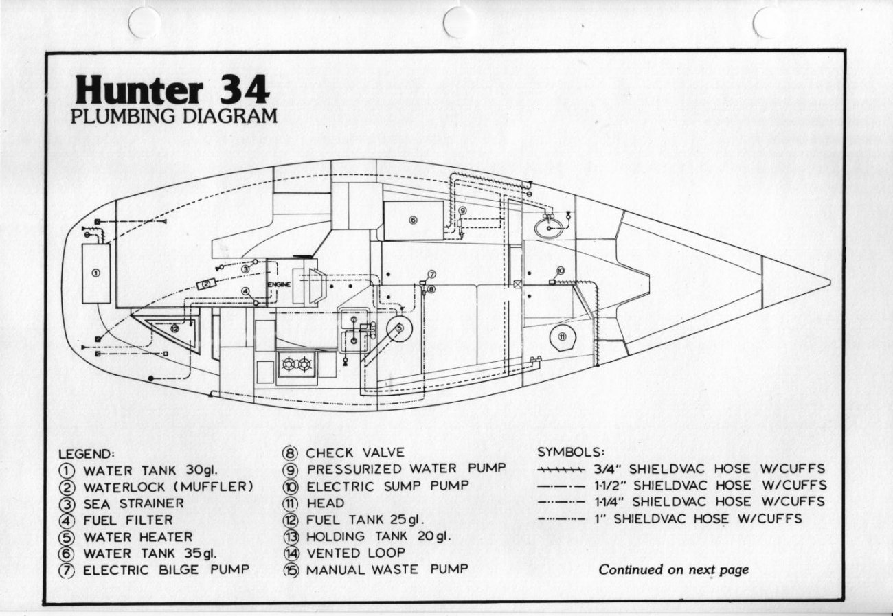

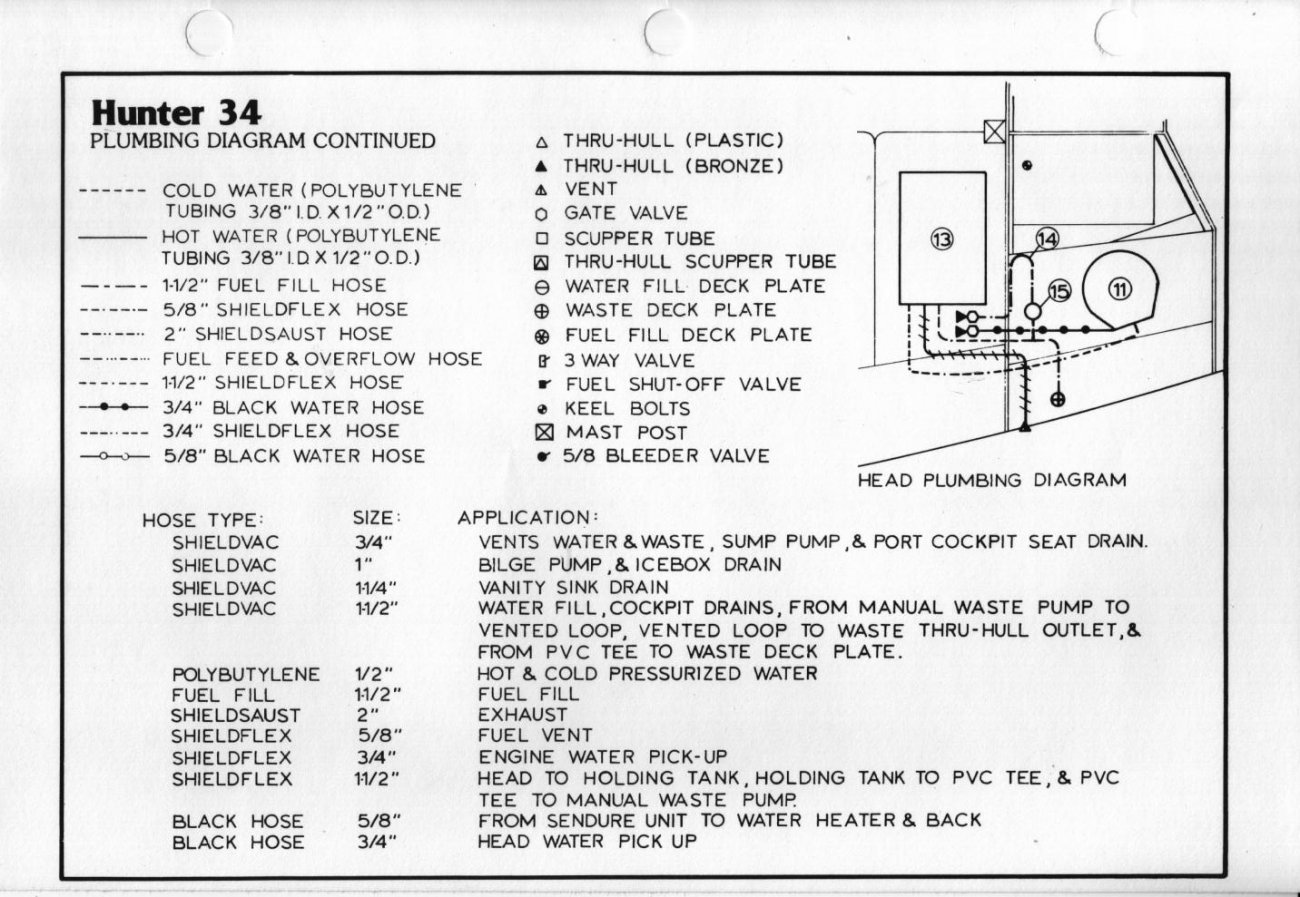

Gents, FYI according to the specs, the holding tank under the dinesse settee is listed at 20 gals. Sailing singlehanded most of the time and not using it for urine extends the time between pump-outs considerably.
