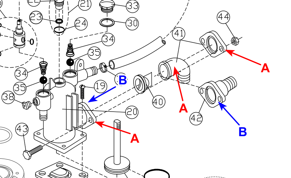

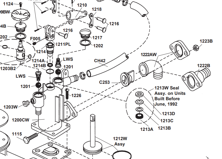

@FastOlson , after a little closer look at your closeup in post 14, could this be what's causing your leakage problem ? ? ? ?
Below is an exploded view of this area. Notice the differerent arrangement of parts between the straight (blue text) and 90 fitting (red text) on the outlet flange of the pump. Your extra thick piece is not shown in this drawing This is for my PH Superflush.
The next exploded view below is your Raritan PHll Small Bowl Toilet in a view of the same area. Identical except for new part numbers. Again your extra part is not shown.

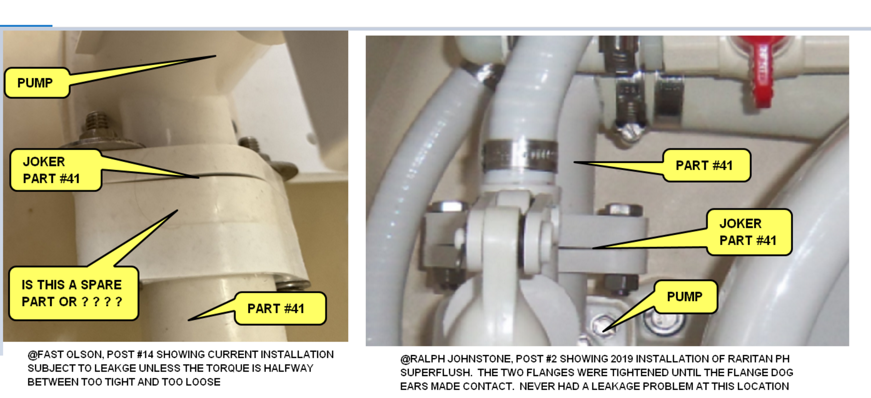

Your extra "mystery part" is most likely the cause of your leakage.
Apr 8, 2010
2,199
That "extra part" is left over from a prior PH2 installation. That extra thickness just enables that side of joint to remain Un-warped.
The remaining difficulty is the molded on flange on the pump side and that's the one that warps and then can sometimes leak.
Worth noting that there is indeed a point where the two flanges are torqued enough to seal (flat), but not enough to leak. The problem I have noted is that with any increase in pumping pressure against the discharge it's possible to force some water out around the joker molded-in rubber flange.
What with the length of handle it's possible to really put some pressure on the whole "downstream" system. While I can easily sense when pumping the handle is getting too difficult, guests often have no idea how much handle pressure is too much. :yikes:
...... and so it goes..... :)
