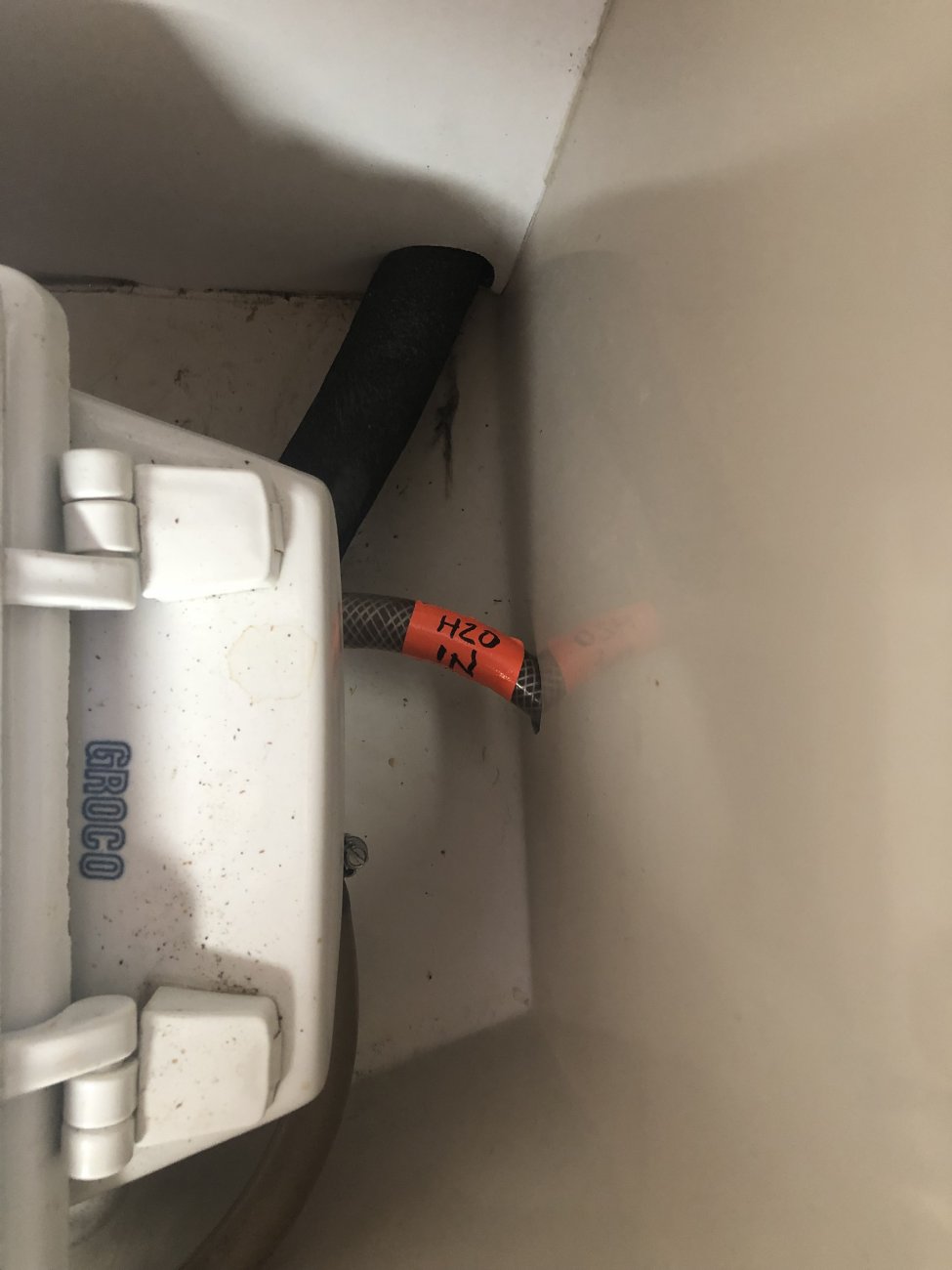

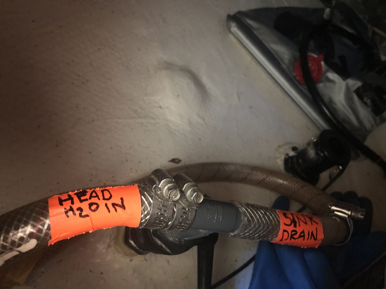

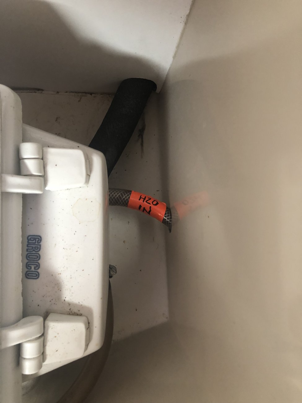

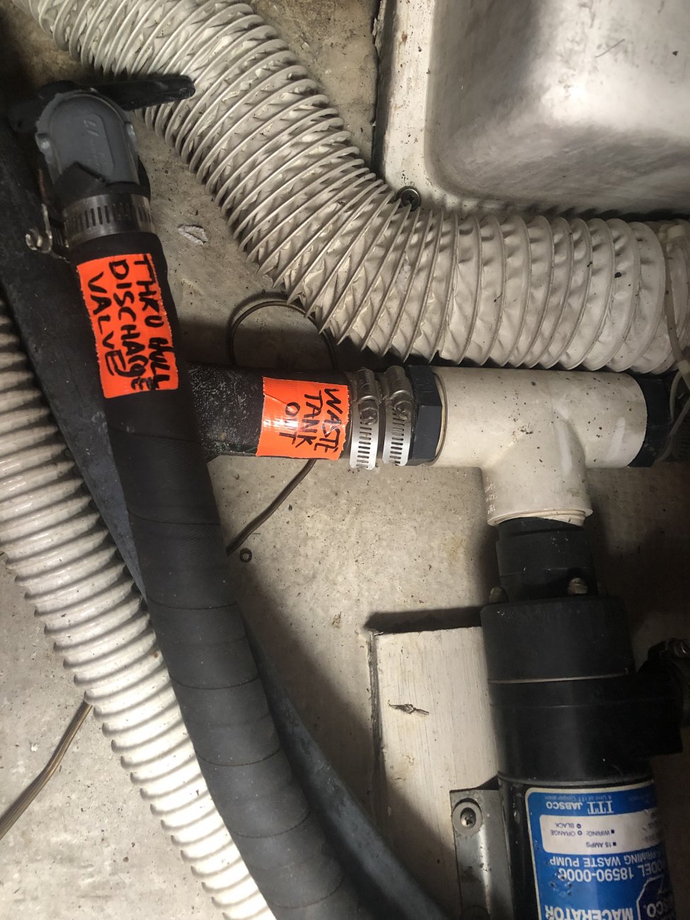

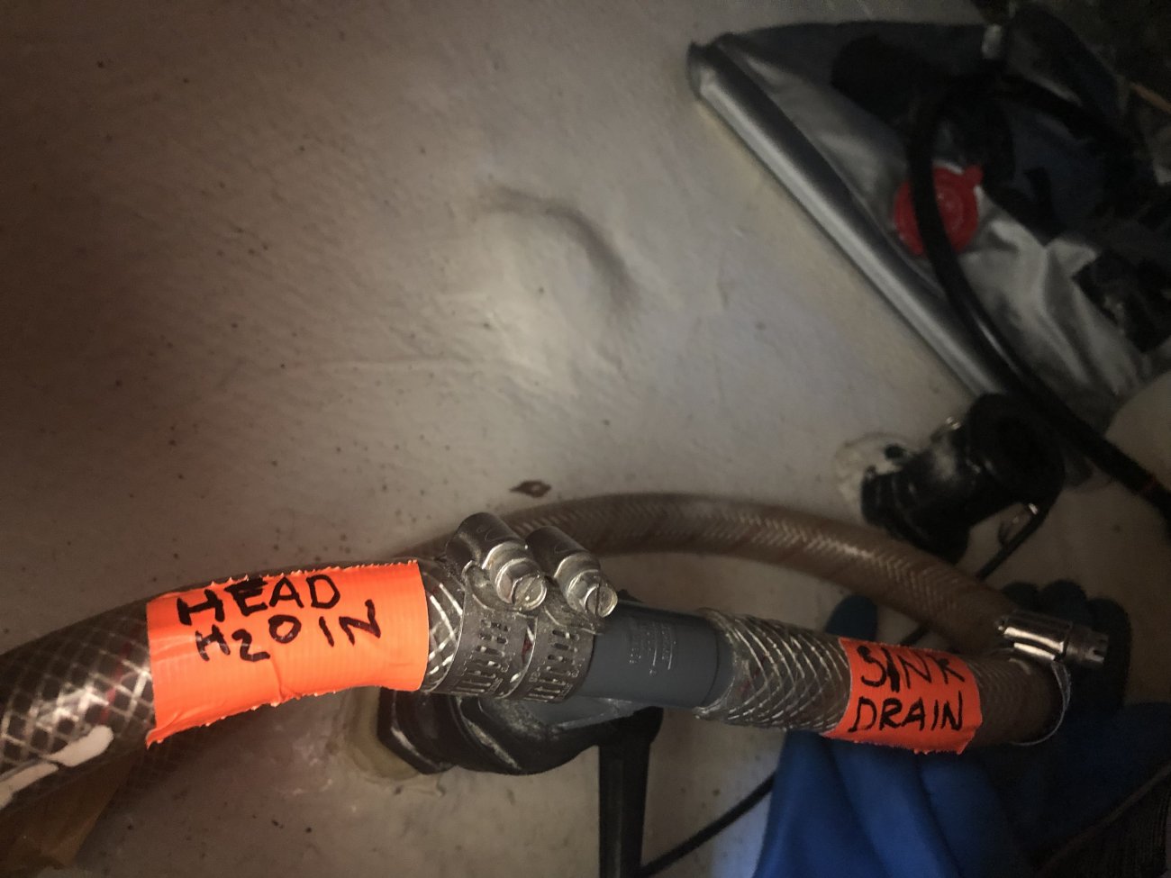

So I’m looking into vmcahanjnf our some toilet parts but first wanted to show u a few photos of my head setup to see if you had any other recommendations. I found my 1 page groco Manual and the first thing it said was DO NOT hook up any other lines to the water inflow besides the toilet. I noticed whoever previously installed also hooked up the sink drain tube to it as well. They also didn’t put a loop vent in the discharge line to the waste tank as you recommended. Another question I had is at the y valve with macerator...since I don’t pump out at all should I always leave that discharge valve closed and furthermore should I just remove the y valve and macerator completely and just have the discharge line go straight to the pump out? If it’s not effecting anything I’d prefer to leave it. But if can help overall performance I do not have any intention of the boat ever leaving the lake...see attached pics of my current setup, I look forward to any thoughts before taking on this project:)

Forgot to mention in the 1st picture u will see another thru Hull next to the water intake thru Hull with nothing attached. It has a black wire going into it as well that goes all the way back toward the cockpit. What is this for?
That's ok..in fact it's very good 'cuz it provides a safe source of clean fresh water to rinse the sea water out of the whole toilet system--inlet line, pump channel in the rim of the bowl AND the toilet discharge line. However, I have NO idea why he just added a line to the sink drain instead of just re-routing the intake hose from the thru-hull to the sink drain line, teed into it below the waterline as close to the seacock as possible. That leaves you with a thru-hull you can use for a washdown pump or something else that needs water. I need a to see a photo of the back of your toilet...'cuz it looks like he ran the intake line directly to the bowl instead of to the pump where it should have gone.
It's the INTAKE line that needs the vented loop. It's not needed in the discharge line if you're only flushing to the tank, only if the toilet flushes overboard.
Remove y-valve and the macerator. You no longer have any use for the y-valve. And when electrical equipment sits for more than a year, it starts to deteriorate...within a couple of years it becomes toast. Besides, removing 'em will definitely simplify the plumbing.
I'll be glad to help you sort out all the details one-on-one if you'd like to send me a PM.
