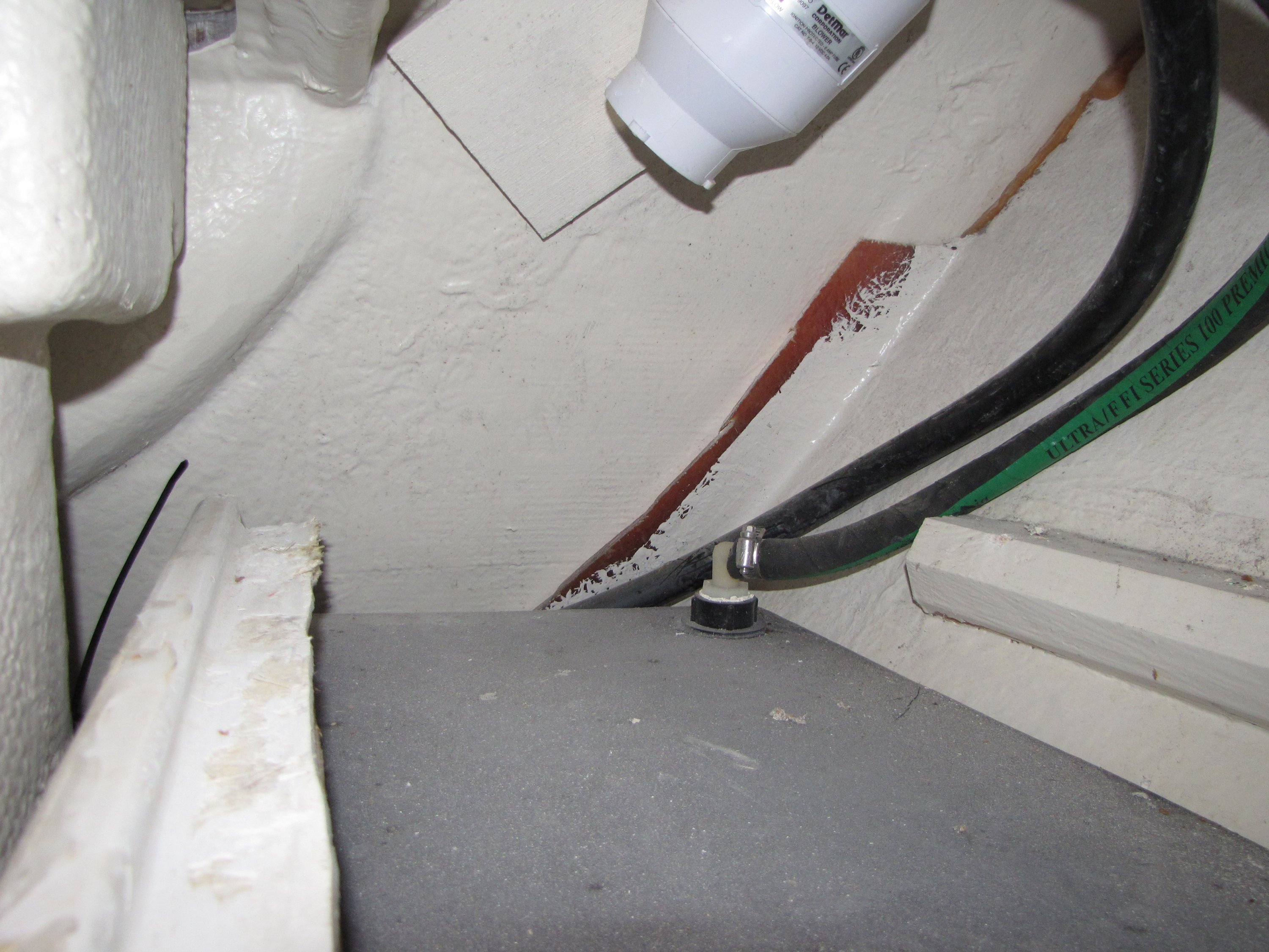

I used to unlock the twist and lock so that if the pump sucks really well and the vent has trouble keeping up, the head would hiss. Why? 'cause as Peggie says, if you've got a plugged vent it's a problem. My boat has the craptastic vent-in-the stantion thing. So it's essentially a 3/8 inch hole.

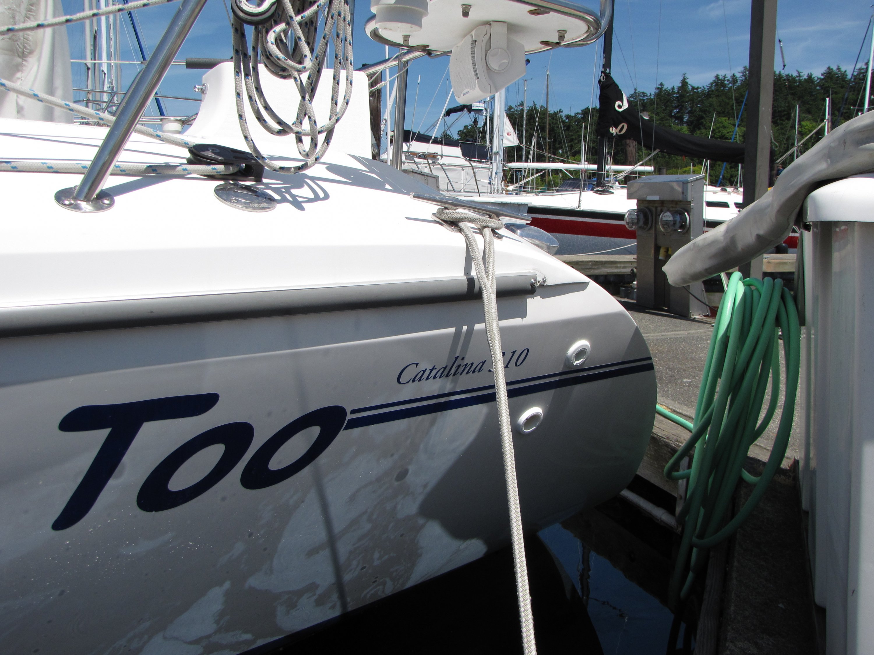

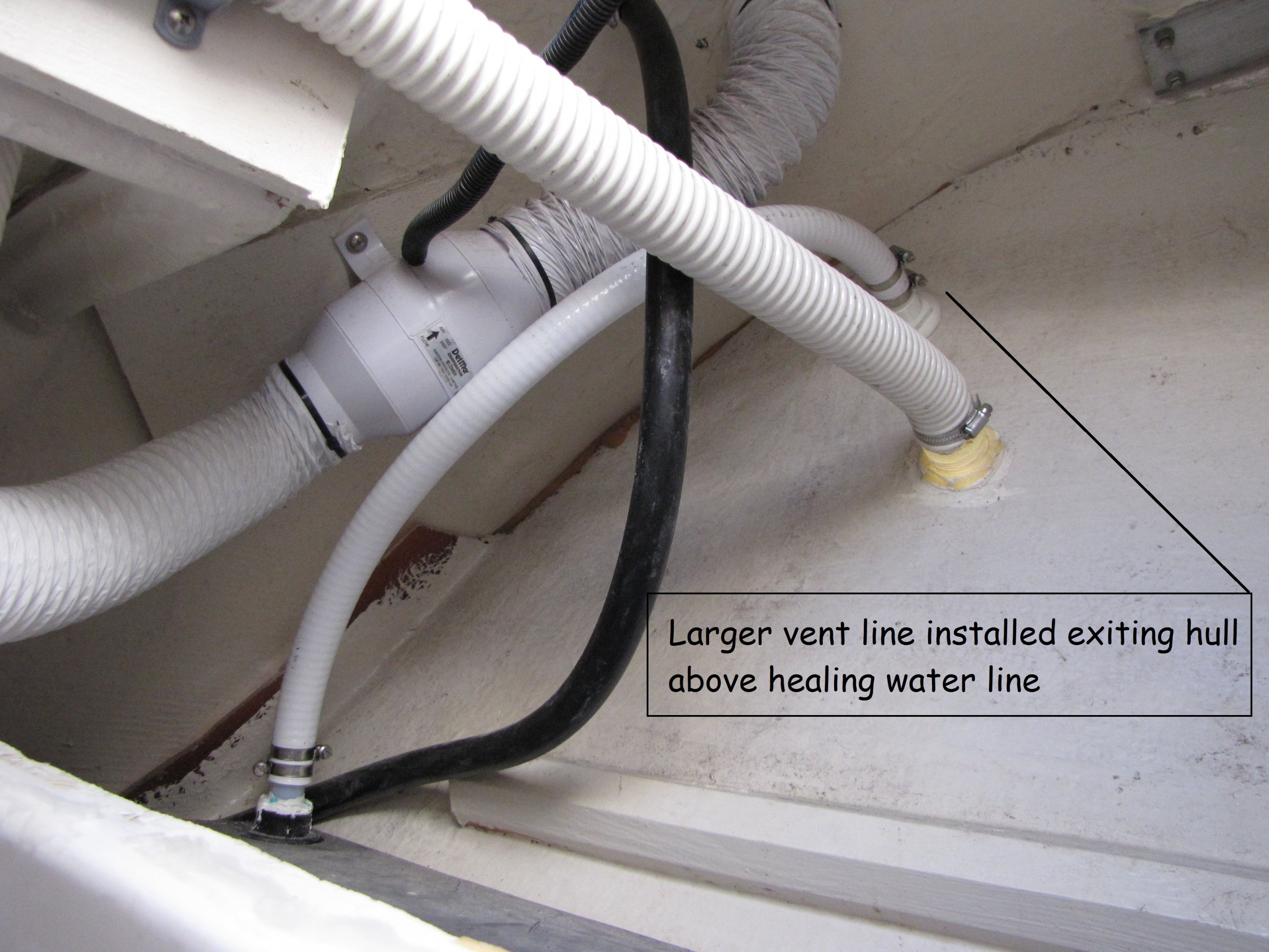

How hard would it be to install a thru-hull next that rail stanchion right below the toe rail and reroute the vent line to it? If you use an open bulkhead thru-hull instead of a "vent" thru-hull, you can even keep the vent line open almost effortlessly by just sticking a hose nozzle up against it and backflushing it every time you wash the boat. And, you'll have less odor if the tank can get some air.

Nice job, Paul. Why did whoever installed the original vent line use a 90 degree fitting on a line that they had to know would run straight up??? Although boat builders are the worst sanitation system plumbers on the planet, I don't think yours was a factory installation...'cuz your tank is white. Catalina has used black Ronco waste tanks (haven't noticed what color the water tanks are) for decades.

Peggy, I'm pretty sure Paul's tank is black. Like ours, it's got what looks like white paint overspray on it. Ours (hull #31) also has the elbow fitting, but installing a larger vent like Paul did is on my to-do list. Luckily our head usage is fairly light, with a fresh water flush, and has only been #1, so a small vent hasn't been an issue, yet!
