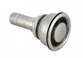

The two most common locations for a vent blockage are the vent thru-hull and the other end of the vent line--that end of the hose and the vent fitting on the tank. Start by cleaning out the thru-hull...use a screwdriver blade, ice pick--whatever works. If that doesn't result in a spew out the vent, you'll need to relieve the pressure before removing the vent line from the tank to clean them out...so open the deck pumpout fitting VERY CAREFULLY with a hose at the ready. Be sure you're UPwind of it! Scrape out that end of the vent line and the vent fitting on the tank...replace the vent line.
